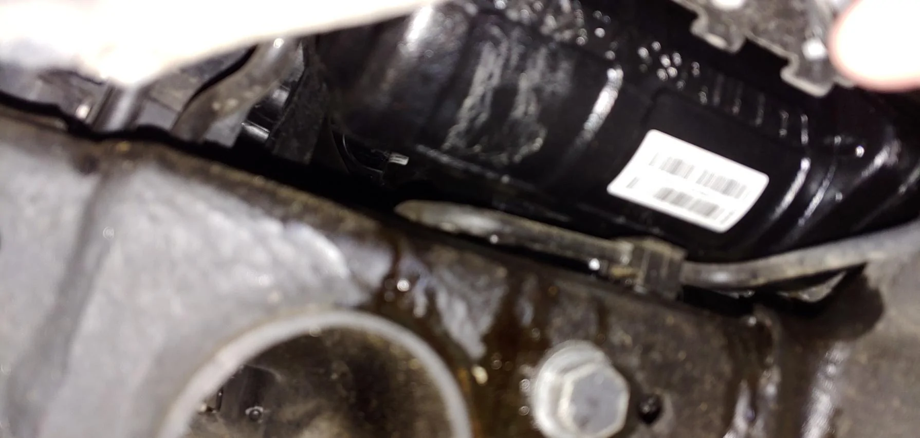

DO NOT try to band-aid it. GET IT FIXED. What happens when warranty runs out and you still have the old steering gear and have issues? It's on your dime, then. Get it fixed, no band-aids actually fix this, some MAY, and that is a MAY, mask it, but that's it. Nothing fixes it except the new steering gear.
IF it's a July build it has the aluminum goofy steering gear.
2021 model year and it seems some mid to late August build 2020s have the new gear but it's EASY to tell.
Go to page 1 of this thread, download and PRINT the TSB.
The PART NUMBERS are on it.
As already stated hjdca, the faulty gear is aluminum - a gray to silver/gray color. The good one is BLACK, cast steel and you will see a sticker with the PART NUMBER on it.
I'd bet a Big Mac yours has the old bad gear.
What angle of the car do you look into to see it? I never looked to see my new one or the old one for that matter. Do you need to fold back the wheel liner at all?
Left wheel opening, ahead of the center of the axle, above the frame, you can pull back the plastic liner - it's really thin, and can see it there.
