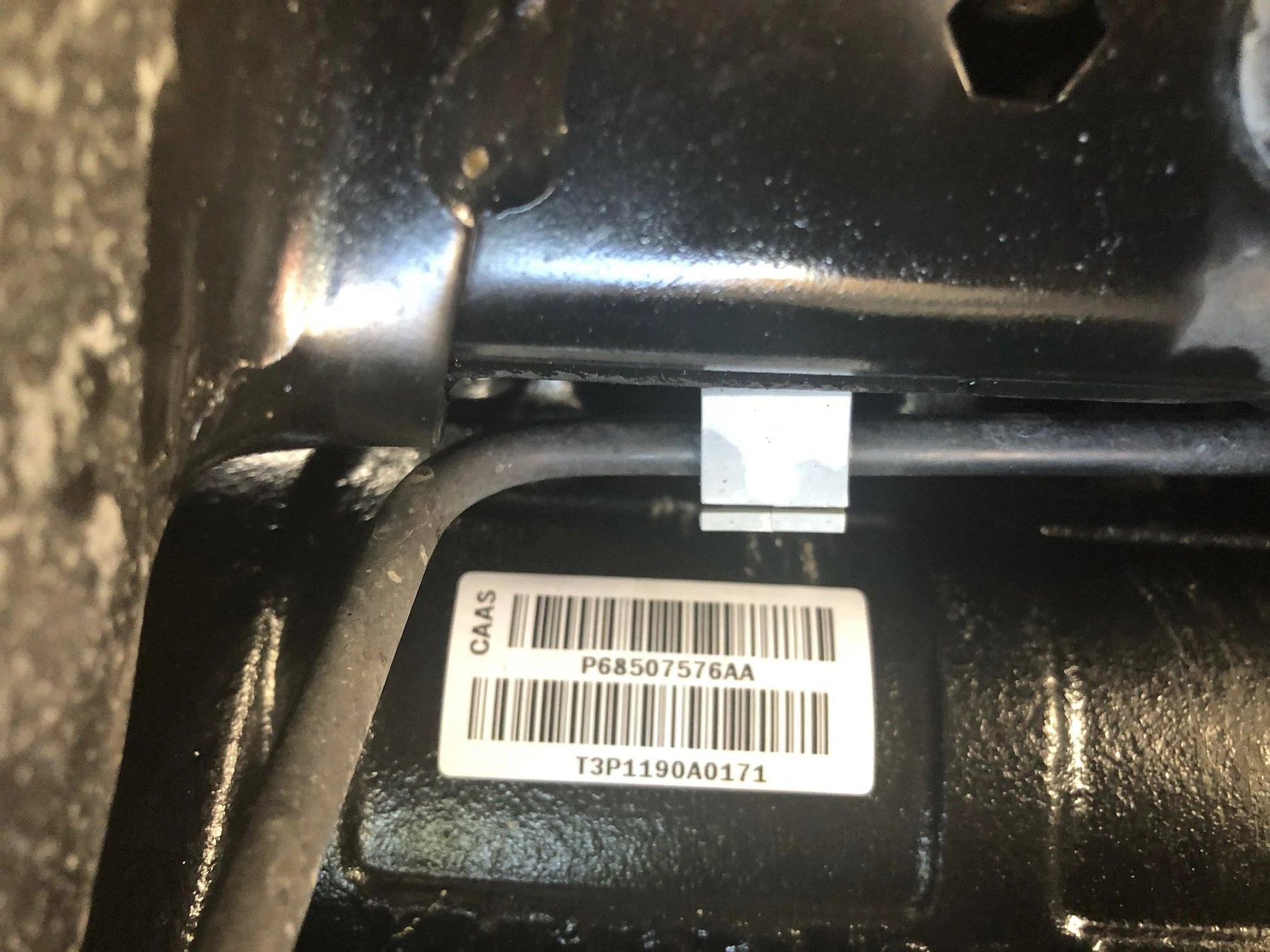

Yes. In your drivers side wheel well, lift up on the inner liner at the frame. That’s where the p/n s/n sticker is.

How do you know if you have a 5SY sales code?
