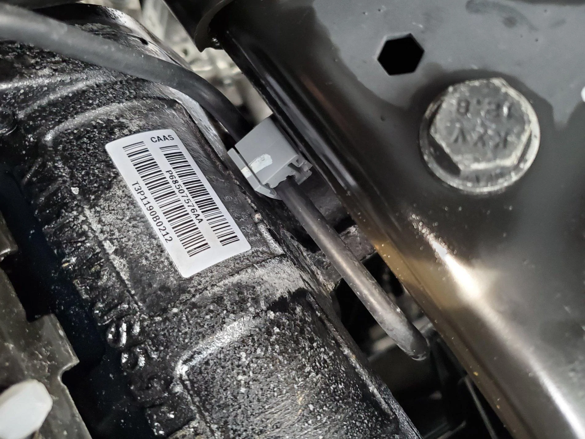

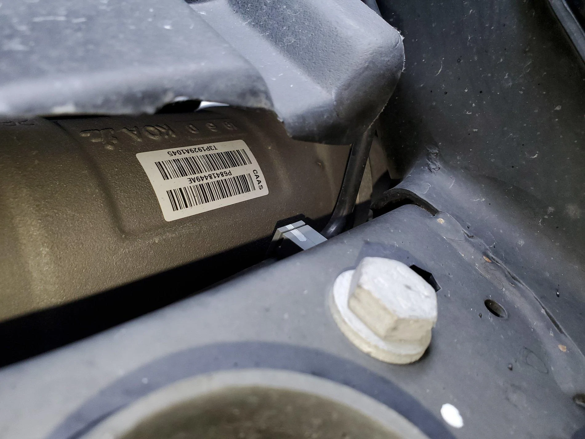

My update:
I 1st reported 8-19-2020 that I spoke to my local dealer about the TSB.
1 month has now past since I waited 2 weeks to order the parts, then another 2 weeks to get scheduled in for an appointment for install.
I dropped of my JTR Tuesday Sept 22 for a 7:30 AM appointment.
My SA called me this morning Wednesday Sept. 23 that the Jeep is finished and that I can pick it up anytime.
He stated the tech did not finish it until late yesterday and he had to do an alignment on it before he could give it back to me.
When I arrived I checked the steering gear and fluid levels just be sure they were changed
They were!
But: There were ZERO additional miles driven on the Jeep since when I dropped it of which raised the red flag for me.
Ok....so now off for the test drive....The steering felt better right from the start and was definitely improved....But the steering wheel alignment was way off center.... the top of the steering wheel had to be turned at 2 O'Clock to go straight down the road....so obviously the tech did not test drive my Jeep or check over his work...Not good!
Of course I went right back to the dealer and had a friendly discussion with my SA about this issue he immediately took my Jeep back in to the service bay and had the tech center the steering wheel and check the toe in on the alignment....
In the end everything turned out really well and I feel the Jeep is better than new in the steering department
I am glad I have been following this thread and learned of this TSB here on this forum...
Thank you to all the members who have contributed and hopefully everyone that has an issue with their steering can have a good positive outcome
I know that others have attached pics of the old style and the new box
But here are my pics maybe they will be of help to one of our members
Top pic is of the old style aluminum steering gear
Bottom pic is of the new style black metal gear box
Jeep Gladiator New JT Gladiator Steering Issue TSB 08-074-20 (for "Improved Steering Feel") 20200902_115922
Jeep Gladiator New JT Gladiator Steering Issue TSB 08-074-20 (for "Improved Steering Feel") 20200923_165738
