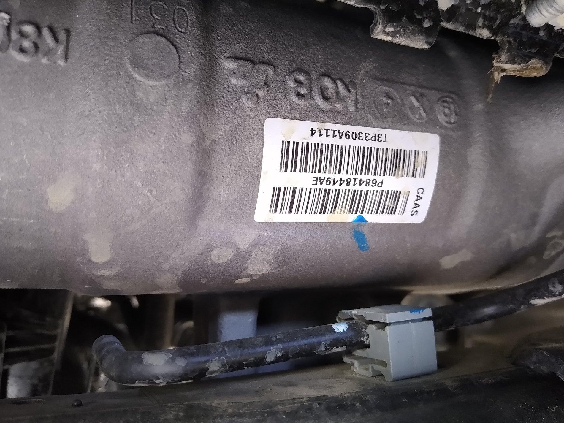

I checked mine out last night, and sure enough, it's the dreaded aluminum one. Explains why I've been feeling like it should track better than it does. Off to the dealership I go...
