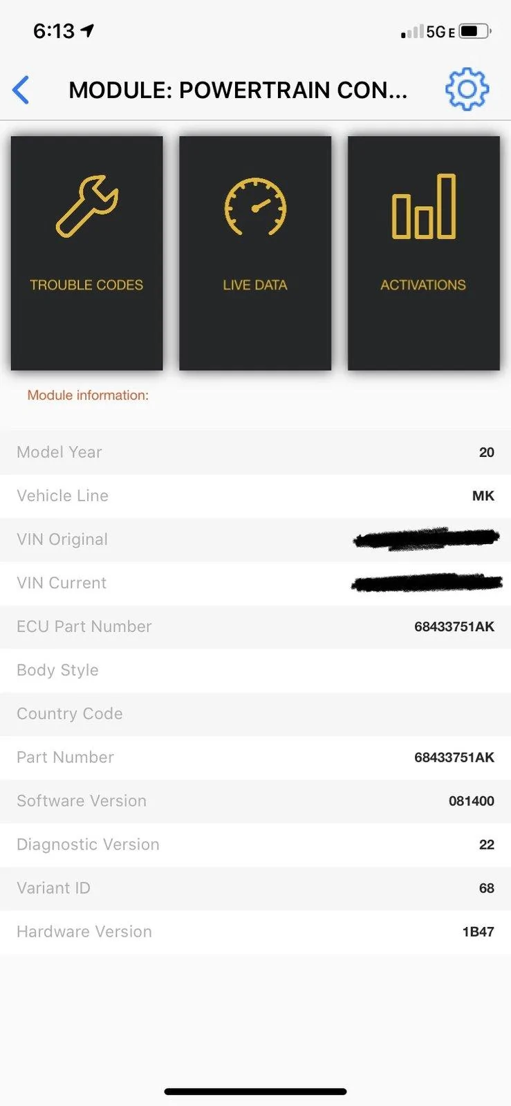

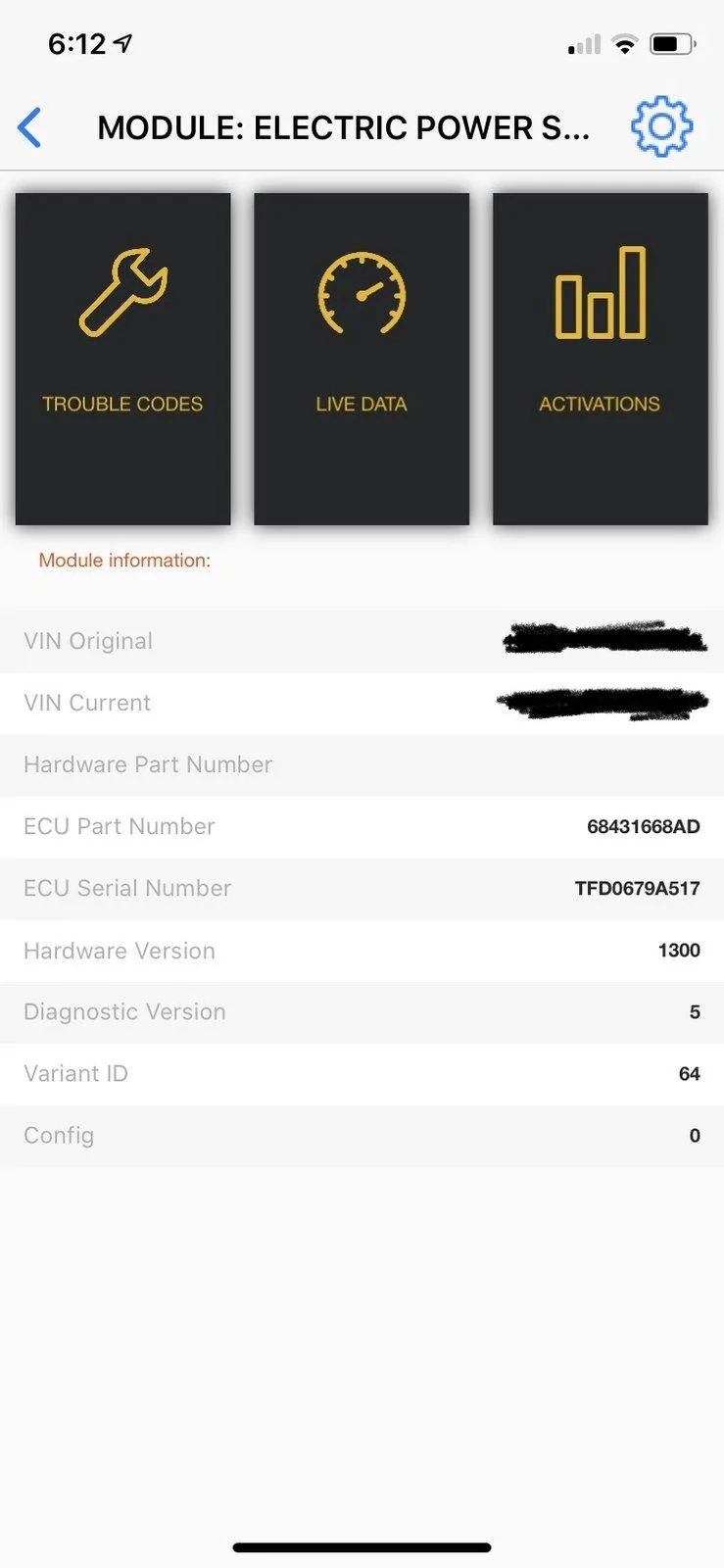

I was making some changes in JScan and I thought it might be interesting to compare hardware and software versions for the EPS and PCM for those of us who have gotten the TSB. Following is what I show:
Electronic Power Steering:
Jeep Gladiator New JT Gladiator Steering Issue TSB 08-074-20 (for "Improved Steering Feel") 70CF9135-E7FF-43E4-86CE-6955AA83B2EF
Powertrain Control Module:
Jeep Gladiator New JT Gladiator Steering Issue TSB 08-074-20 (for "Improved Steering Feel") 0E3DEAAE-FA68-49B1-9487-FCEC453146AE
Iā€™d be curious to see what others show, if anyone else feels like sharing
