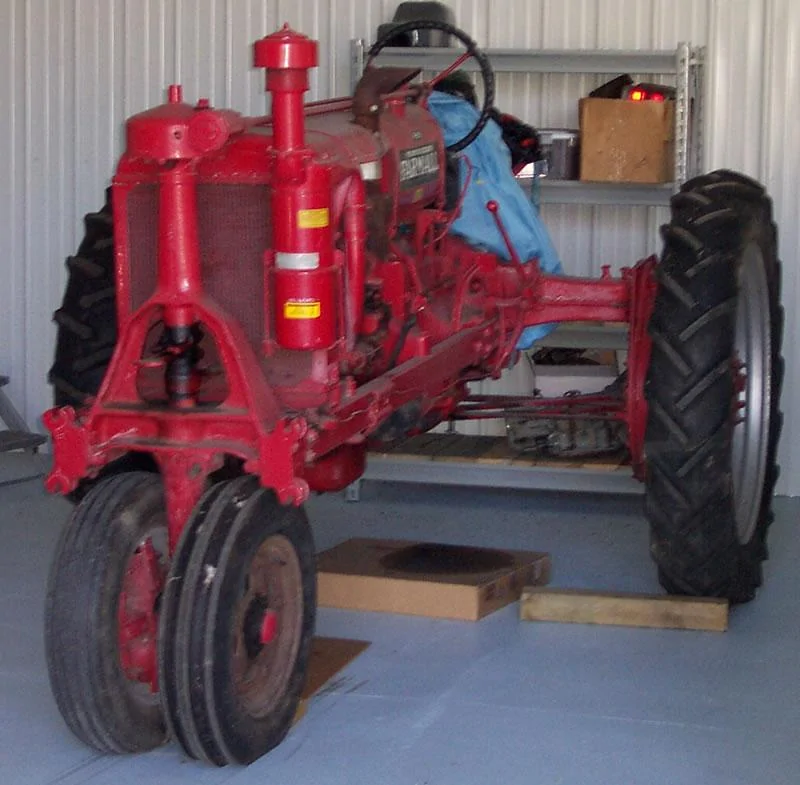

Real old school - manual unlocking hubs (oem hubs were locked) - 1946 Willys CJ 2A
Jim_n_Tx
Jim
May 31, 2019
121
191
Texas Gulf Coast
2006 Rubicon, 1946 CJ2A, 1968 Jeepster Commando, M422 Mighty Mite and 2020 Gladiator Bright White
Oops forgot pic

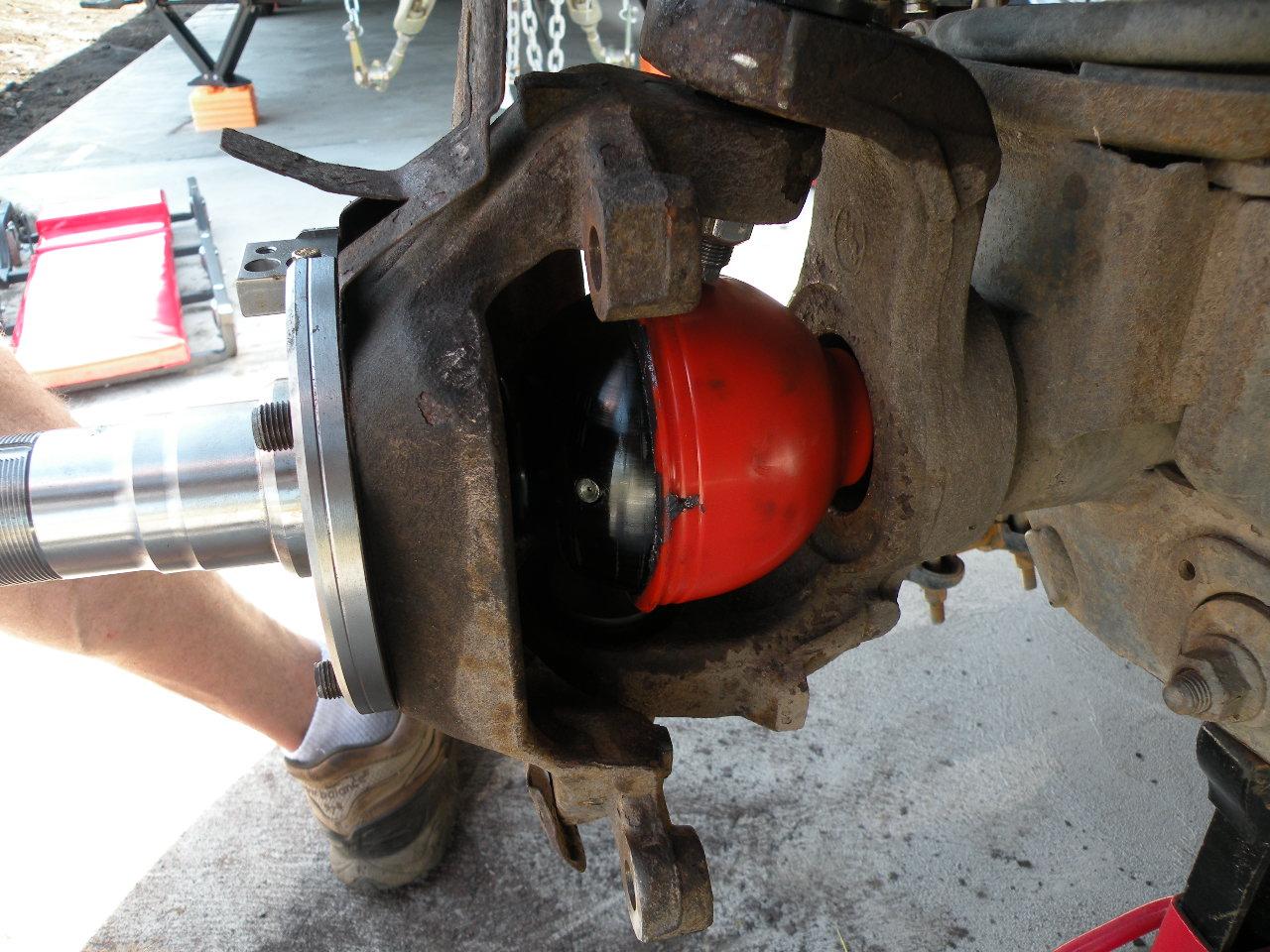

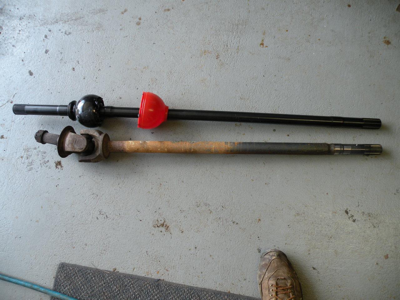

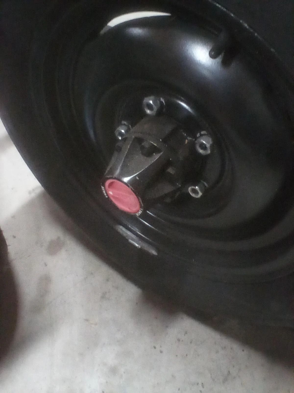

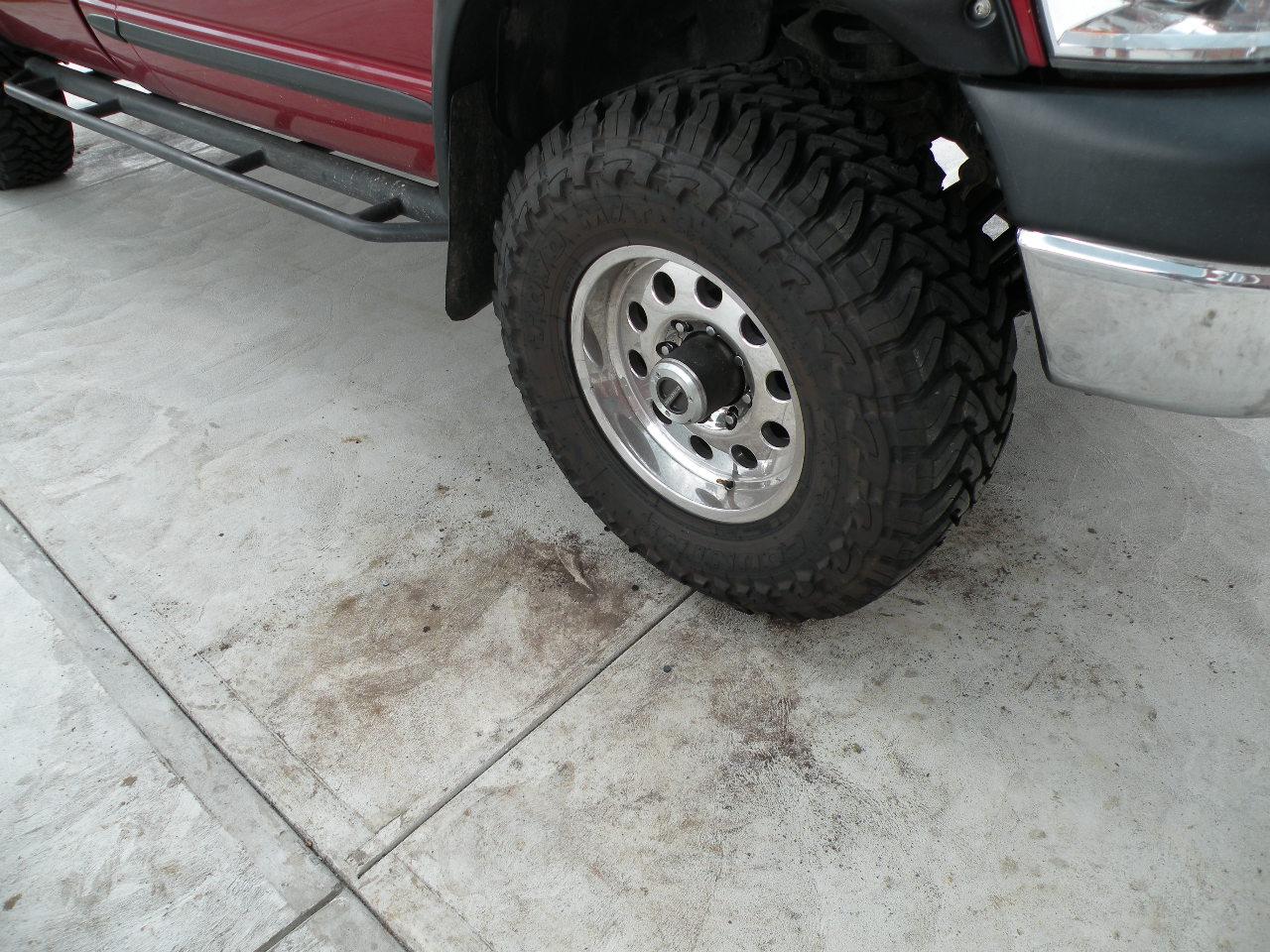

After breaking a front axle u-joint on the trail on my Power Wagon. I installed RCV axles and DynaTrac Freespin hubs. I will do it again on my JT when the parts are available. Or go with 60/80 diff's.
