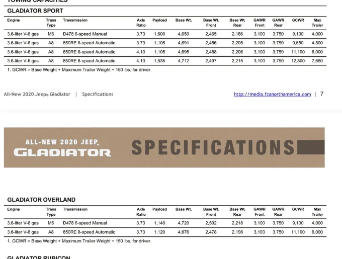

Any idea why the pay load would be 500# difference between the sport (without max tow) and the overland?

Because all the extras that the Overland has weigh more. The more options you put on a vehicle the more it takes away from the carrying capacity. I haven't looked at the numbers but I would bet that the Rubicon is even lower.

So I thought that at first but the weight difference is like 70# (or 31.8kg for all no Americans)

Could be the way the suspension is tuned. The overland may have softer suspension tuned for comfort which could cause the 500# difference. That is the only idea I have at the moment.

It’s probably the spring rate differences between the various models. The softer/ more comfortable the ride the lower the carrying capacity...

Yeah, thinking about it again, it would take a shit load of options to add up to 500lbs. I've also been looking/thinking about getting a Power Wagon for a few years now and its low payload number amazes me. The Gladiator has a higher payload than the 3/4 ton Power Wagon! Well at least the Sport model will. ;)

The sport without the Max Tow only has a payload of 1105 with the 8 speed vs the Overlands 1120. The Max Tow package gives it the Rubicons wider axles and upgraded suspension putting it at the 1535 Payload.

The suspension, vehicle weight, axle width, gearing and tire size cause the differences. Also, just remember, if you lift it, those numbers go out the window.

Gecko nailed it. The difference is the hardware.
Given the same vehicle, axles, suspension, etc., the only differences you'll find in payload relate to options on each vehicle. An Overland or Rubicon will have less payload because they've got more equipment.
THEN you have the Max Tow package, which is only available on the Sport, that includes different axles, brakes, cooling, etc. Heck, even the wheels are stamped with higher load capacity. It's a specific package that's engineered for more heavy duty work.

Please remember that the Rubicon trim level comes standard with the "tow package" set up if I remember correctly. At least the axles for sure.

According to Jeep, the shocks and springs are tuned to be more off road worthy (i.e. possibly softer springs and the Fox shocks vs the standard HD shocks and springs on the Sport) hence not being able to tow the full 7650, but still able to tow 7000. The springs and the 33" tires probably attribute to the loss of the 650lbs of towing in the Rubicon.
