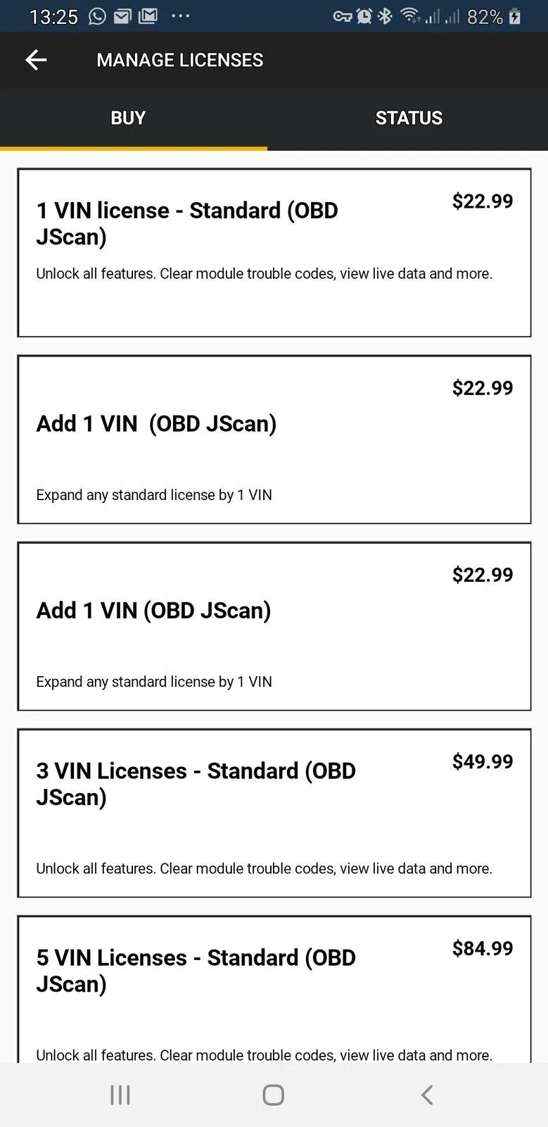

Then why the heck am I getting charged 22.99 PLUS TAX???
I'd LOVE to hear their explanation on that.
I'm paying 4 bucks more than the example above! 18.99 to 22.99 is a $4 difference.

I have not purchased my Jscan license yet, due to my lift kit shipment being very DELAYED. Reading this thread, I decided to see the cost for the in-app purchase, it is $22.99! I am using Android as well. Wow ... the licenses are cheaper on iOS? Why is one cheaper than the other? From what I understand about these app ecosystems, they all start out at 30% commission rates. Hmmm....
Jeep Gladiator Please teach me about jscan Screenshot_20201001-132509_OBD JScan
