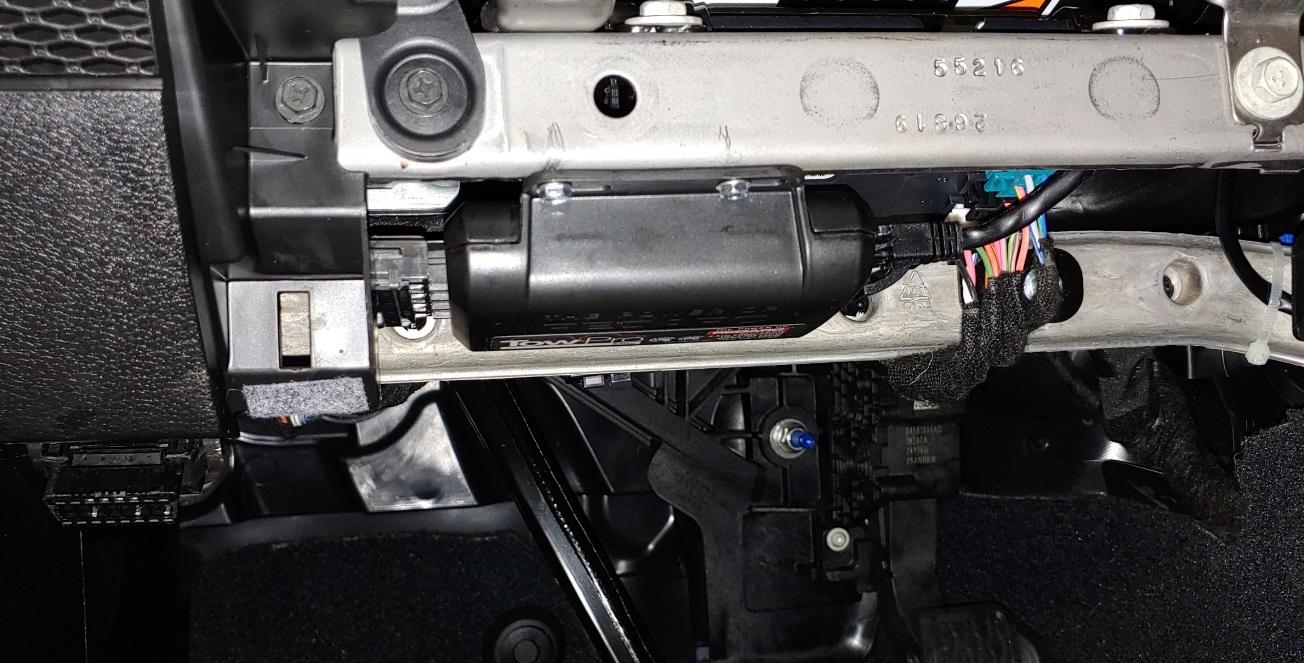

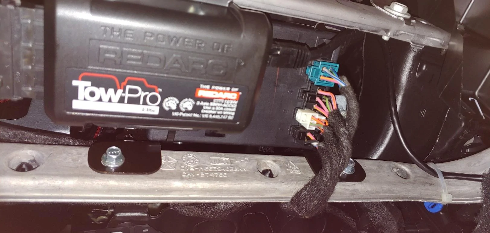

Excuse my ignorance, but I received the cable today and can’t locate where to plug it in. Can someone walk me through and/or show me some pictures of what I plug into the cable on from my JT. Thanks!
40,449
53,885
I don't know for a FACT, but believe it's these connectors - straight under the steering column, you have to pull the plastic trim off to get to them.
SOMEONE PLEASE CORRECT ME IF THIS LOCATION IS WRONG!
(I checked and Amazon says the cable is out of stock, so I couldn't get one ordered.)
This is looking up with that trim removed - where I mounted my brake controller box -
Jeep Gladiator Please teach me about jscan 12-20200915_111836
This shows the brake pedal area, trim removed, looking forward toward the firewall.
Jeep Gladiator Please teach me about jscan 11-20200915_111801

The plugs are not the ones shown in the pic above. They are in an akward position, up behind the OBD port.

If I remember correctly, the plug location depends on if you have an amplifier or not

I was all over the OBD port area of my truck - there weren't any plugs back there that I found while trying for 15 minutes to find the brake controller connection. That was TAPED to the big harness in that area, literally taped to it, not where you'd expect, and not hanging loose. I had to untape it and pull it away from the harness.
Maybe my connections for that bypass cable are the same way - taped to the big harness.
