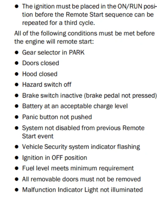

Not working? Does it not try to start at all? Does it start for 10 seconds and die.? The owners manual on page 19 (online) has the list of things to check.
Mine was 22, but close enough........ it will get you there.
It will also only work twice before a real start event takes place (press brake, press big round button) so if it's been tried twice, it won't even attempt it again until it's actually started in person.
If the doors have been off and something is amiss there, that's going to prevent it, along with this list ->

Looking at it,
That was my question. Hood shut. Try the other sensor.

Looking at it,
Doors do not need to be locked. They lock on activation.
Edit. Nm. See you were trying to see if doors lock on activation.
Exactly.
Start it normally to reset the remote start counter.
Shut it down.
Exit vehicle, fully close, but do not lock, the doors.
Try a remote start to see if the beast at least locks the doors.
Some basic troubleshooting rather than tossing mud at the wall and see which mud sticks.
