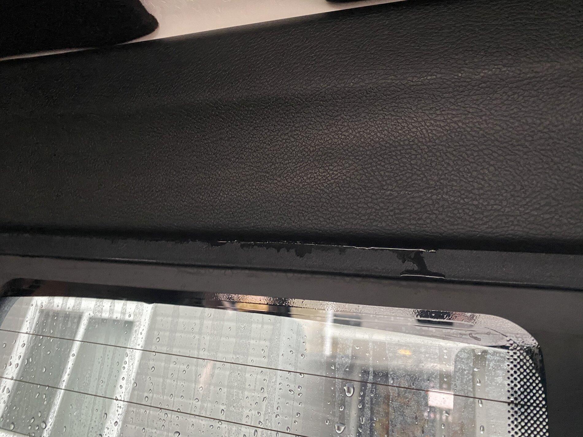

Add another leaking rear window to the list. Calling the dealer tomorrow to get it fixed and i am still having an issue with the third-eye break light in the tailgate not working.

Jeep Gladiator Roof leak in back 5EA9C158-9C5D-447C-A0F1-F5B328F5AEA7

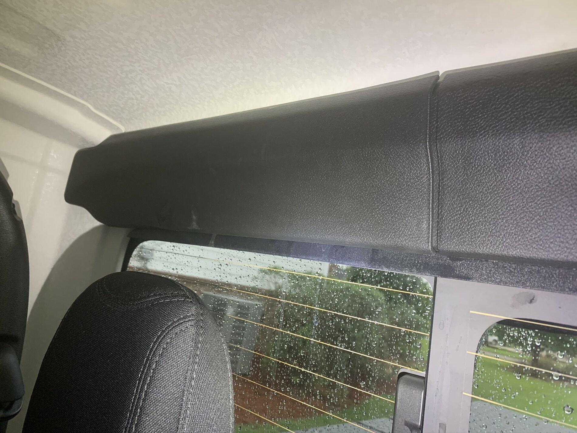

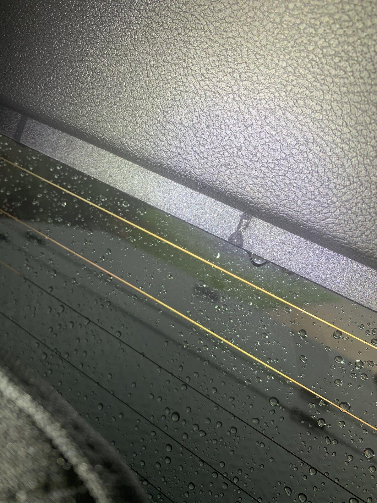

Jeep Gladiator Roof leak in back C90F7A88-62C1-42C1-908E-96A731B10018

I have had my Gladiator over a year now and it just sat outside overnight in a hard rain for the first time. I was curious if mine leaked too and to my surprise, it did. I’m not taking it to the dealer because:
1. I don’t trust them to fix it more than I trust them to mess something else up.
2. It’s not a big leak and it’s the first time in a year. Not to mention it stays inside of a garage 99.5% of the time it’s not being driven.
Good luck to the rest of you.

Your prerogative but it will get worse over time.
