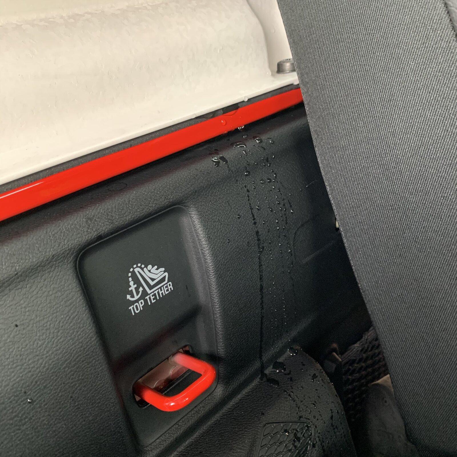

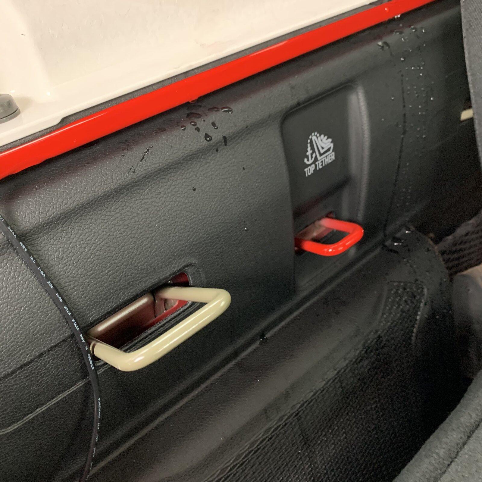

same here---leaking right in the middle.
didnt notice it but a buddy had the issue and told me about it--so i looks and sure a shit the #$#$ is leaking all over the subwoofer.
got appointment tomorrow....will see how that goes...

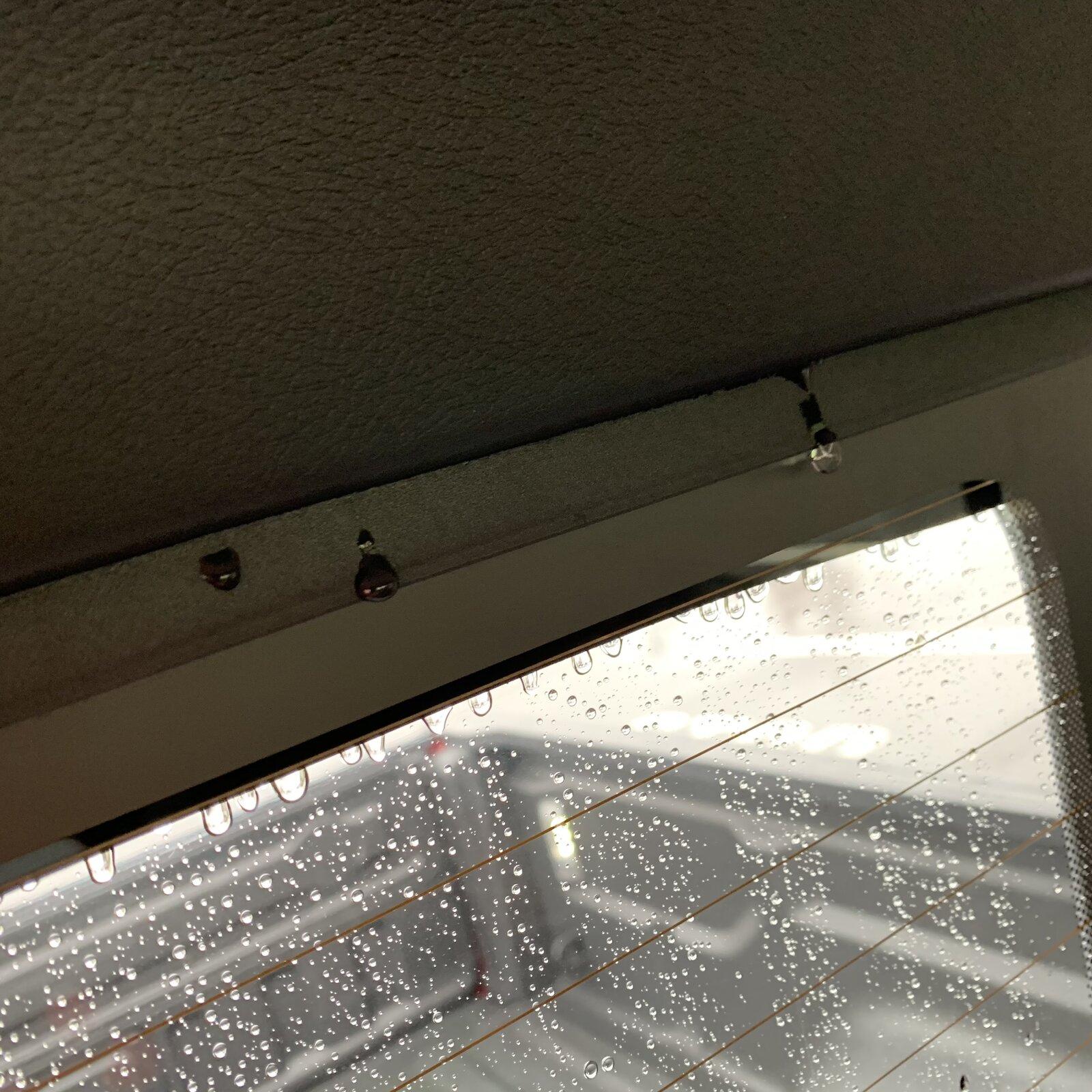

Add me to the rear glass leaking club. Appointment next Wednesday. Went to run the girls to practice and had the jeep outside the garage as I was doing some home projects. Girls jumped in and said "dad you left a window down or something the seats are wet". Got back there and noticed the rear window leaking in three places. It is garaged at work, and home. Also bought it off the show room floor, so who knows how long it has been like that.

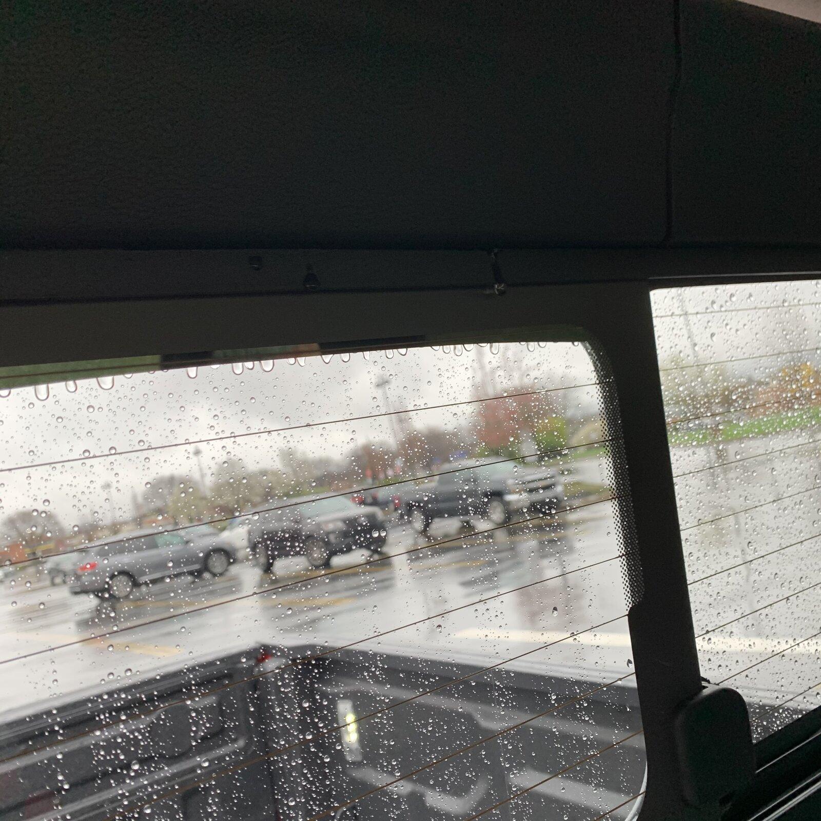

I've checked mine after the last couple of rain storms and everything has been dry. We are a dry climate here in Ut, so I'll continue to monitor.
Rain storm today so I went and checked again. I found a few drops of water on the trim piece above the center of the rear sliding window...off to call the dealer
