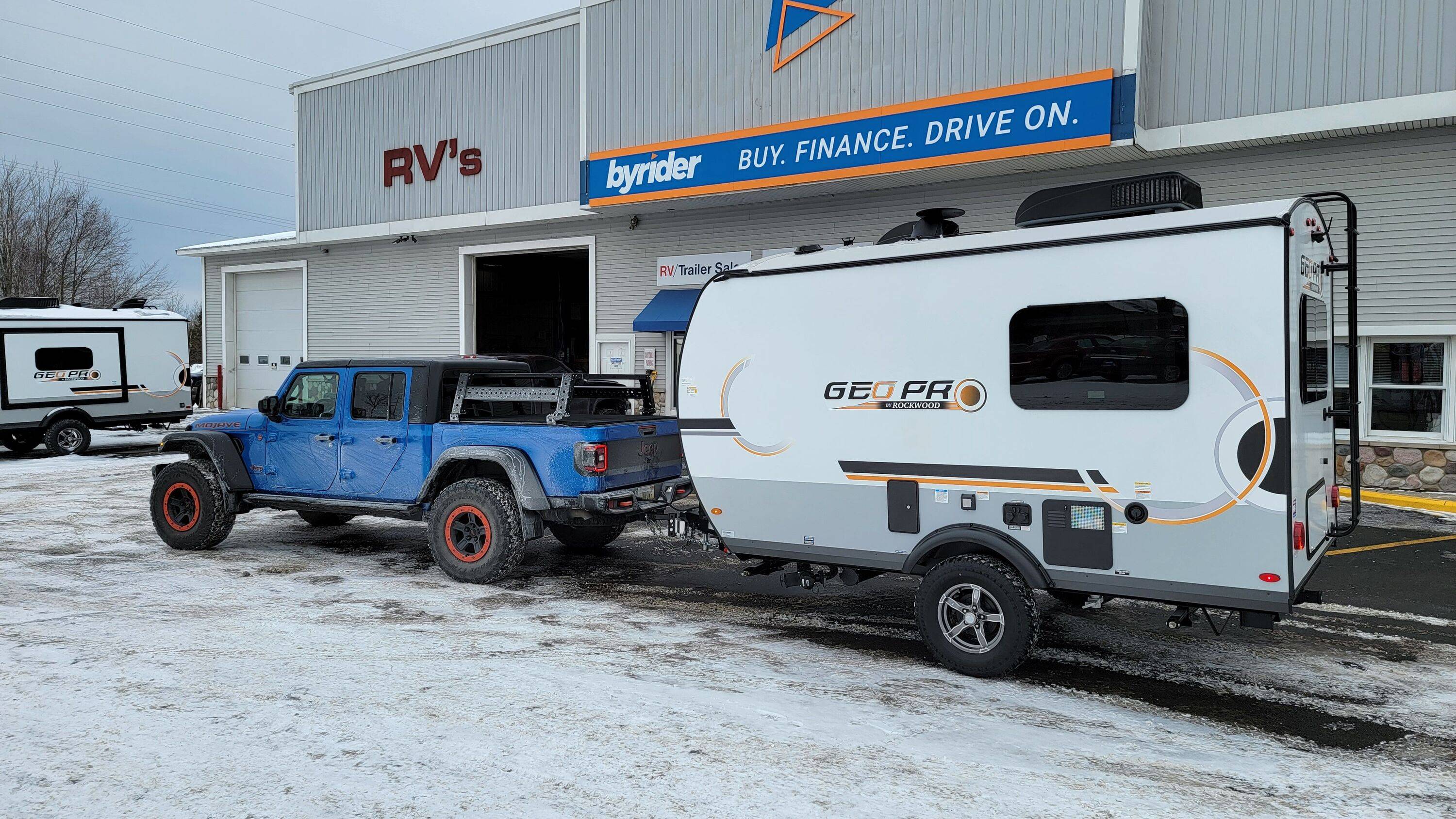

My Mojave has Mopar beadlock wheels and 37" tires on stock gearing. I have no issues with power even with the heavier tires and I do a bit of city driving zipping in and out of traffic. I picked up a new camper last week and even though it was like pulling a 2700# brick behind me I cruised at 65 in 6th gear (automatic trans manually shifted) with no power issues. I do live in Michigan so not much for hills. I am putting a hold on regearing because I don't know, for where I am, that the gearing would be of much benifit.
