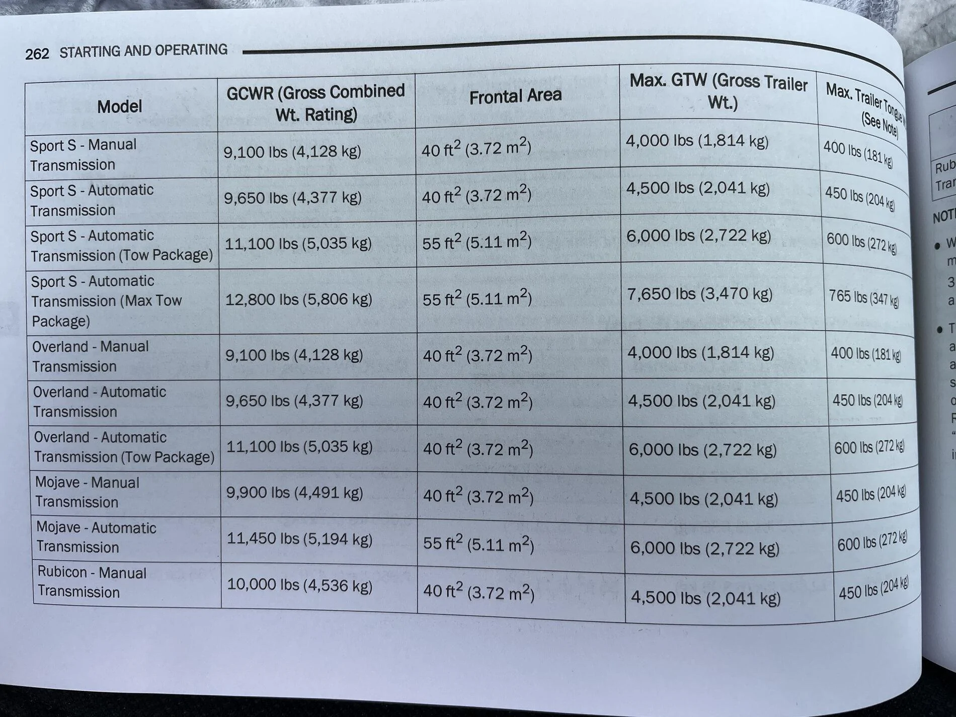

I’m sure this reply has happened, but oh well. The only way to get close to max tow’s 7650 is to get a rubicon which is rated for 7000. That’s why we got the rubicon. Good towing capacity and dual lockers and electric sway bar disconnect. It’s the perfect trim level for off road towing. The Mohave is just better for high speed off-roading. The rubicon wins for rocks all day.

Jet 83 above stated “all other trim
Jet 83 in a thread above stated, “Max tow is only an option on Sport, Sport S and Altitude package, with max tow rated at 7,650 lbs, all the other trims have a max of 6000 lbs with the auto transmission.”
Not “all other trims” have a max of 6k. Some are 7k.

The only thing the tow package on the Mojave adds is a receiver hitch. Period.
You would be a fool to swap to Max Tow springs because the Mojave suspension tuning is about as good as it gets.
I've mentioned before that the Mojave is the only Gladiator that truly feels "sorted" in the suspension department when it comes to every day unladen driving on the road.

My tow package Sport S pulls my travel trailer just fine, but if I towed more weight then I’d certainly want heavier duty. My only reason for not having max tow was this one was Gator ?. Regardless I think this is a small and light truck for more than 6,000 lbs.
