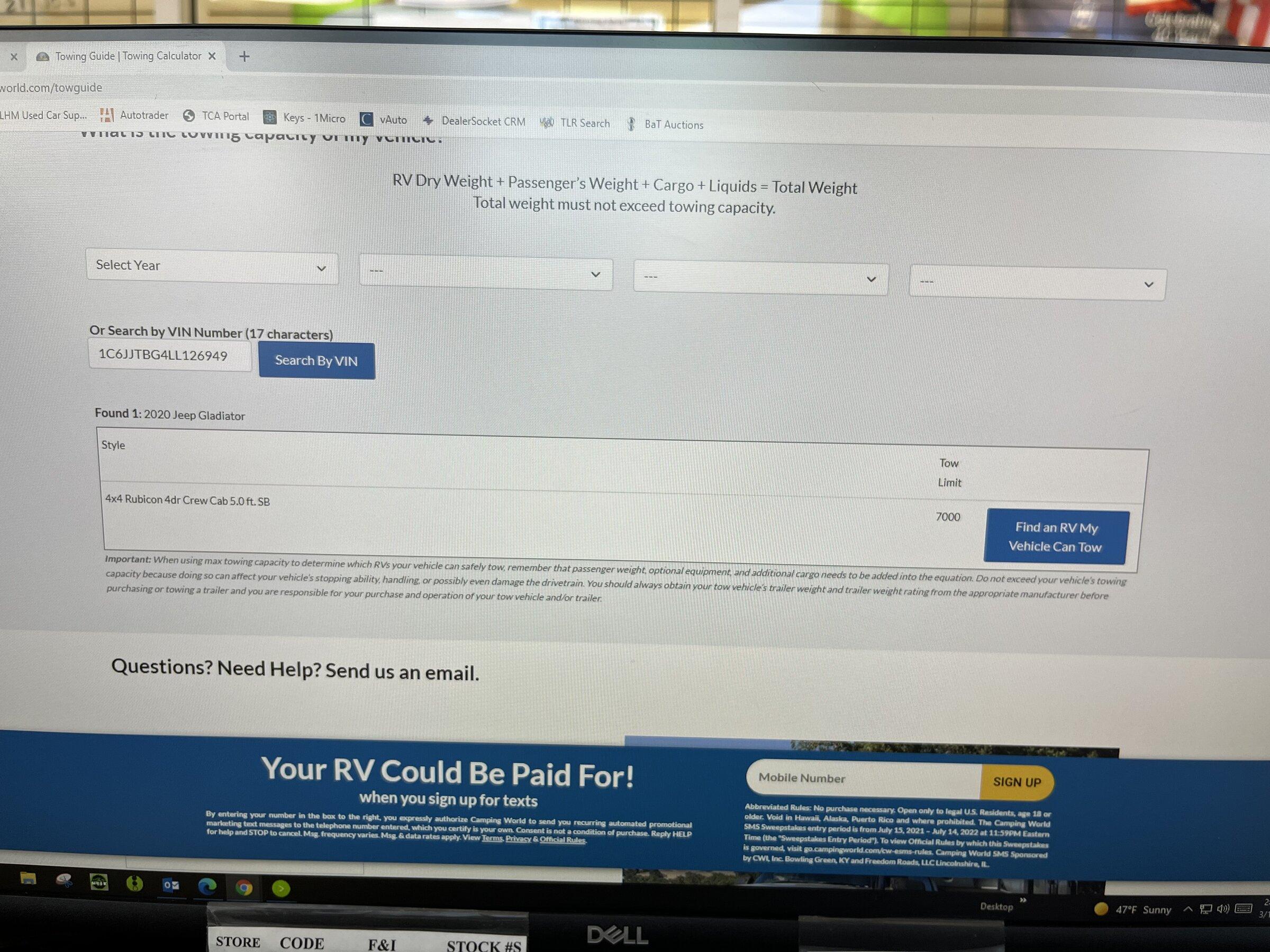

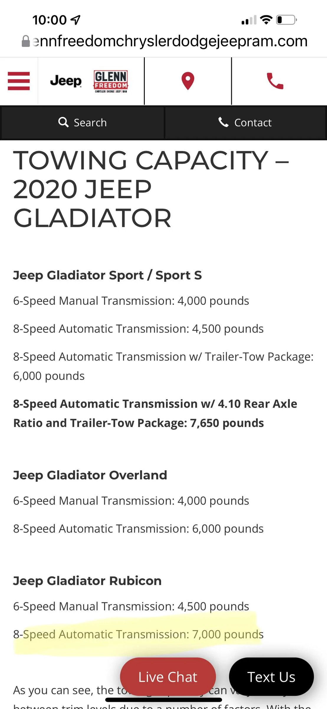

Max tow is only an option on Sport, Sport S and Altitude package, with max tow rated at 7,650 lbs, all the other trims have a max of 6000 lbs with the auto transmission.
I have a 2020 Gladiator Rubicon. Several other sites and dealer confirmed my tow capacity is 7k.
