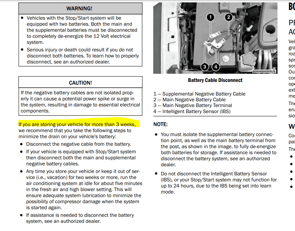

If sitting for the full 11 months, I would:
1) Do an oil change just before leaving. On your last drive, make sure to get it fully up to operating temperature.
2) Fill the gas tank and add stabilizer.
3) Over-inflate the tires by about 10%, although theoretically you can go up to the max sidewall inflation pressure. Alternately, you could put jack stands under the axles to take the load off the tires. While modern tire construction typically isn't susceptible to permanent flat-spotting, it isn't a bad idea to do one of these things.
4) Then follow the Owners Manual:
An alternate to disconnecting the battery would be to use a battery tender/maintainer as mentioned above.
