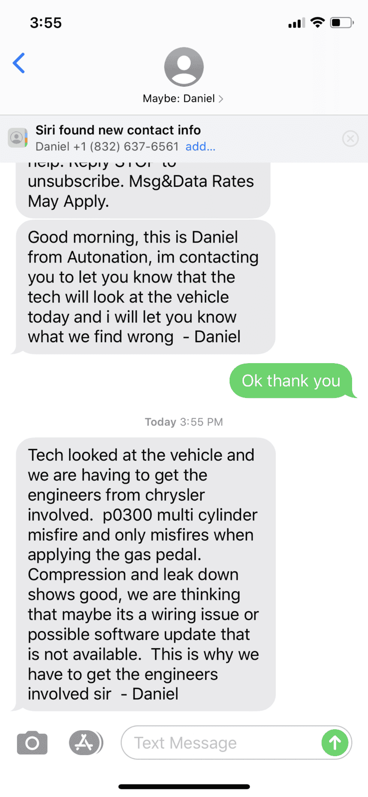

Let the games begin! damn dealer won’t take Jeep back even though the bank still hasn’t finalized the loan. Only had this pos in my driveway for less than 48 hours :mad:
Drive it like you own it! Sorry to say but it sounds like at this point you own it. I say keep driving it. Have the dealer keep clearing the code. It will either fix itself at some point or FCA will eventually come out with a fix. In my opinion there is nothing wrong with it.

Complete educated guess, but the issue causes the engine to start pulling timing. And the act of pulling the timing, then creates an actual problem, now the timing is off, the shifting is off, and the fueling is off. That is my guess as to how your JT progressed to shaking.
I am not sure if the dealer can clear the adaptive Learning. If you could get the latest software and then drive it for a bit like it owes you money, it may drive good for a while as long as there is not some real Mechanical issue like phazers, rockers or lifters.
I don’t disagree with you, but it does actually start misfiring on acceleration. They won’t “release“ it for me to drive until they can get it to stop misfiring but on the other hand I was persistent enough that I wasn’t driving a damn car until they finish molesting my Jeep. Swapped the car out for a loaner rebel. That on the other hand I will drive like I stol.... I mean own it:devil:
