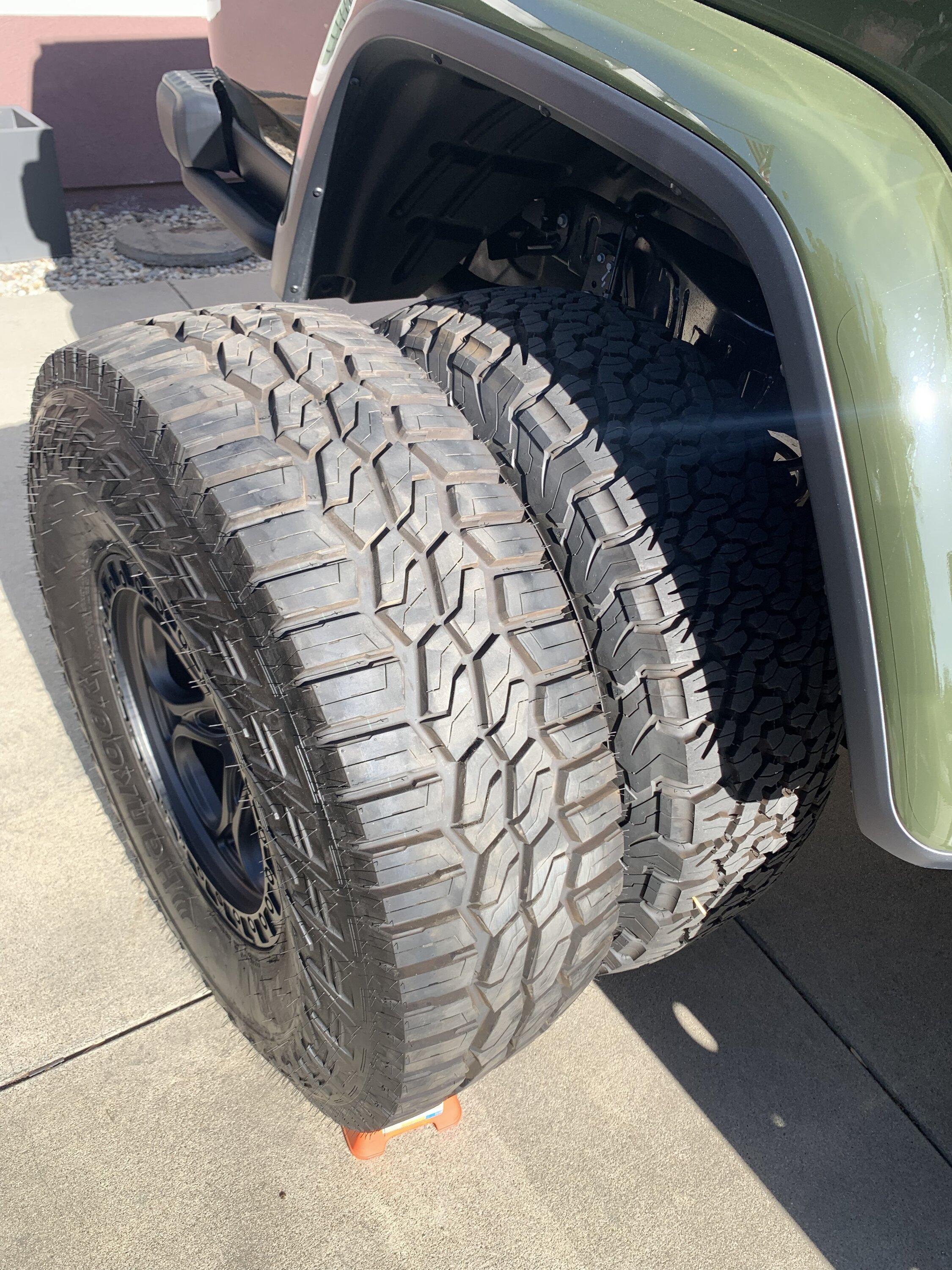

Hasted
Bradley
Jul 15, 2021
64
163
Ohio
TJ
ASL Interpreter/ Teacher

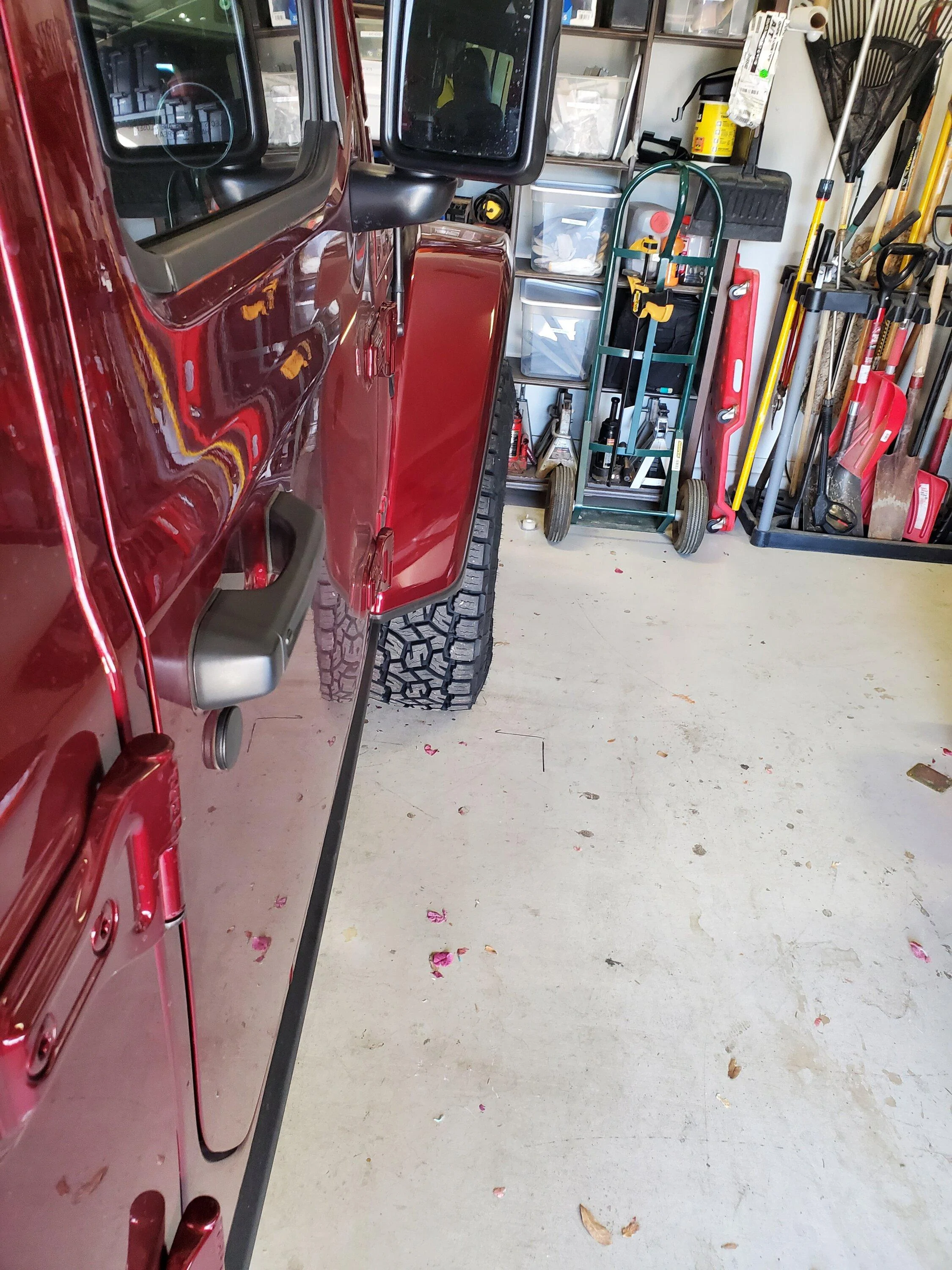

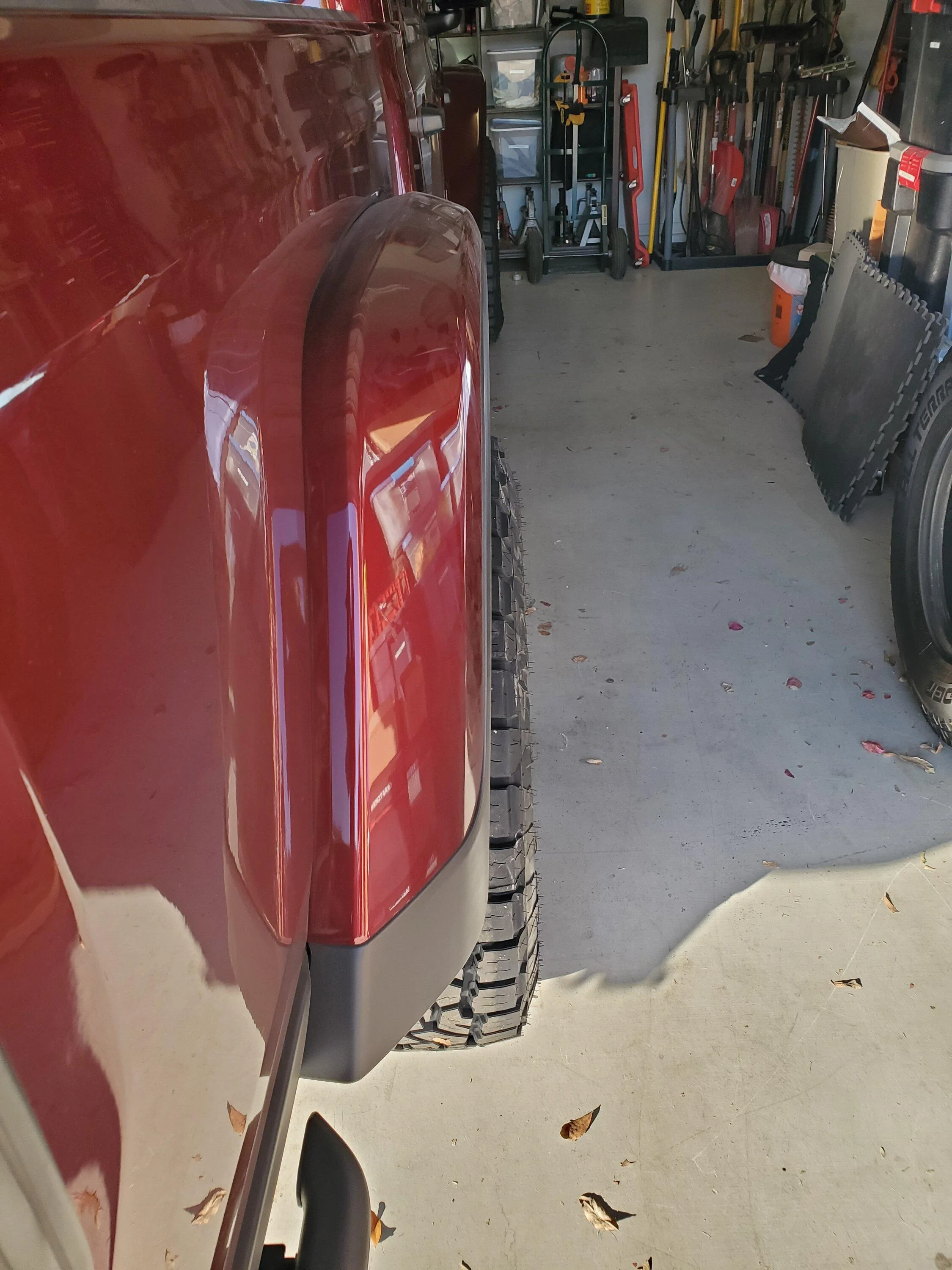

Jeep Gladiator Taking the plunge on wheels and tires. Holy moly… 20220701_150221

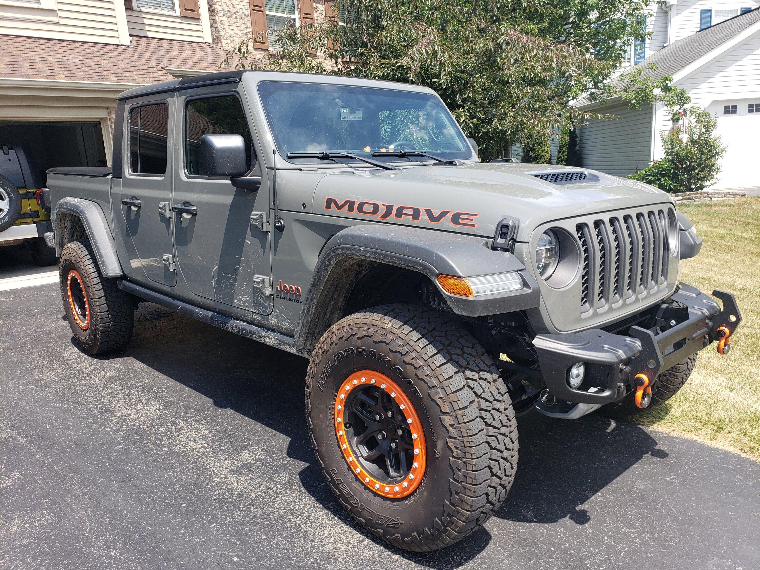

I got the AEV Borahs with the same offset. Love them! This should be a good idea of how it sits for you.
I did end up sticking with the Wildpeaks, too! They are just as quiet and well mannered at 37".

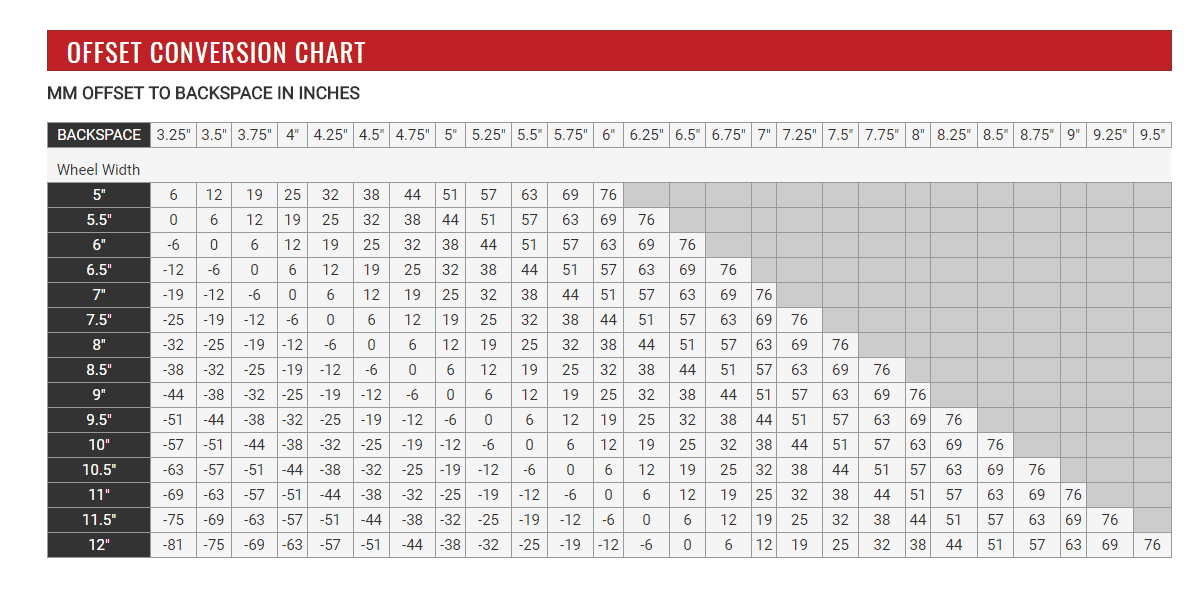

You want +25 offset wheels but don't mention the wheel width. Offset varies by wheel width, so +25 on 8" wheels have different backspacing (which is what you're really asking about) than +25 on a 9" wheel. See chart.

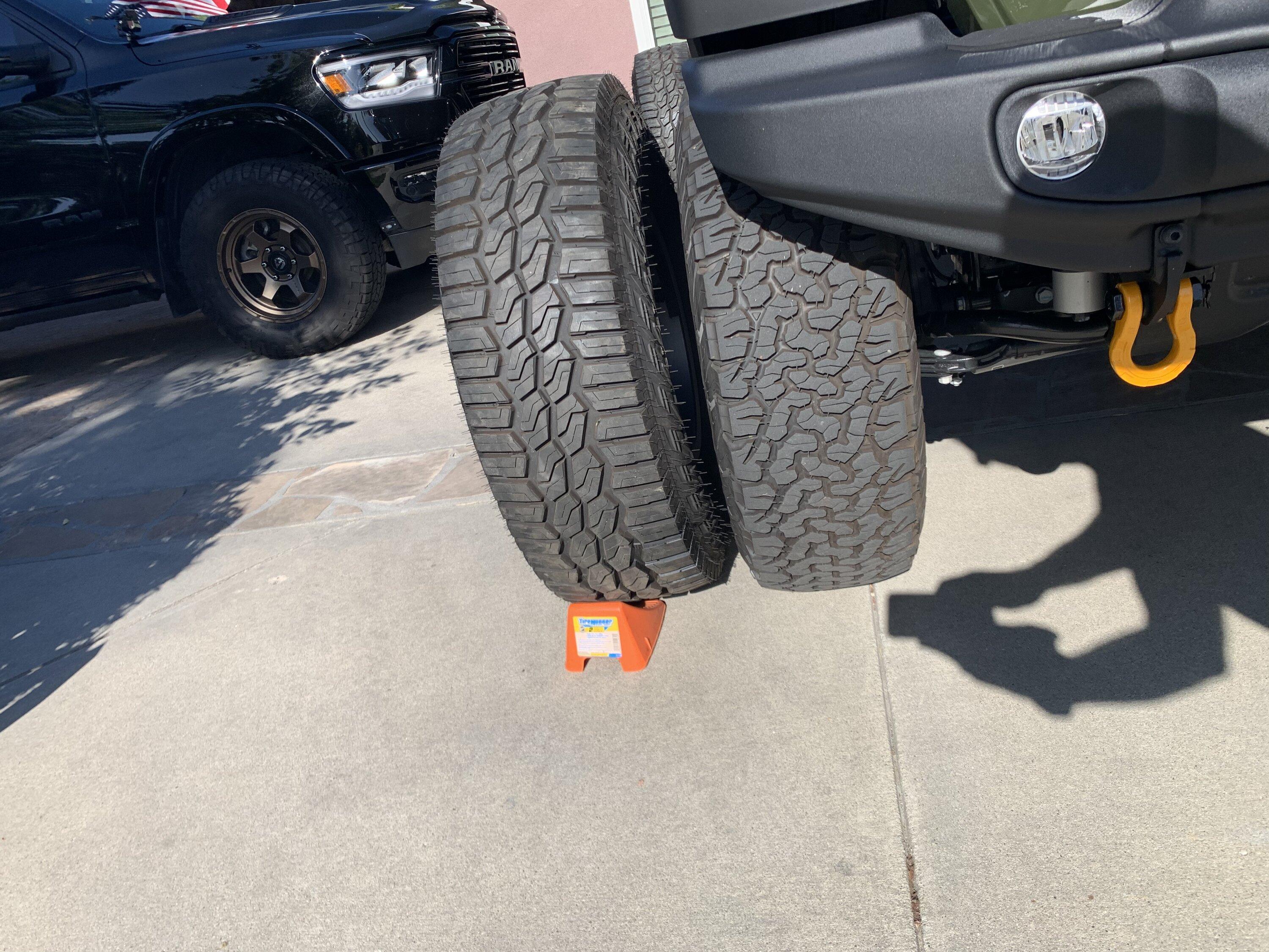

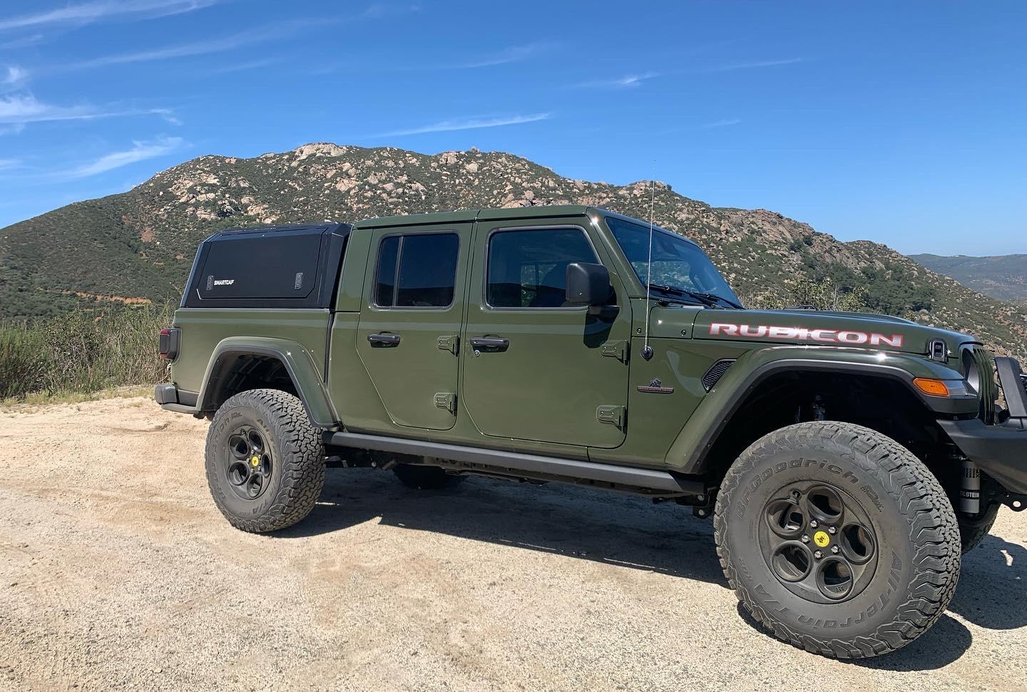

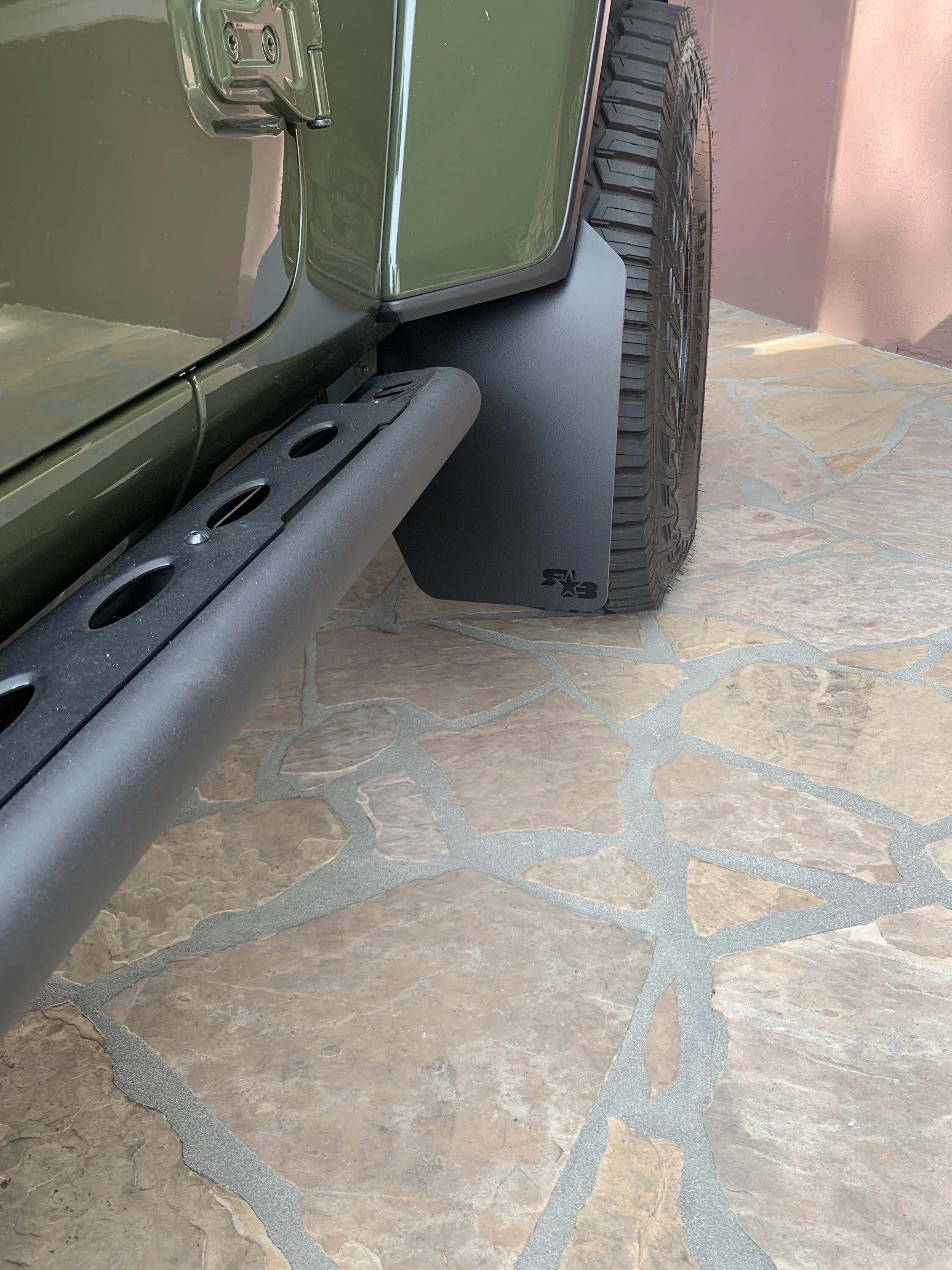

I went with Borahs (+25mm offset for the JL/JT) and 35" (well; LT315s because I couldn't get the 35x12.5 anywhere). Just the right amount of "poke". Also did the AEV 2" lift. Nice setup for what I want to do. Thought about 37s, but really didn't want to have to regear. I agree, tire costs are crazy!

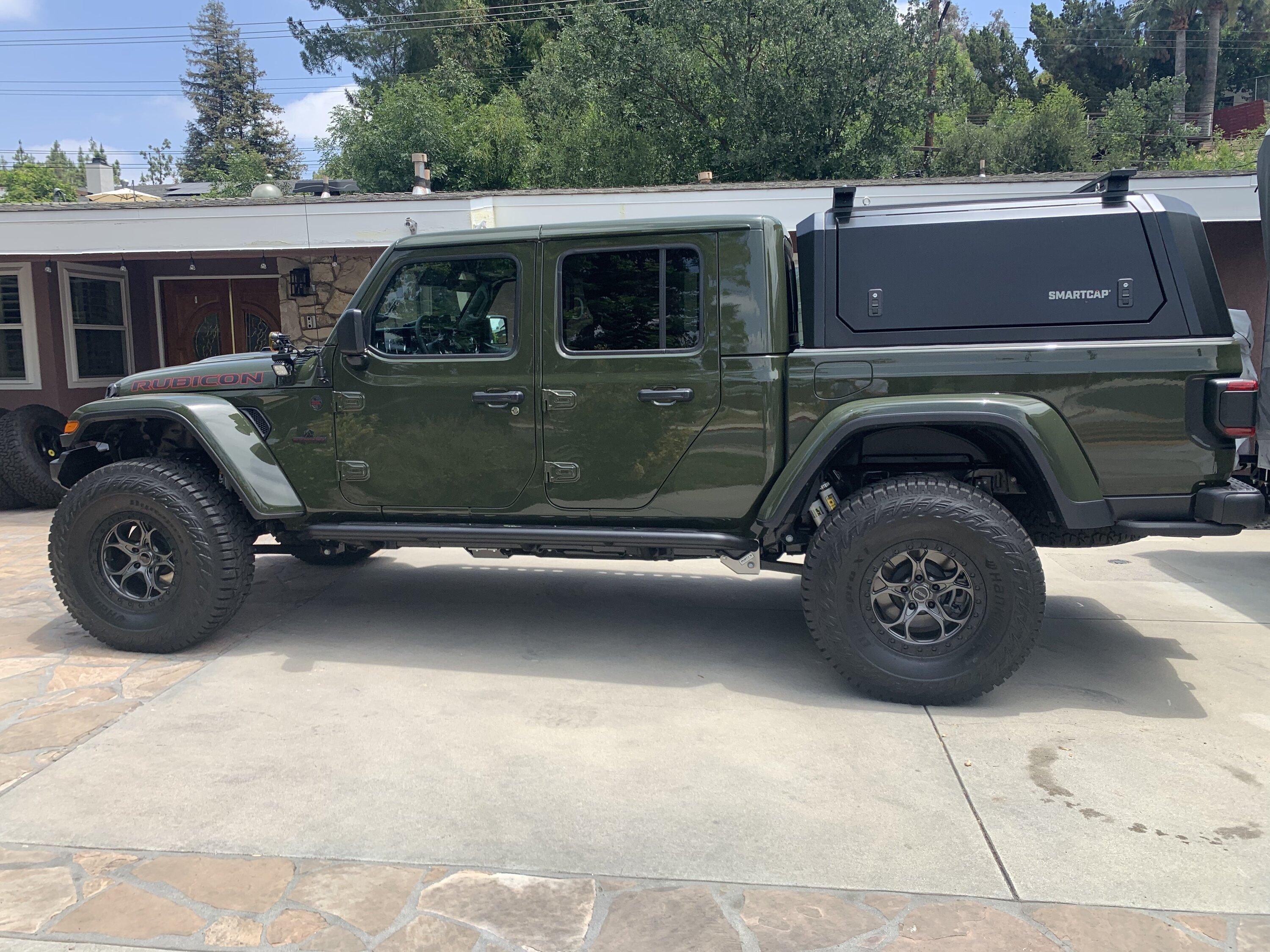

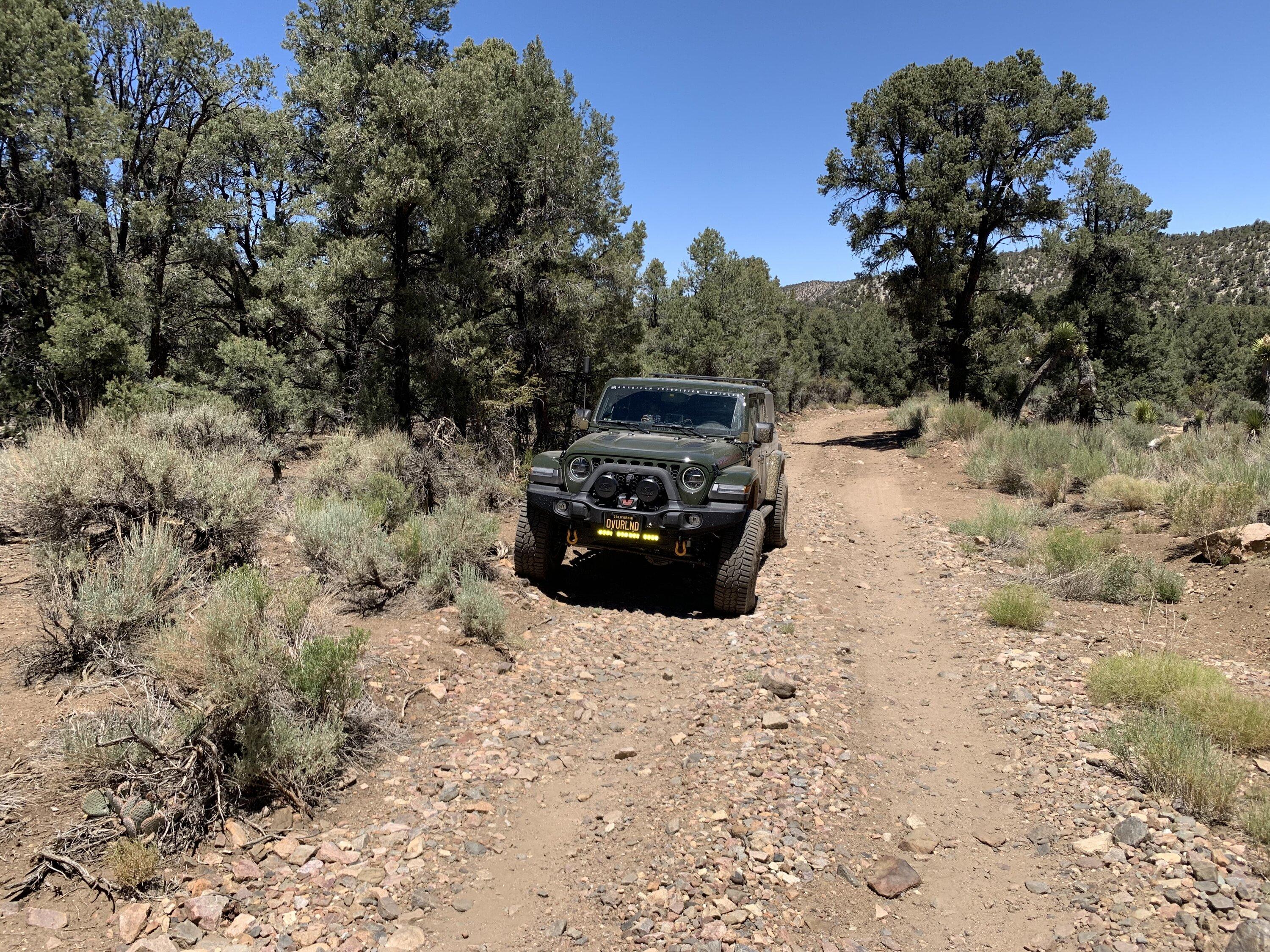

I am running Savegres with KO2s and also have a set of lightly used weld wheels with Hankooks on them. Both 37-12.5 and the bfgs are noticeably smaller. Using the weld set up for trails and AEV wheels for everyday. Rides much nicer on the aev set up looks a little cleaner. The welds have a lot of negative offset and stick out pretty far.

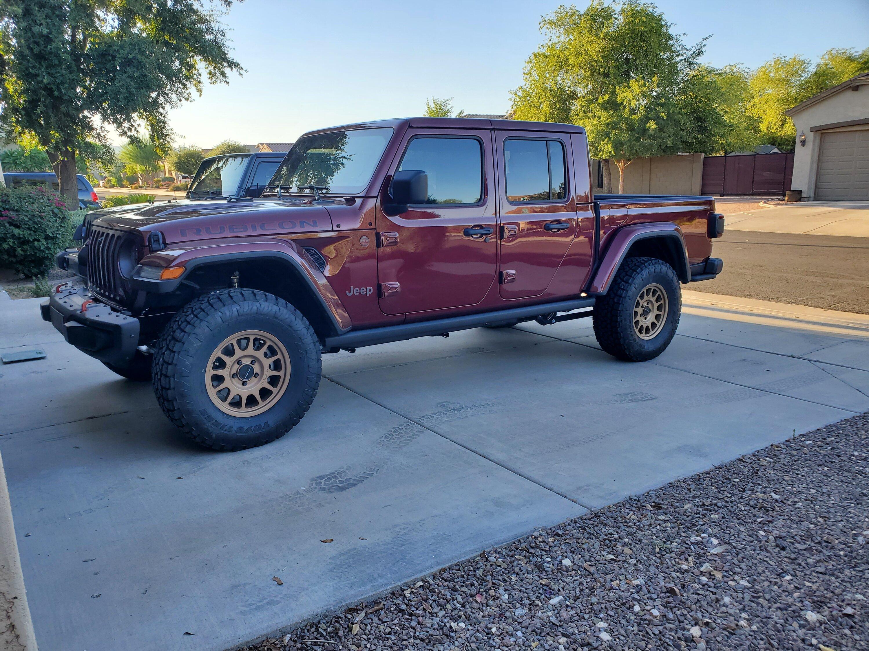

I went with 35x12.5x17 Toyo ATIIIs on Method 703s with 25mm offset.
That is exactly what I’m going for. Those tires really fill the wheel wells nicely!
