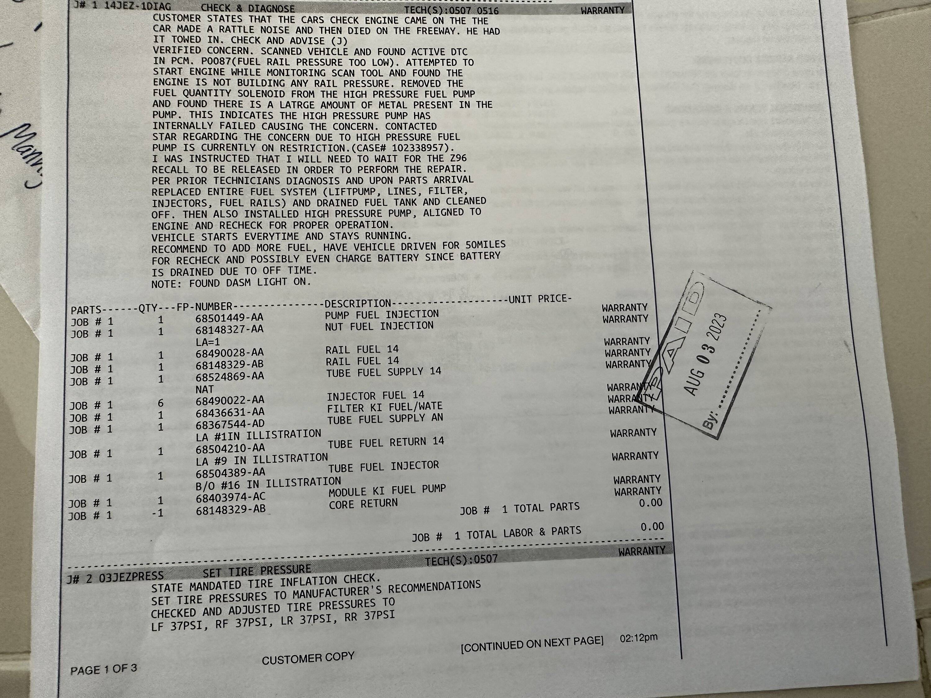

An update to my HPFP failure and it’s repair.
I received a call from the dealership that my JT is repaired and ready for pickup tomorrow morning. When I get the paperwork I will post the relevant information.
I’m happy to get my truck back. I’ve missed having the top off for the summer so far.

Another update to my HPFP failure and replacement.
New injectors
New pump
New fuel rails
New fuel lines
New filter
This paperwork doesn’t show labor and parts cost. However, I did look at the dealer paperwork that showed their cost. Oh my.
I had them change the oil and filter while it was there( died on June 27th and received it back on August 3rd). They had my truck a total of 38 days.
I did receive the truck back with it still throwing a code. That code is most likely due to my AFE intake. I plan on uninstalling that intake tomorrow anyways as I have ordered the AEV dorkel. Hopefully, fingers crossed, reverting back to the stock intake will eliminate that last code. If it doesn’t, I’m sure the dealership will resolve it for me.
Overall, my dealership experience has been pretty good. My service advisor( Charles at Walnut Creek Jeep) was excellent and kept me in the loop for all the important developments. I would highly recommend him.
As for having the truck back, I am happy with it. it’s too early to tell if the performance has changed in anyway. I can only hope that they resolve the recall soon and that I don’t have to post anything about it otherwise from here on out.
Ok, I’ve driven the truck all day for work and the check engine light came on after about 75 miles since picking it up from the dealership. The code being presented is the CCV code the intake has thrown before. I plan on swapping the AFE intake out tomorrow afternoon. Hopefully, it won’t return with the stock intake back on.
This was posted in my build thread, but, I figured it was relevant to this thread as well.
Thanks for the update @Anderson . I just got a text from my service manager saying the parts will be coming in this month. Curious though, are they just replacing with the same HPFP?

Anderson
Anderson
Dec 3, 2020
145
178
Benicia CA
2021 Rubicon
Tinker Extraordinaire
From what my service advisor tells me, the replacement parts to “fix” the CP4 failures are still not available. My new pump is still fallible. .
