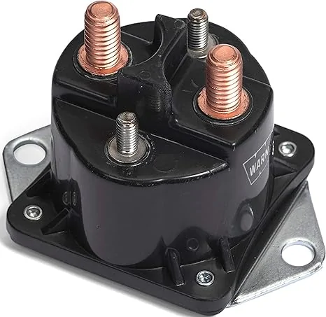

One of these: https://www.warn.com/power-interrupt-kit-62132
Throw away the switch that comes with it. Wire one of your AUX lines to the trigger input.
Probably cheaper at other sources of your choice. It's an Ametek SAS-4214, but similar solenoids are available lots of places.
^This exactly. The solenoid should be rated for actual winch use.

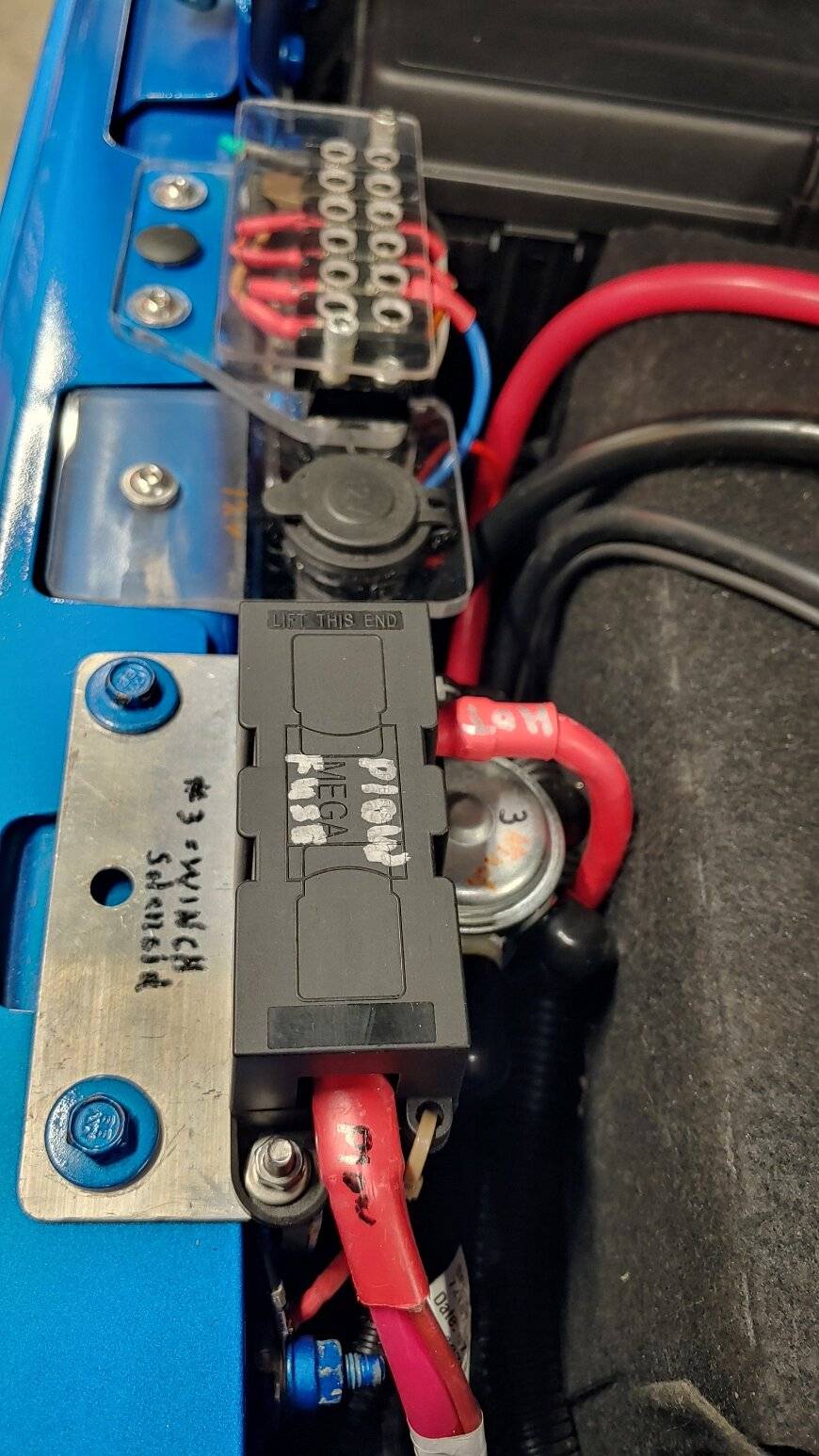

Can you provide a link on how to add the isolation or switched function through the Aux switch? I mounted a winch yesterday, and the winch had no instruction or hardware for this. thanks!
You use either a remote power switch or a solenoid. The solenoid can be controlled from the aux switches.
I use a solenoid as I don't want to open the hood to use the winch. Wire the winch to the heavy terminals, connect the aux switch to one of the small terminals, ground to the other terminal.
I'm using a 500A continuous duty solenoid.

Not sure on the link, but look for winch solenoid connected to factory aux switches. It’s a pretty straight forward connection.
Super suggestion; thanks! I should probably use one of the 2 low amp aux switches, since it is only controlling the solenoid coil. From what I understand 2 of them are rated at 40 amps, and 2 ea @ 15.
Correct. 3 and 4 are 15amp, 1 and 2 are 40amp. I use aux three for my winch solenoid, aux 4 for a set of low power lights, and aux 1 and 2 for sets of higher power draw lights.

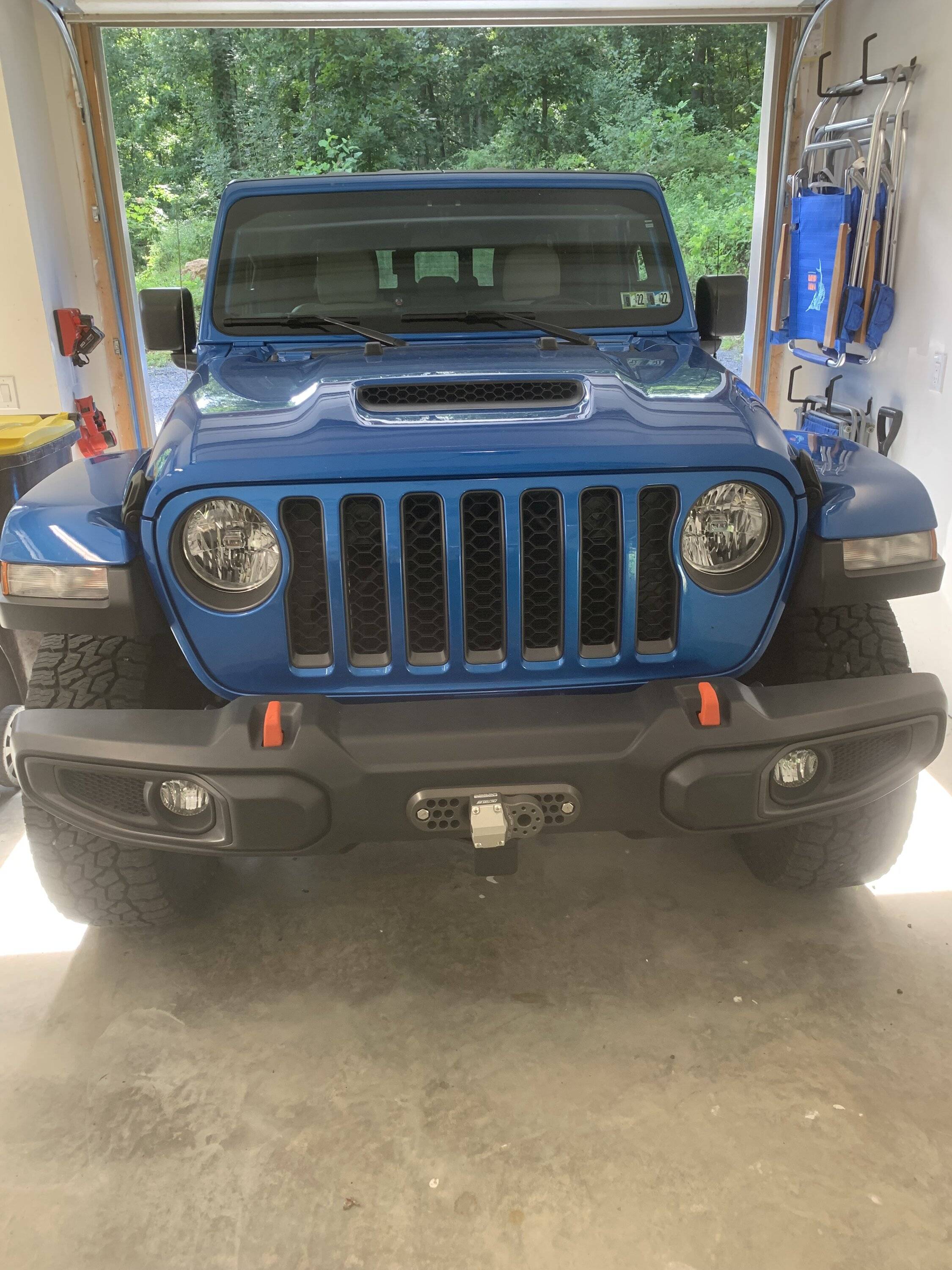

I admit I’m poser but not a mall crawler and hardly wheel but do drive out onto beaches that are sketchy at times and use my winch for pulling logs out of my woods. I bought an expensive winch but very lightweight 9000lb. winch. Whole setup including winch plate comes in at about seventy pounds have no sag and I mounted my winch control box remotely next to the battery. I feel that is the best way to do it ,no solenoids, no control wiring going to relays and switches, which are all failure points. What do I do for a living, I’m an electrician why make things complex that should be simple. My lead from control box to battery is about ten inches right at the battery, my hand held remote plugs in under the hood if wanted and my warn remote kit plugs into the handheld plug outlet on box and the remote works great.
I went to lengths to keep it simple and light , my winch is in the bumper and not visible or exposed, and bumper is the factory plastic. Most people have no idea there is a winch on the Mojave other then a gray Fairlead and grey flat link…..Jack
Edit: I rotated the clutch housing on winch so clutch handle is on rear of winch easily reached. Most basic old school
winchs with out decorative housings can rotate the clutch housing, just undo bolts pull them out and spin the housing, but do not, do not pull the housing off!

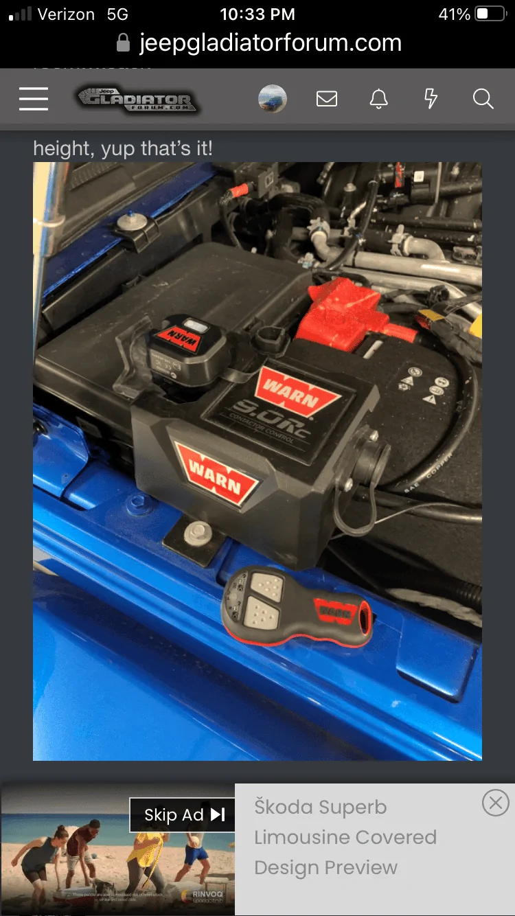

Can you add a picture of how you mounted your winch control box?

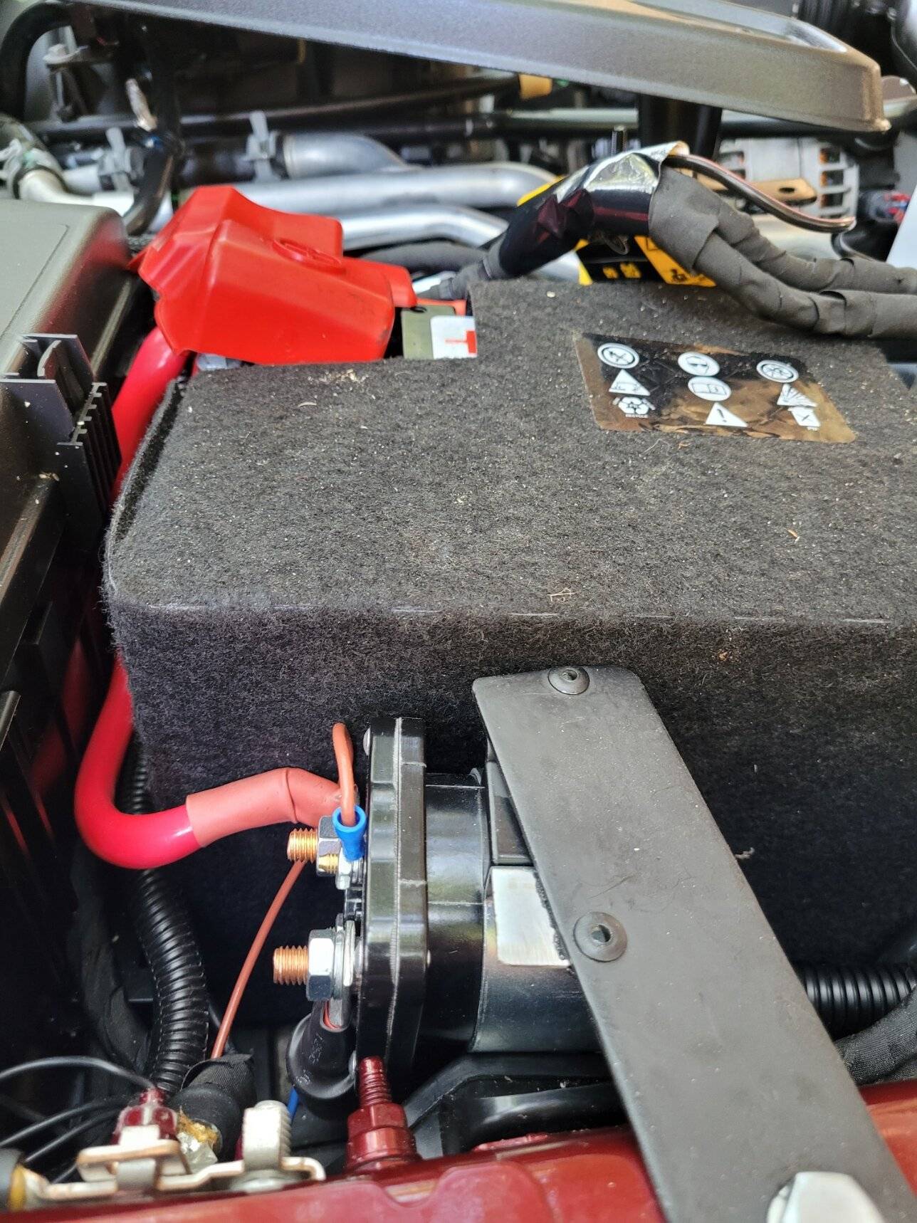

As far as fire risk, the cables shouldn’t be energized at the front of the vehicle. A solenoid connected to an aux switch or any switch should be mounted right next to the battery. That way your risk of fire from an impact is the same as a direct hit to the battery itself.
Exactly - there's no power up front, the cable from battery to cutoff is very short, the cutoff is literally right at the battery, no increased risk.
