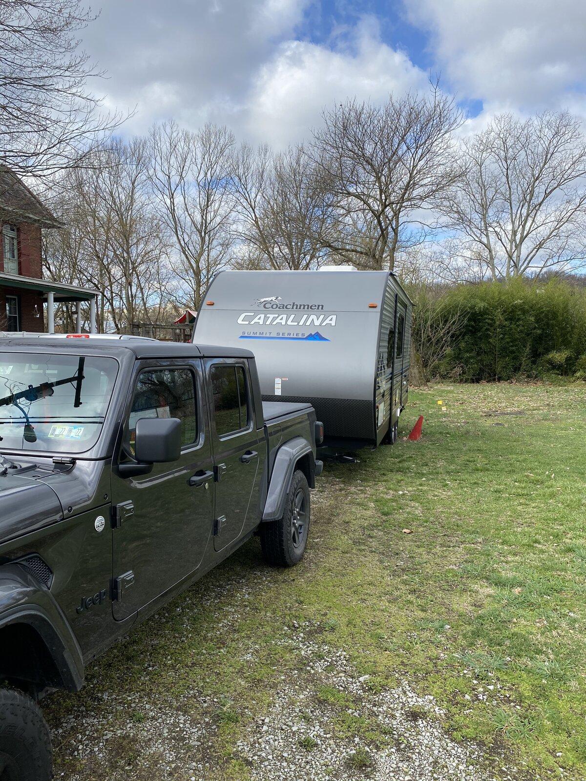

Just my opinion. I bought a new 2021 Gladiator sport s with max tow package. Took the camper out today. 26ā€™ Catalina. I do have weight distribution and anti sway hitch. Also had the integrated brake control installed by the dealer. I must say, I was very impressed. Towed better than my 2018 F-150 did. No bounce, and no sway. Didnā€™t seam to lack power either. Iā€™ve towed with a 2016 Silverado, 2017 F-150, and a 2005 Dodge Ram 1500. Have to say, I think this was by far, my best towing experience.

What model Catalina are you hauling? Curious what tongue weight and dry weight are?

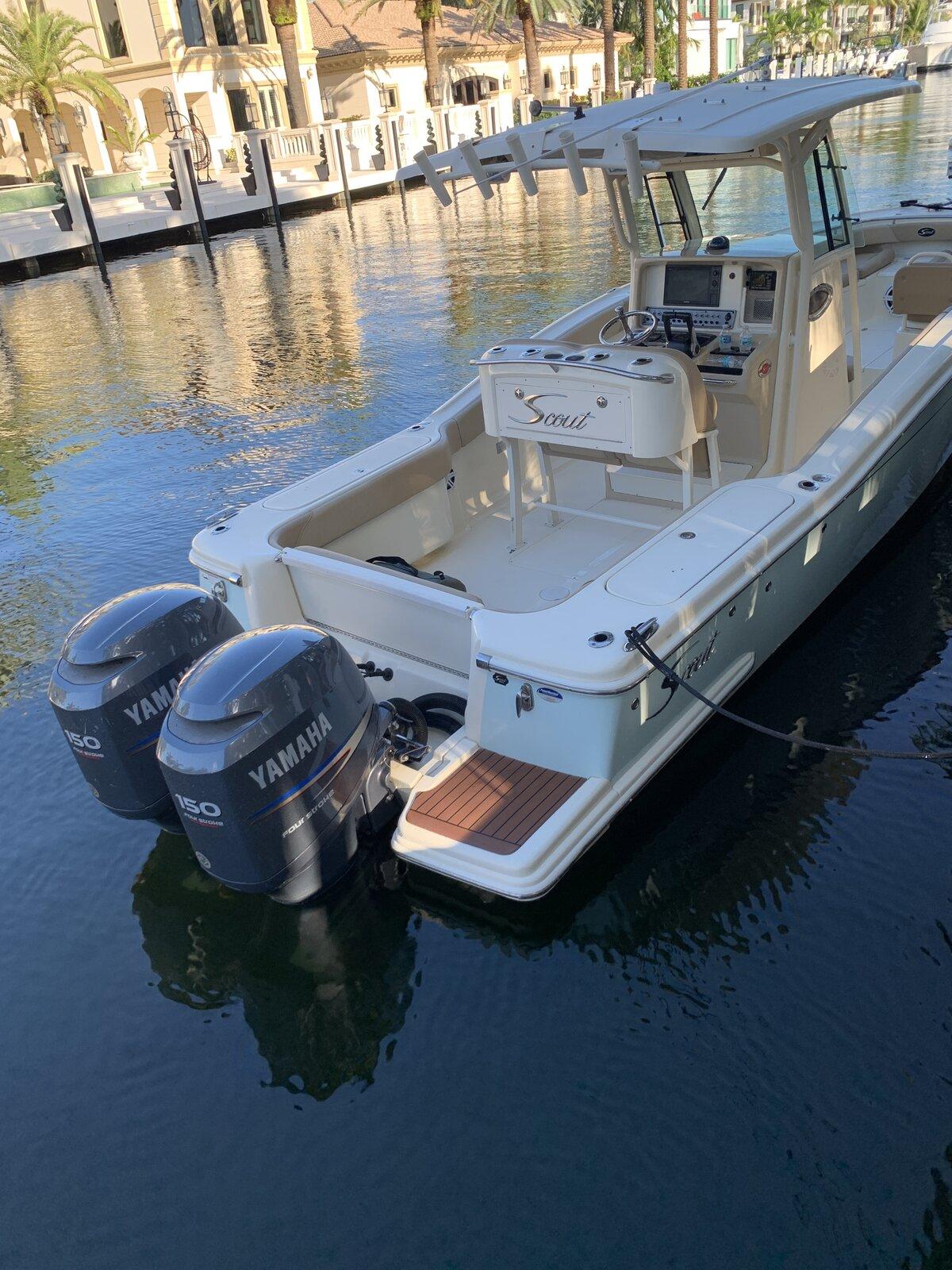

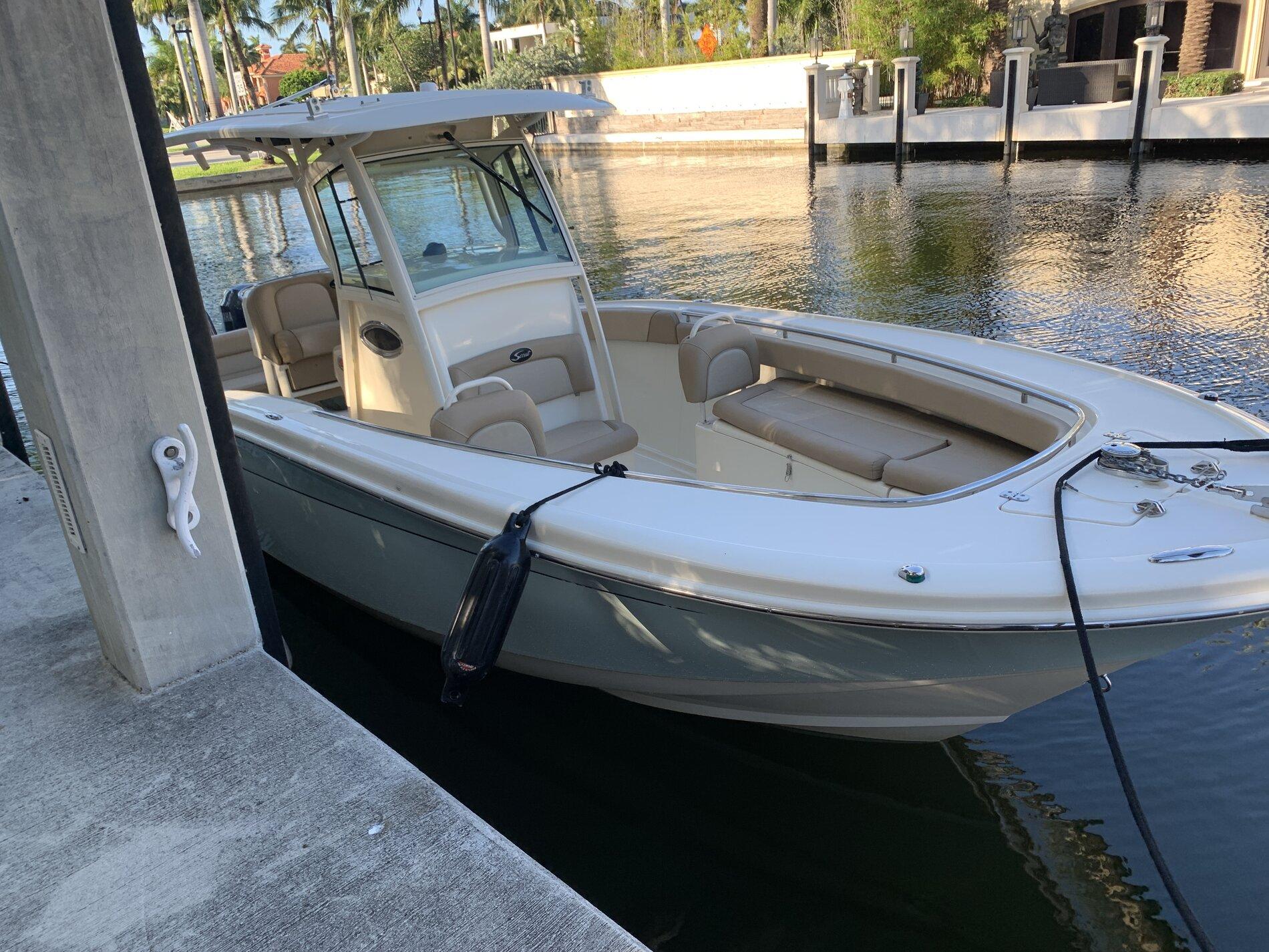

This thread makes me want to get a trailer for my 26 foot Scout and tow it to the keys with my gladiator. Just towed a 6000 plus pound trailer this weekend with no issues at all. Used a weight distribution hitch though.

Very sweet boat...
