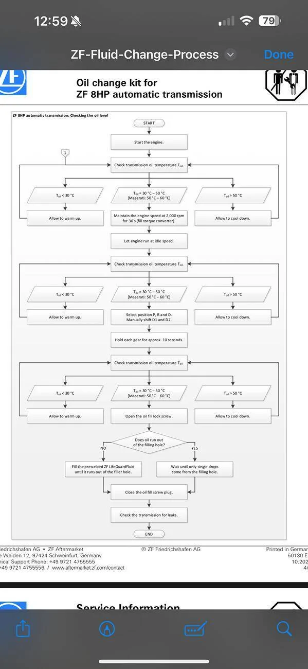

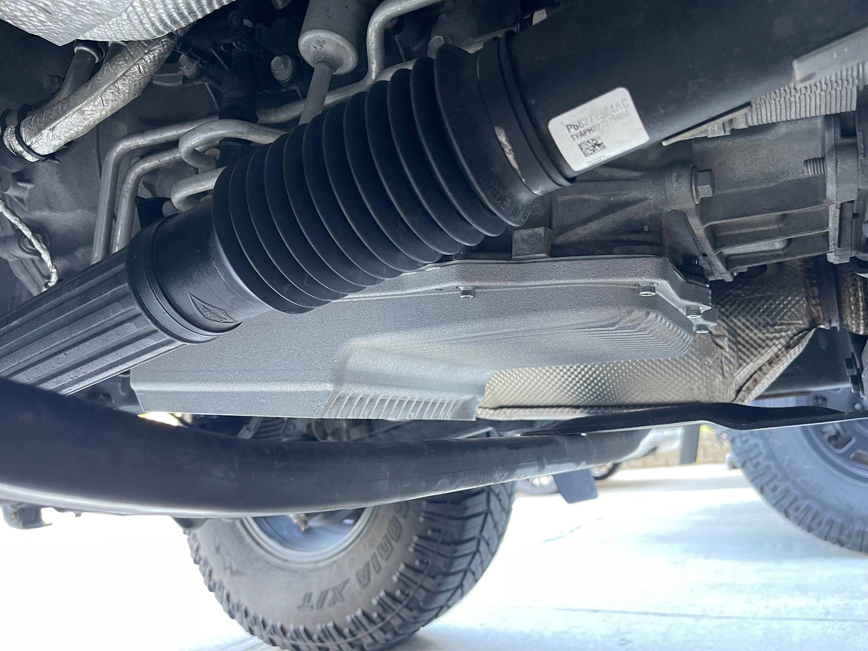

For those interested, I got the ppe pan installed this past weekend. The pan is very well made and cleared the exhaust just fine. Just make sure you get the pan that is made with the exhaust clearance.
I initially went by ppe's fill directions and had some whining in 1st and 2nd gear. I found more detailed directions on the jl forum someone posted from the manufacturer and used it for my final fill and ended up putting quite a bit more in. All in all I used about 5 quarts and 22 ounces.
I was able to drive it about 4 hours on the highway as well and kept an eye on transmission temps. It would get up to about 190 and back down to 186/188 on the highway. Not sure if that is cooler than normal or what but that's what I observed. Ambient temp outside was about 60f.
One of the great things about this maintenance was that Iam finally rid of a whining that would occur after my transmission would get up to about 180. After it reached that temp I would get a slight whine taking off from a stop. I can't hear it anymore telling me it was low from the factory perhaps?
I have a quart and 10 ounces of oil left so I'll probably order some more this year and do another fluid change to further dilute the old stuff. It's a shame it's not easier to get more old fluid out just doing it youself without special equipment.
Here's the fill procedure that was posted on the JL forum:
Jeep Gladiator Transmission oil change with PPE aluminum oil pan 1000007539
Question is the inside of the pan concave where the exhaust clearance was on the inside of the Pan ?
No. The clearance is just the fins cut down to give the exhaust more room.
