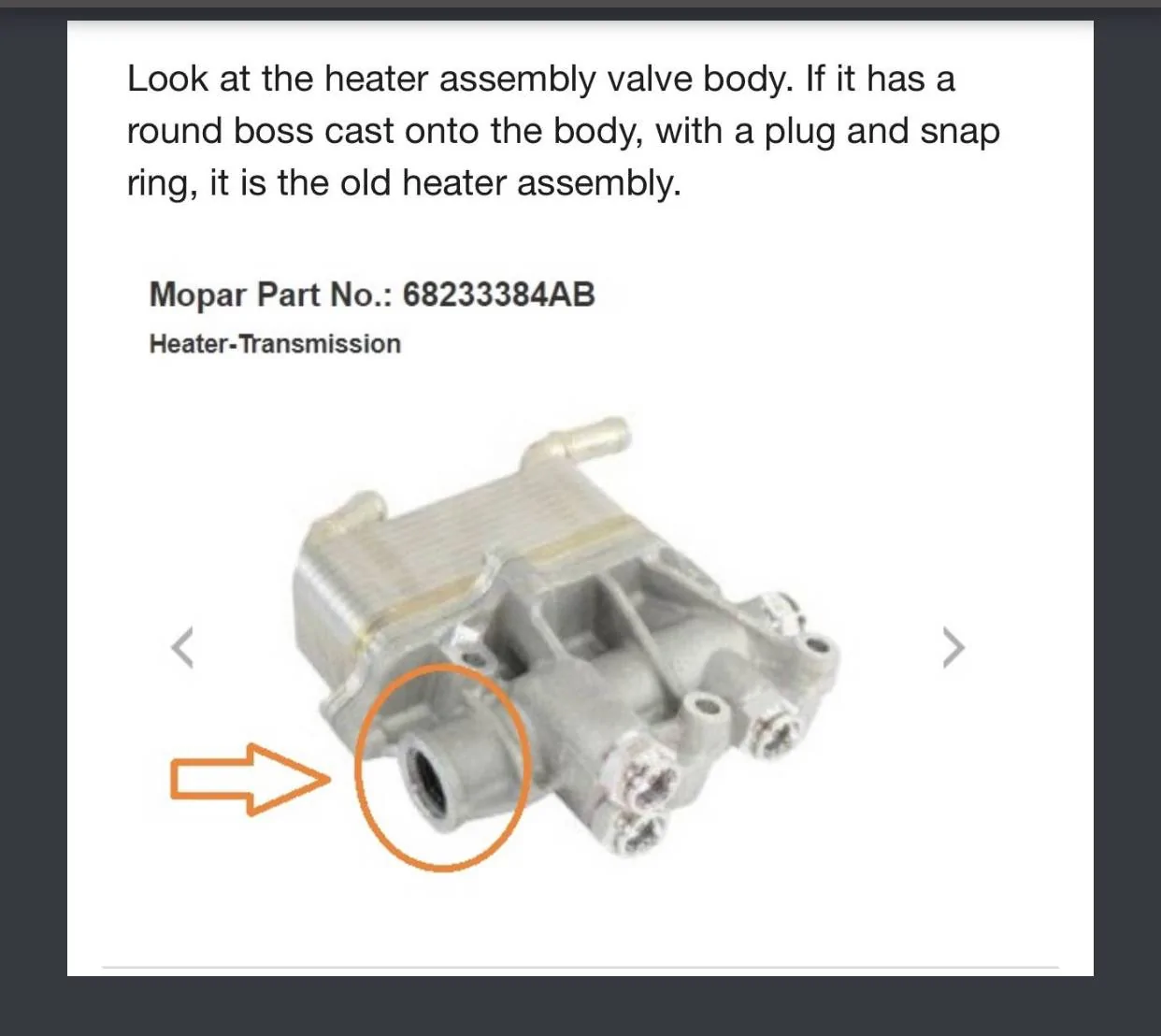

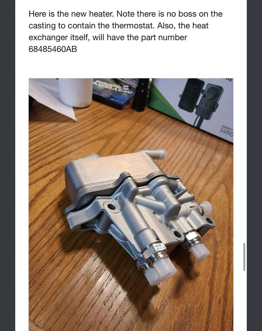

The newer 8 speeds have deleted the transmission thermostat. FYI
So, trying to understand the two pics…the old one had a thermostat to help regulate the transmission temp,…get it up when cold and cool it down to coolant temps if too hot and the newer one without the thermostat just has free flowing coolant at whatever the engine temp is doing is what you should see the transmission at? Correct? So the thermostat was redundant and they engineered it out.

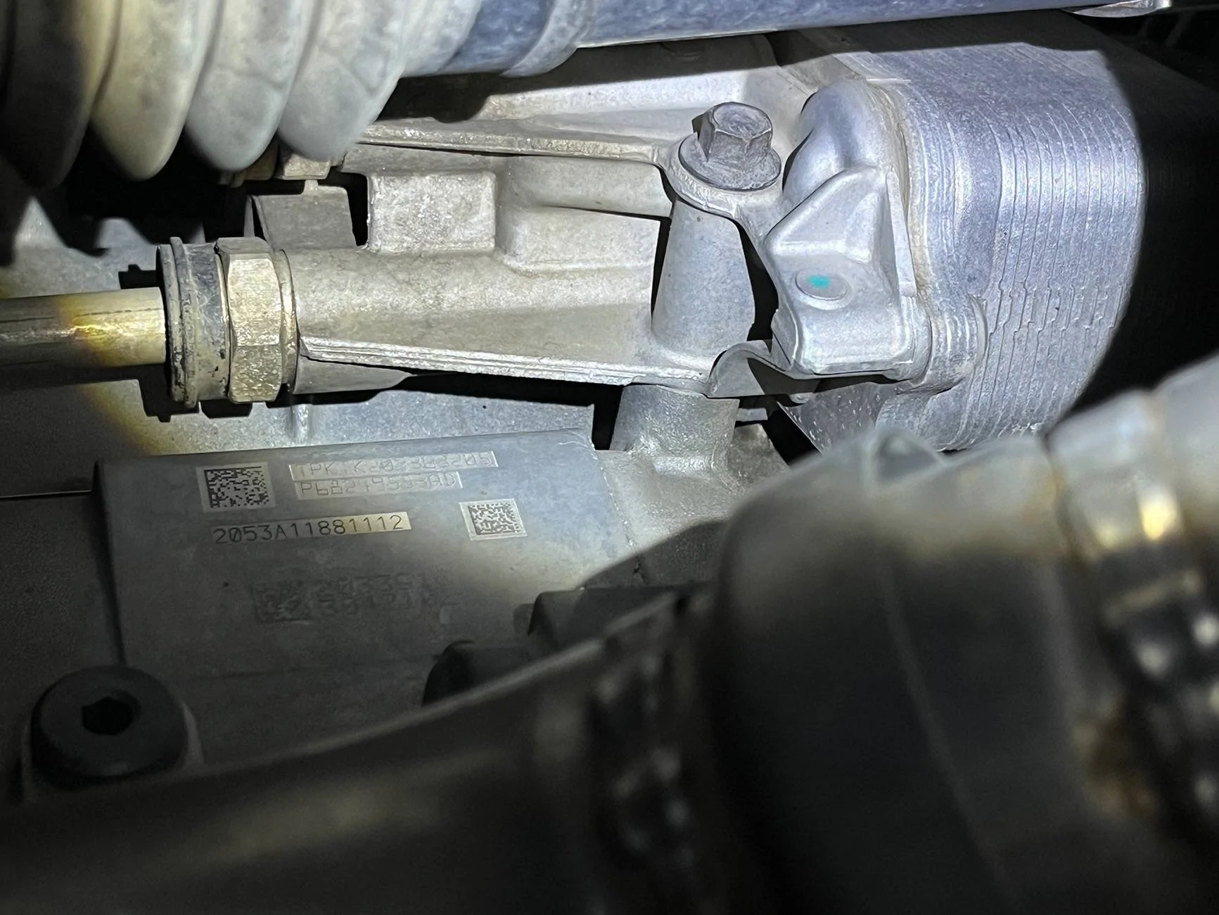

I guess I have the new design…
So hypothetically speaking, should we all be seeing our transmission temps match our coolant temps? I mean our transmissions not only get help from the engine coolant temps to raise the temps but we also have 30” of exhaust pipe helping out too.
I would like to know if having an exhaust shop
lower or reroute the y pipe to a different location would be worth the effort?
The transmissions basically have the same heater just different in the thermostat redundancy in the old one
Edit: yes
That could be why ypur transmission is running 5° -10° cooler it has no restrictions. Hmm never thought about this.

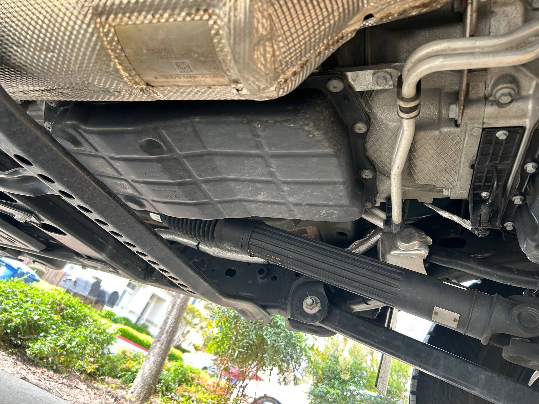

Here's a pic of the diesel steel pan. Plenty of room to for that ZF aluminum pan. Dammit spending more money now. Originally, i was planning on just tig weld a bung on to the steel pan for easier future drains, but that damn ZF pan looks sexy af. I've seen my trans temp up to 225* during a slow 11,000ft climb.
