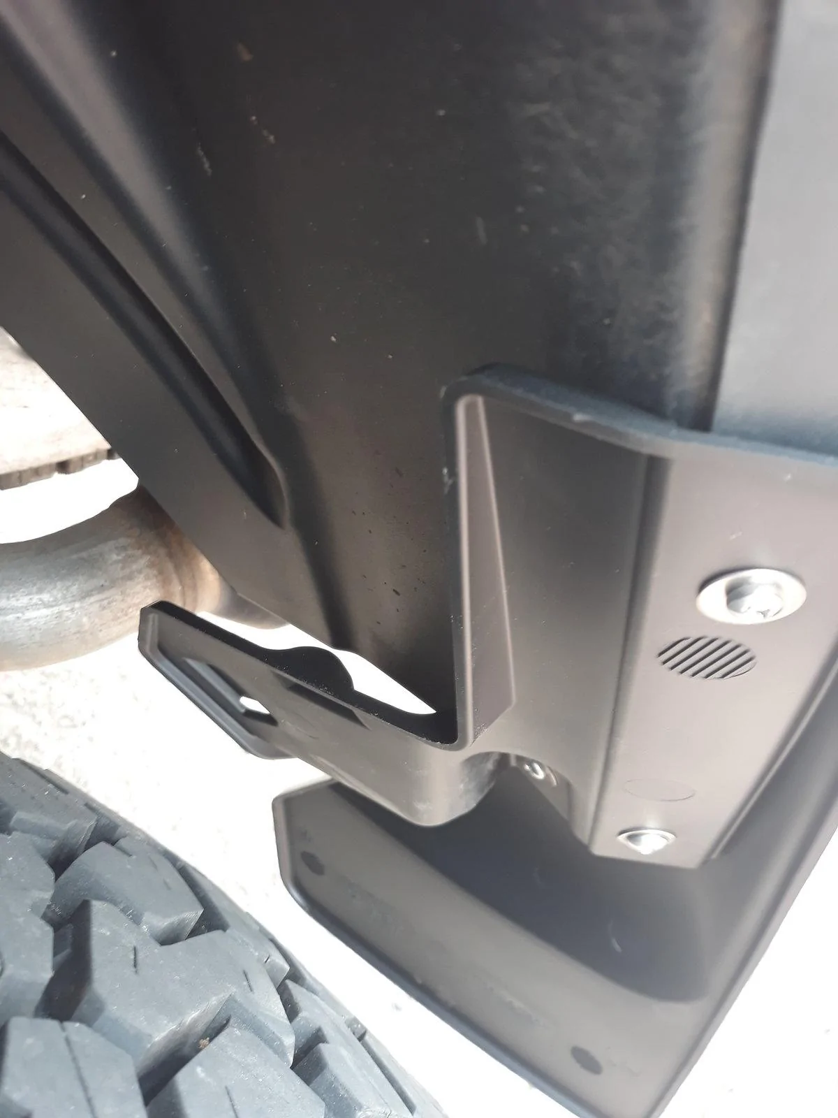

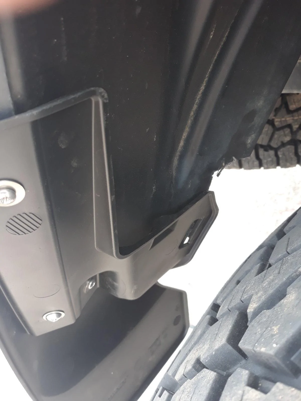

I got the sport S flaps. The rears are garbage. The instructions say to slip the liner into the tab on the flap. Liner is way too big. Had to trim the liner on the passenger side. The drivers side i said fuck it and installed straight on. I ordered the sport S, not sure if there is a differant flap for the rears, but the ones sent really are not designed right. if i hadnt already cut the liner and installed (hindsight) i would have contacted weathertech and asked wtf
Strange....did they send you the right ones? Mine went on like butter on my overland.
