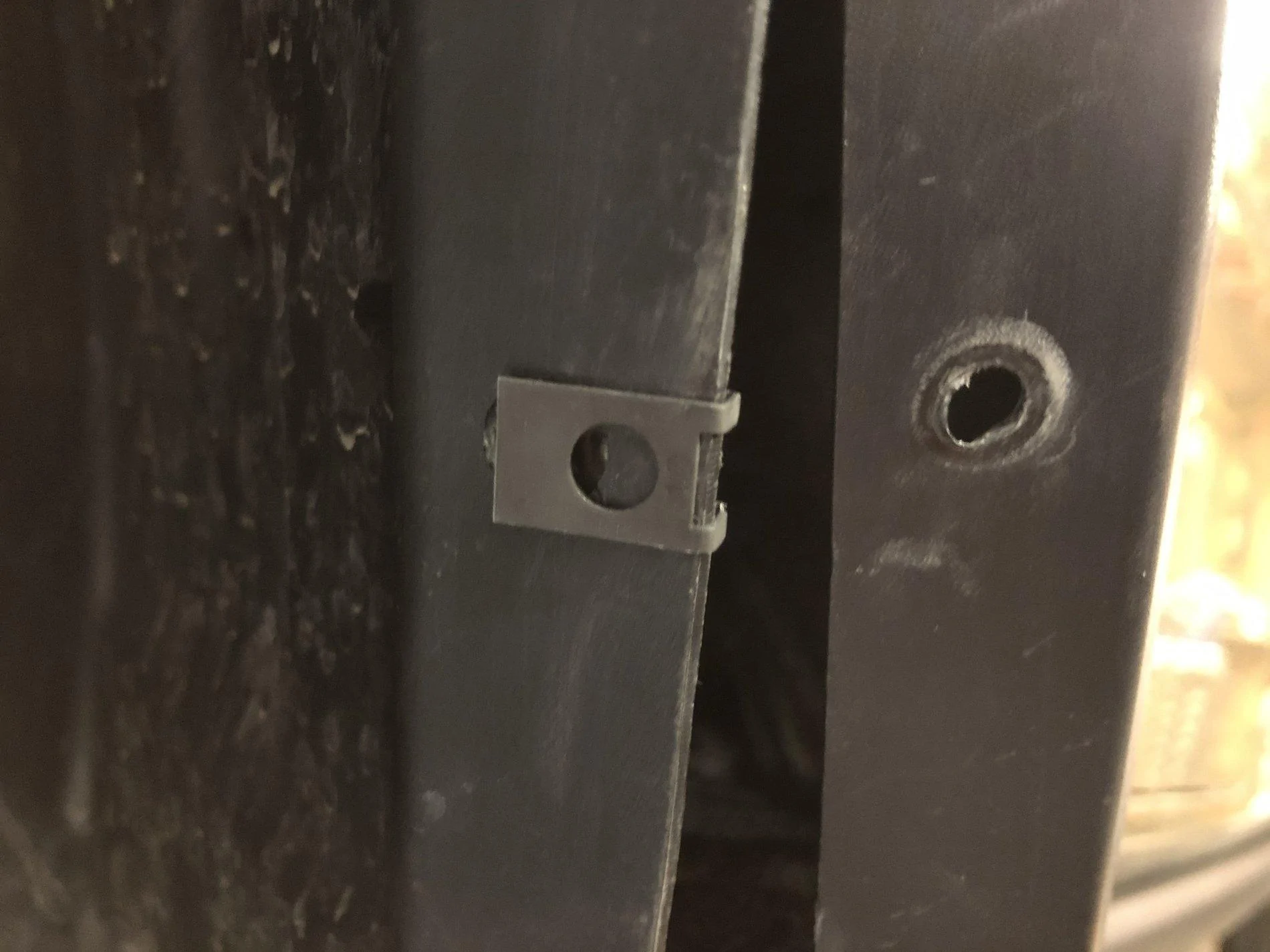

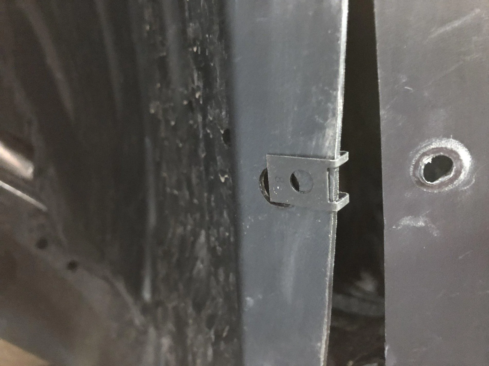

Is anyone seeing this trying to get the top clip to go on the inner fender? The clip just doesn't seem to be long enough (none of them do.) I emailed WT about this thinking I got the wrong hardware kit and they shipped me out the exact same clips that I already had.
I had the same problem with the front mud flaps. I don’t like those clips. They could give bolts and nuts for the front one ā€˜s also. The rear’s are A1

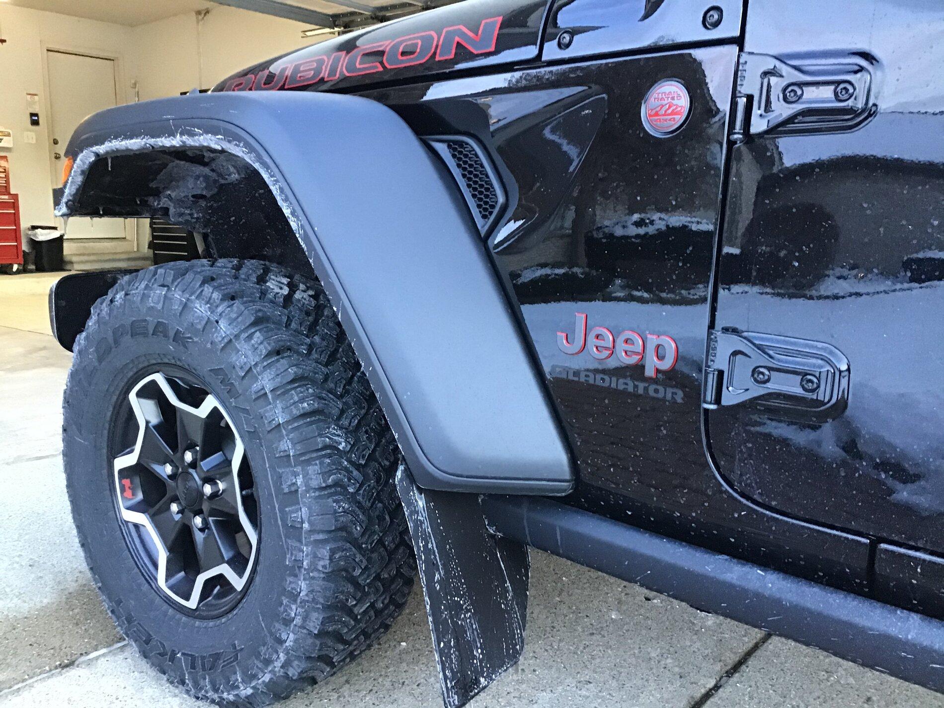

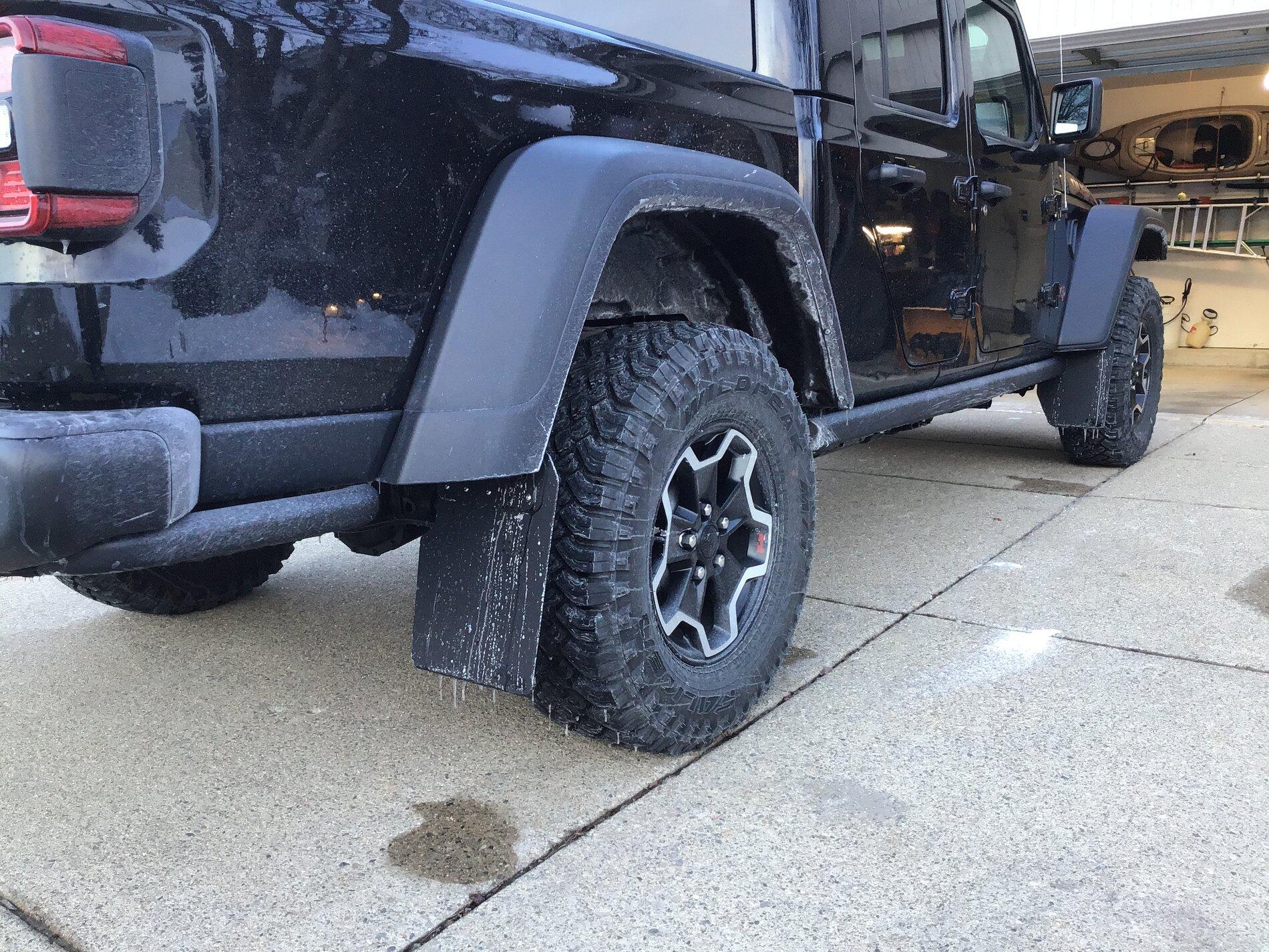

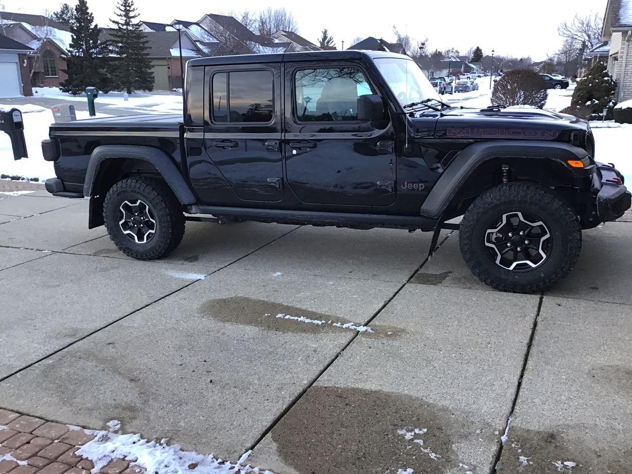

My concern is the Jeep factory flares on the Rubicons are mounted to the body higher for increased clearance.
Since the WT mud flaps also mount to the fenders, will the WT Rubicon version hang too low (and the molded cut-out not line up the rock rails) when mounted on a Sport.

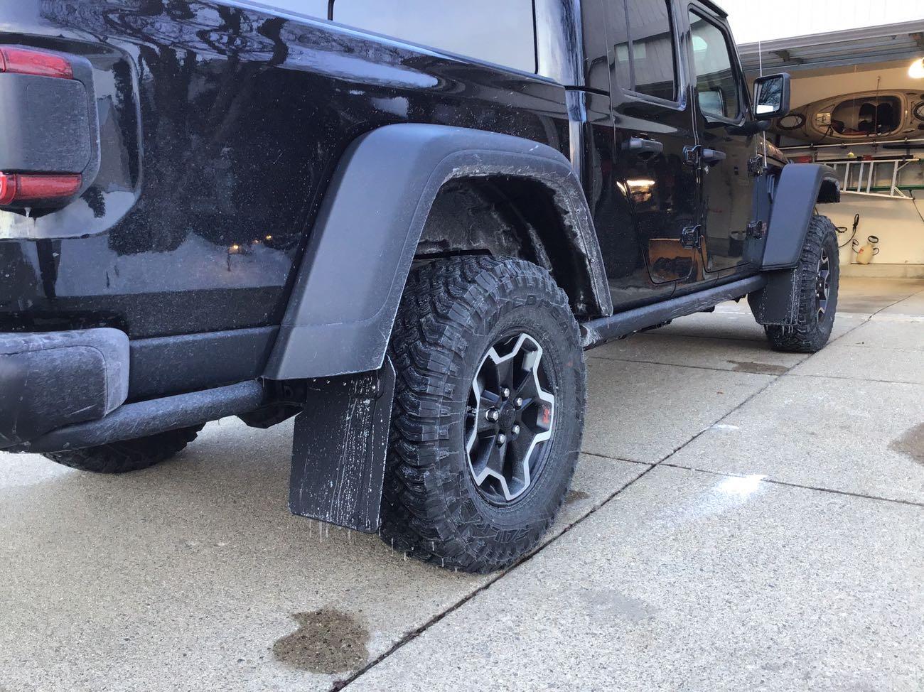

Just installed the Weather Tech mud flaps on my JTR and am very happy with the results. At less than $100 delivered I can’t complain. I’ve had these on our last two vehicles.

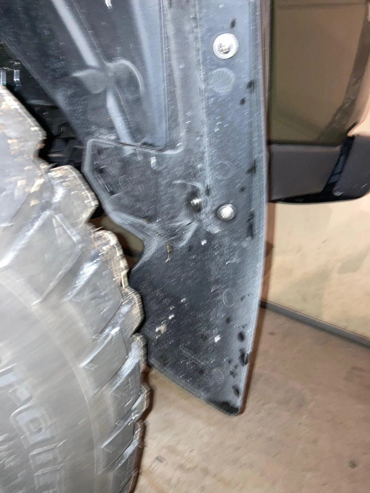

Just received my set today.
Looking over the parts and instructions, I am wondering if it would be better to use OEM type plastic rivets?
I have the gun and rivets from putting OEM type flaps on my JL.
Ogre_FL
Nov 9, 2020
446
778
Cooks Bayou, FL
Wranger JL 2 Door, Gladiator 80th

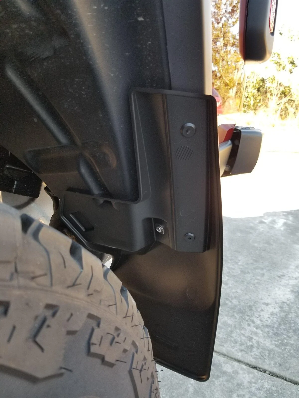

I ended up doing a hybrid installation.
Every fastener they provided that was stainless I used, which actually was only one per flap.
I replaced all the carbon steel stuff that could rust with OEM type plastic rivets.

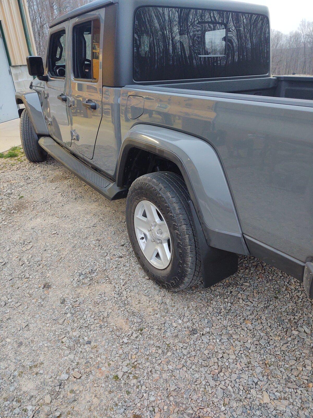

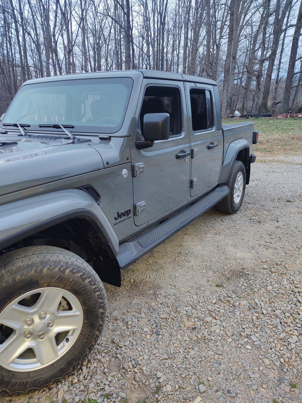

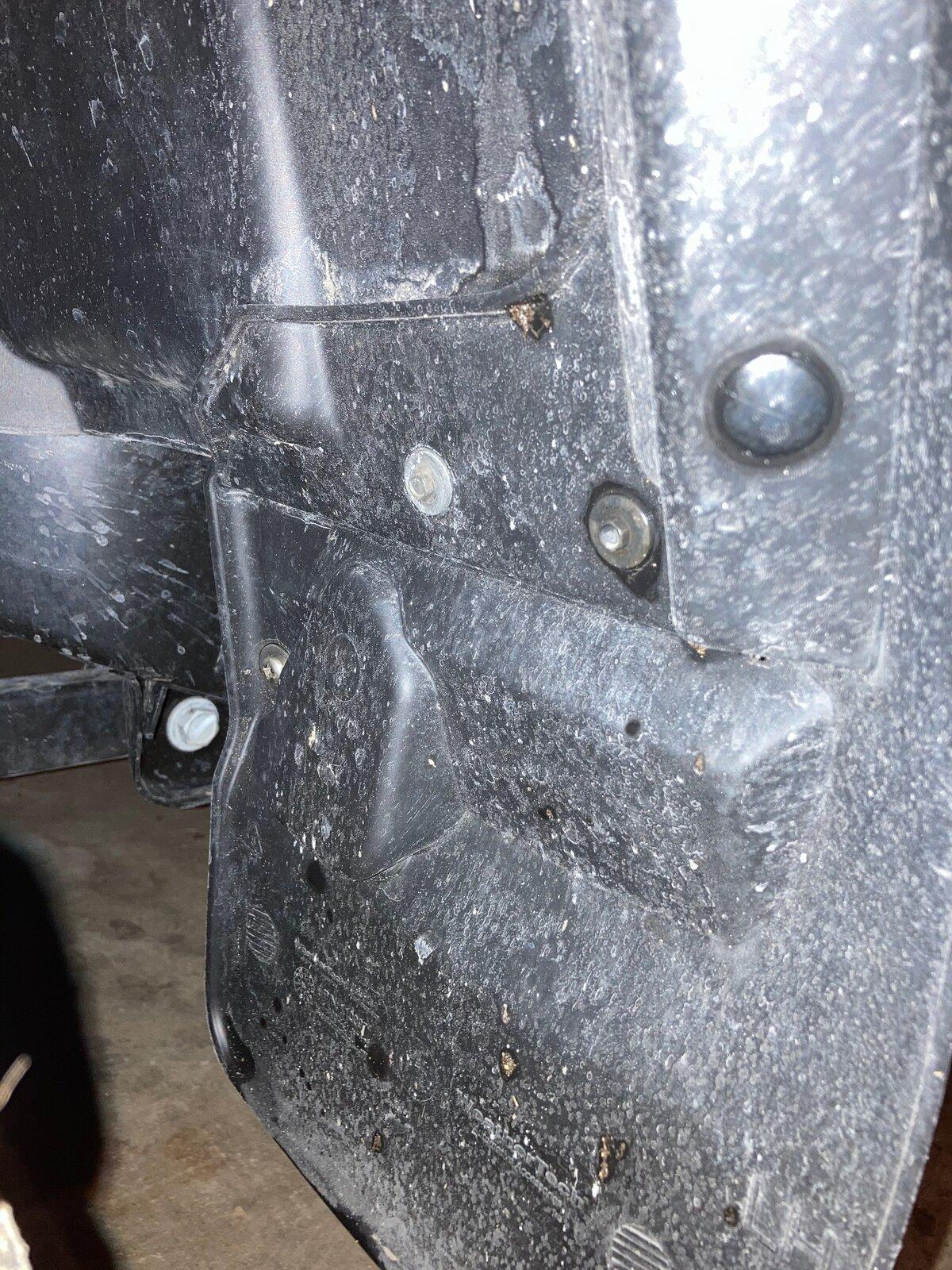

I got mine installed today. There were two different size clips included with mine. The longer top clips lined up perfectly. I think Weathertech is finally including the correct clips for these. I also found that drilling the center out of the outer plastic rivets was the easiest way to remove them. I tried pushing/hammering the center pin in and was not getting anywhere. Drilling them out was fast and easy. Overall the install was easy for the front and back, with the back being super easy. I am happy with the way they fit. If I had a complaint it would be that I wish you could order the fronts without the molding for the rock rails. It is not a huge deal, but I don't have rock rails, and feel like they would look better without the molded hole for them.

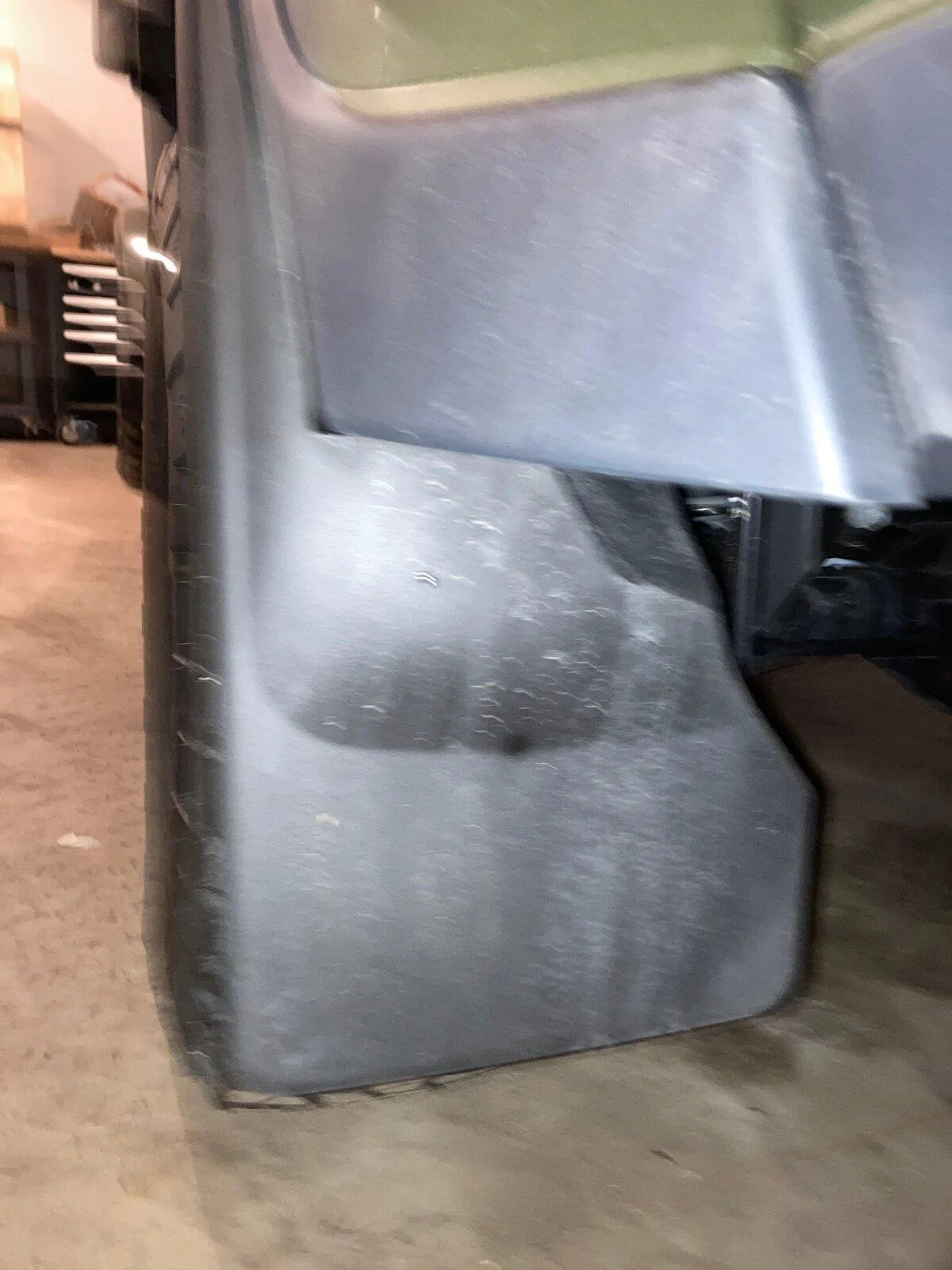

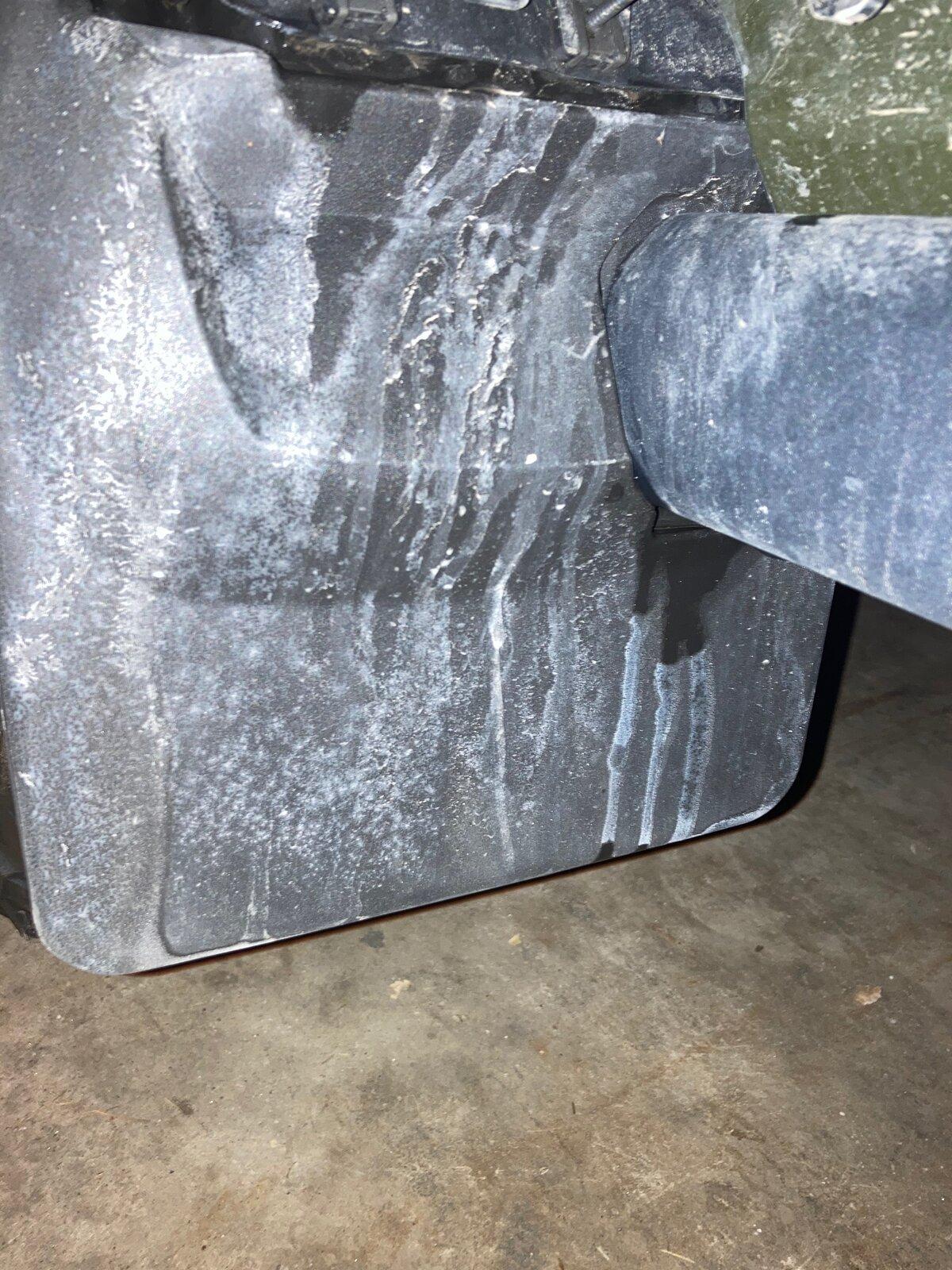

Pictures attached of driver's side front and rear, inside and out. The front flaps are notched for the rock rail - not a hole like the Rokblokz, but a molded indentation. Of course there's no rock rail adjacent to the rear flaps. Use the model numbers that I provided and they'll work perfectly for your Willys.
