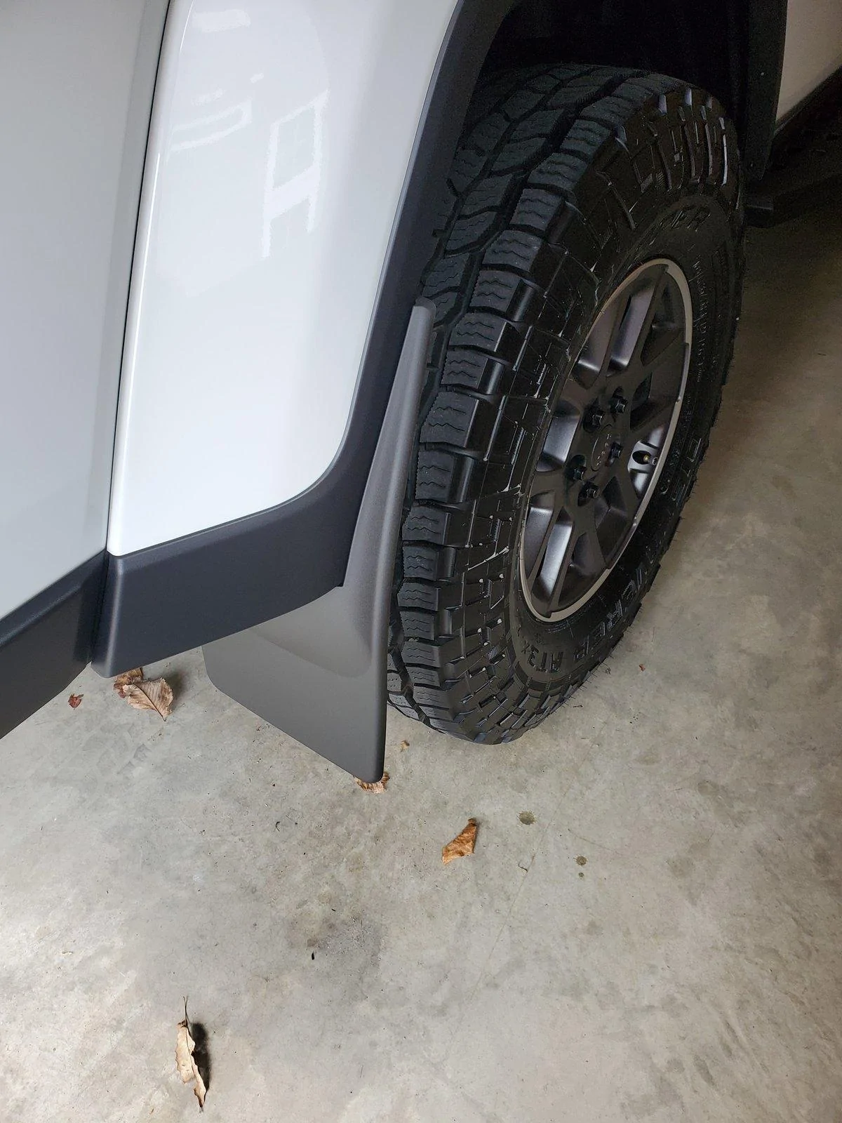

Is yours a Sport S with Max tow? Are these Sport, Sport S mud flaps?
I got my Rubicon Flaps to install on Sport S, Max Tow with Rubicon Rock Rails, but am having a hard time getting the bottom two screws to catch the clips. I loosened up the Rock Rail bolts to see if it need to slide toward the rear more and that hasn’t helped.
Does anyone know if the Sport S mud flaps have a depression for the rock rails like the Rubicon flaps do?

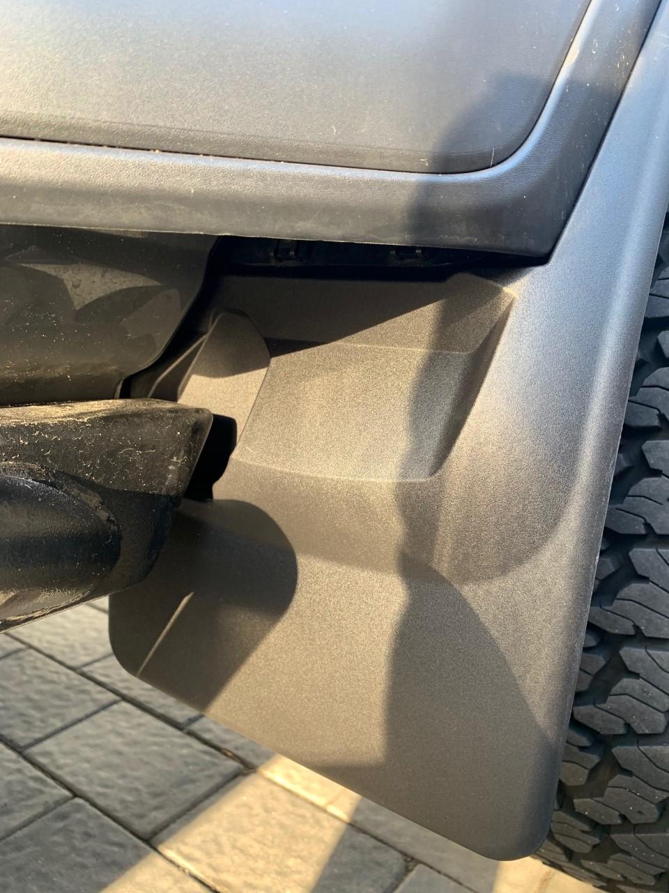

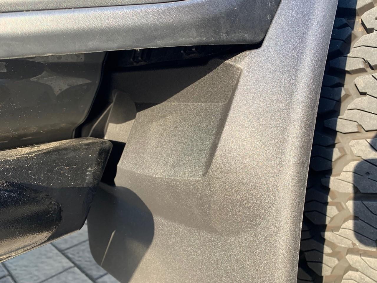

I have the Sport S Max Tow - and yes the mudflaps have been molded for both the rock rails and the steps - there are depressions for both. These were ordered from WeatherTech for the Sport S - they don't have an option impacting Max Tow
Thank-you. You have the same vehicle configuration as I do so now we know, get the Sport S Weathertech mud flaps.
FYI for others......
the Weathertech Rubicon front mud flaps do not fit the Sport S Max Tow fenders.
the Weathertech Rubicon rear mud flaps don’t come close to fitting the rear Sport S Max Tow

So there were couple questions on if they were molded for steps / rock rails - I took a couple closer pics to show you - Inner molding holds the rockrails - Outer molding is aligned for the step option for the Sport S -

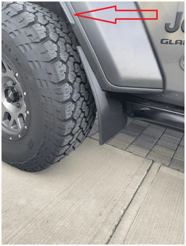

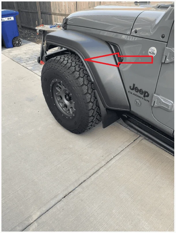

What is this extra "lip" on your flares? Mine isn't like this....

Mine are smooth on the outside. Like this:
Those are the Max Tow Fenders - that lip is used in conjunction with the wider axle stance. - Factory fenders btw
Yep, my Max Tow has same lip on fender.

AHHHHH!!! Makes sense. I've never noticed that until just now....

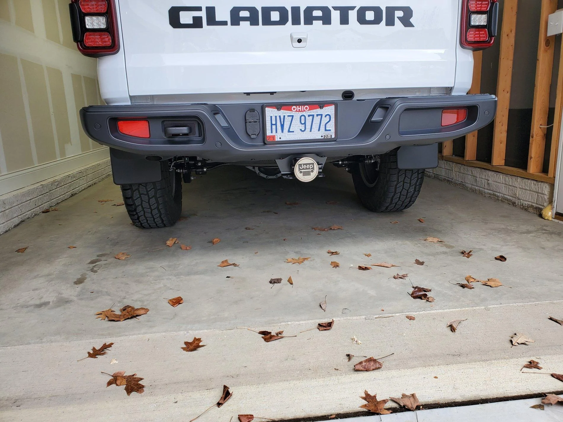

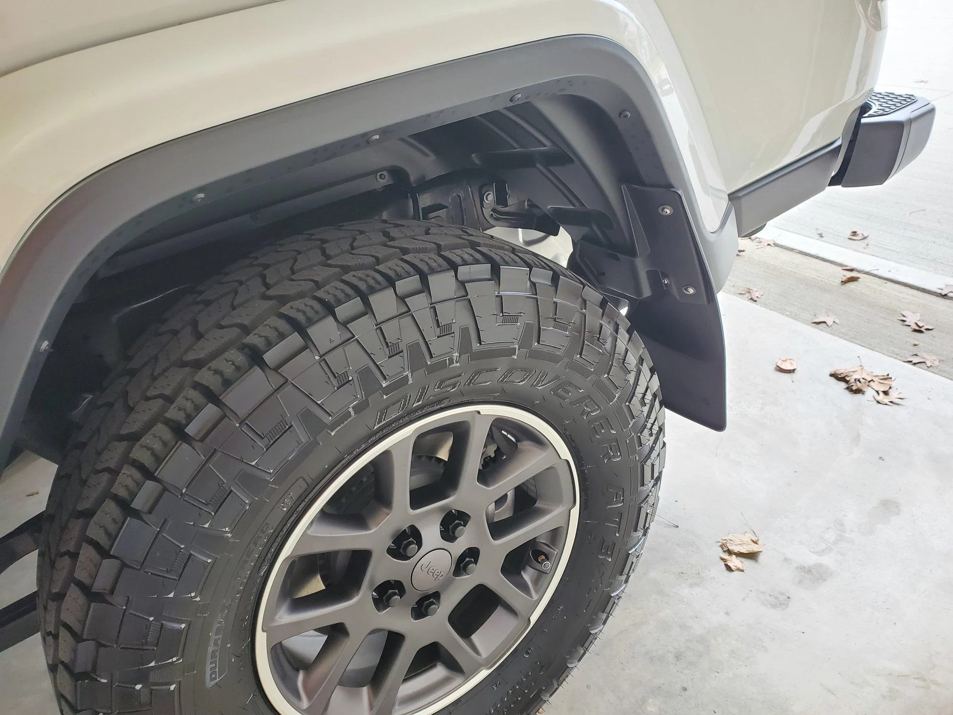

FYI, the rear flaps for the overland were just recently released, mine come tomorrow will let everyone know how they are.
Update: Just put the rears on. Install was q breeze, 15 minutes tops, don't have to mess with rivets like the Mopar ones either. I'm pleased with them it bugged the heck out of me to only have them on the front so was pumped when these were released, I've always been happy with weathertech products. One thing that does irk my OCD is the silver bolts.....which is ironic because the nut on the backside is black. Probably going to swap out the hardware at some point
