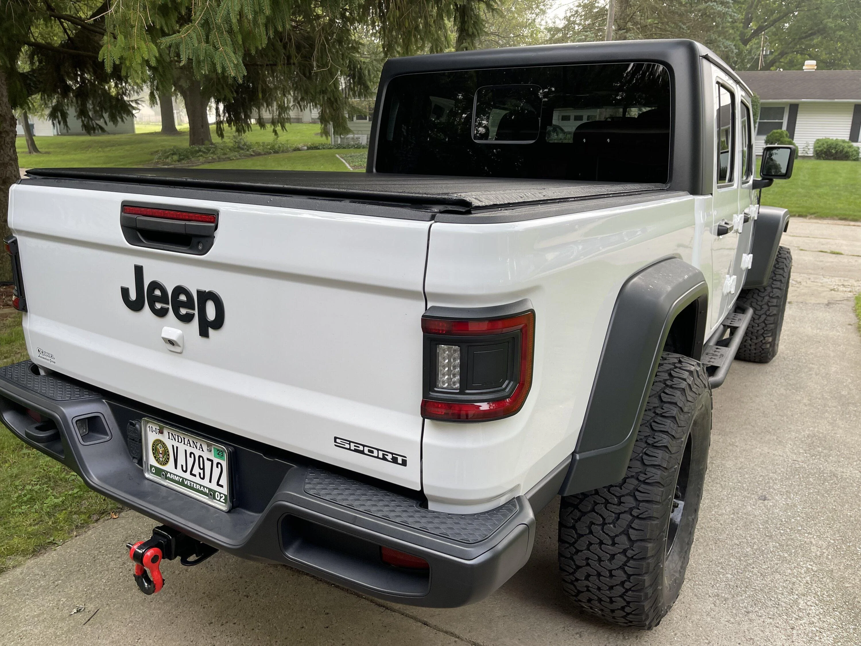

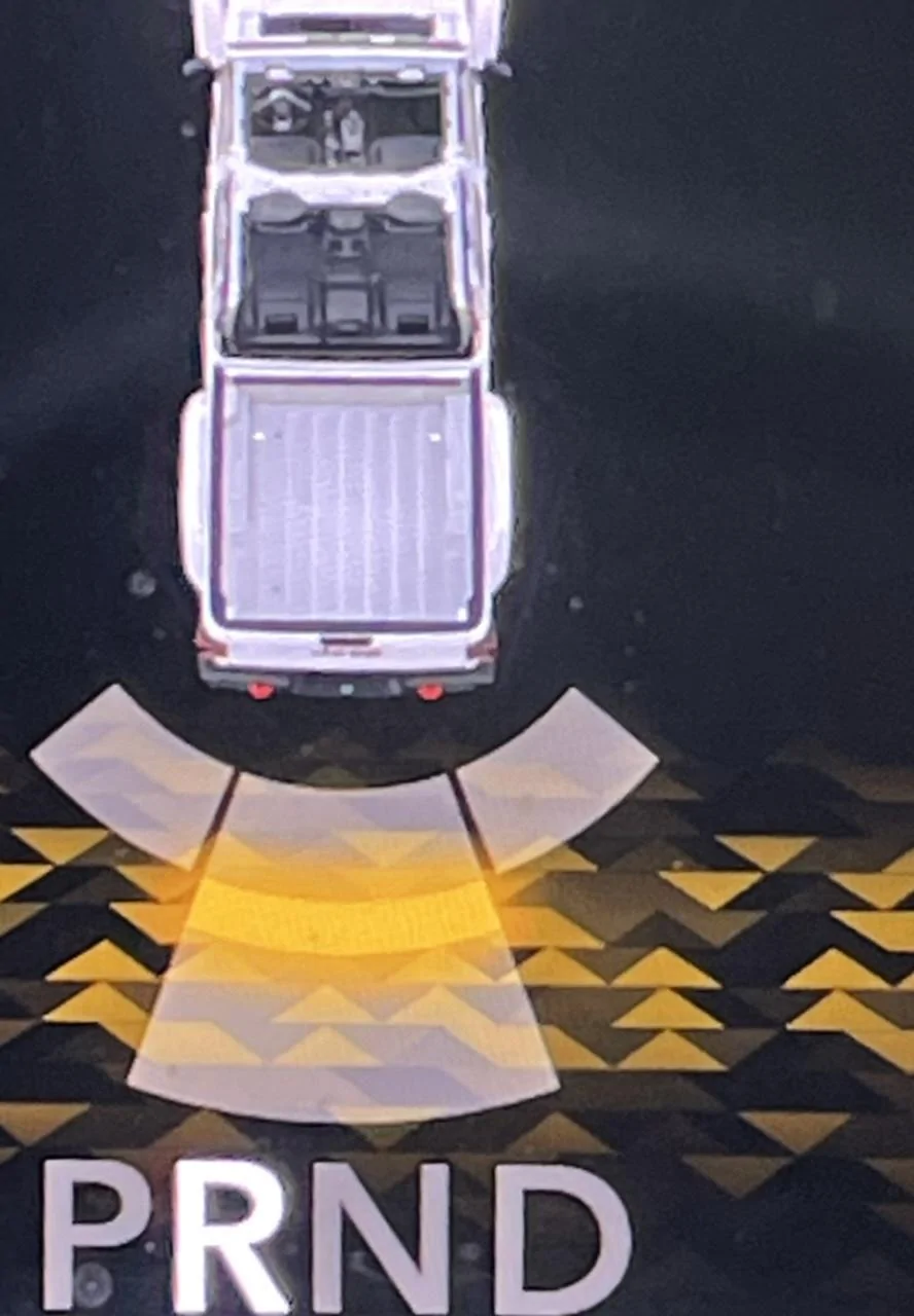

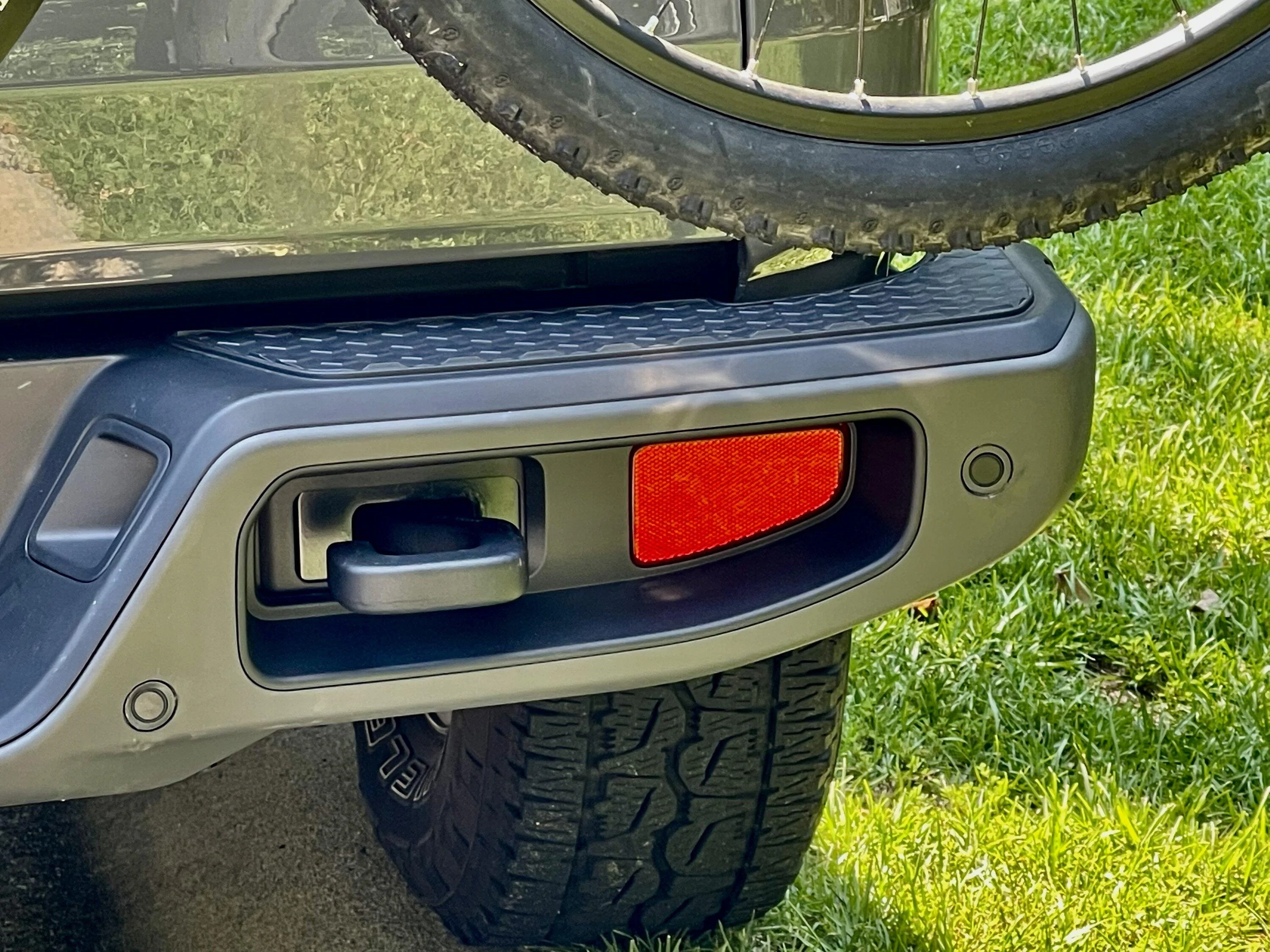

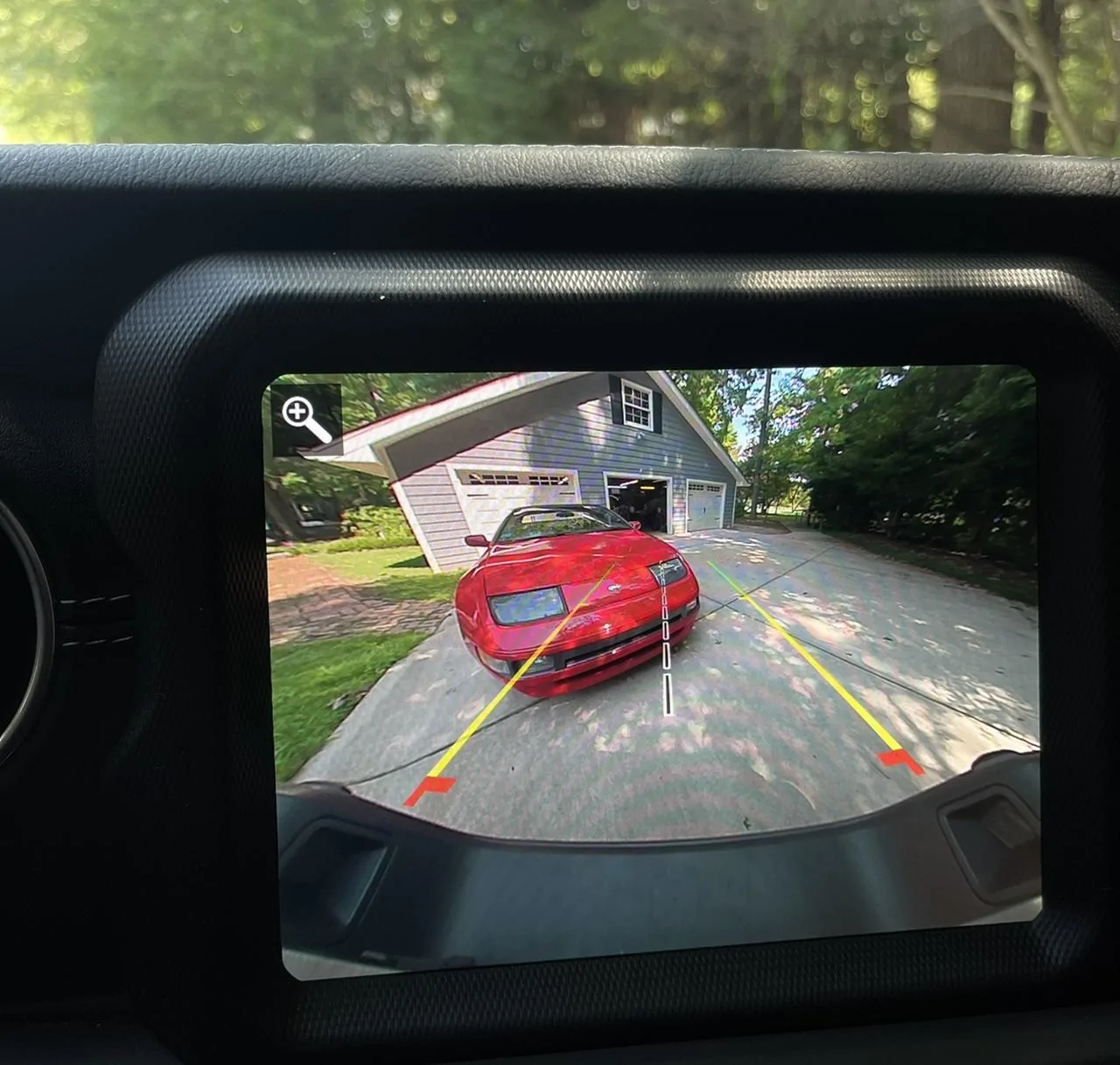

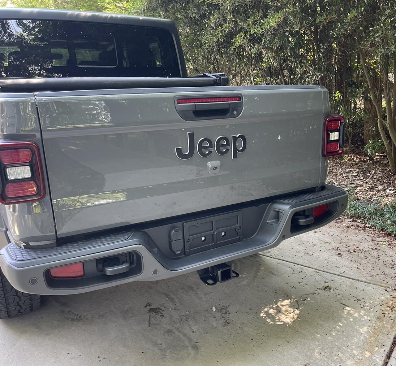

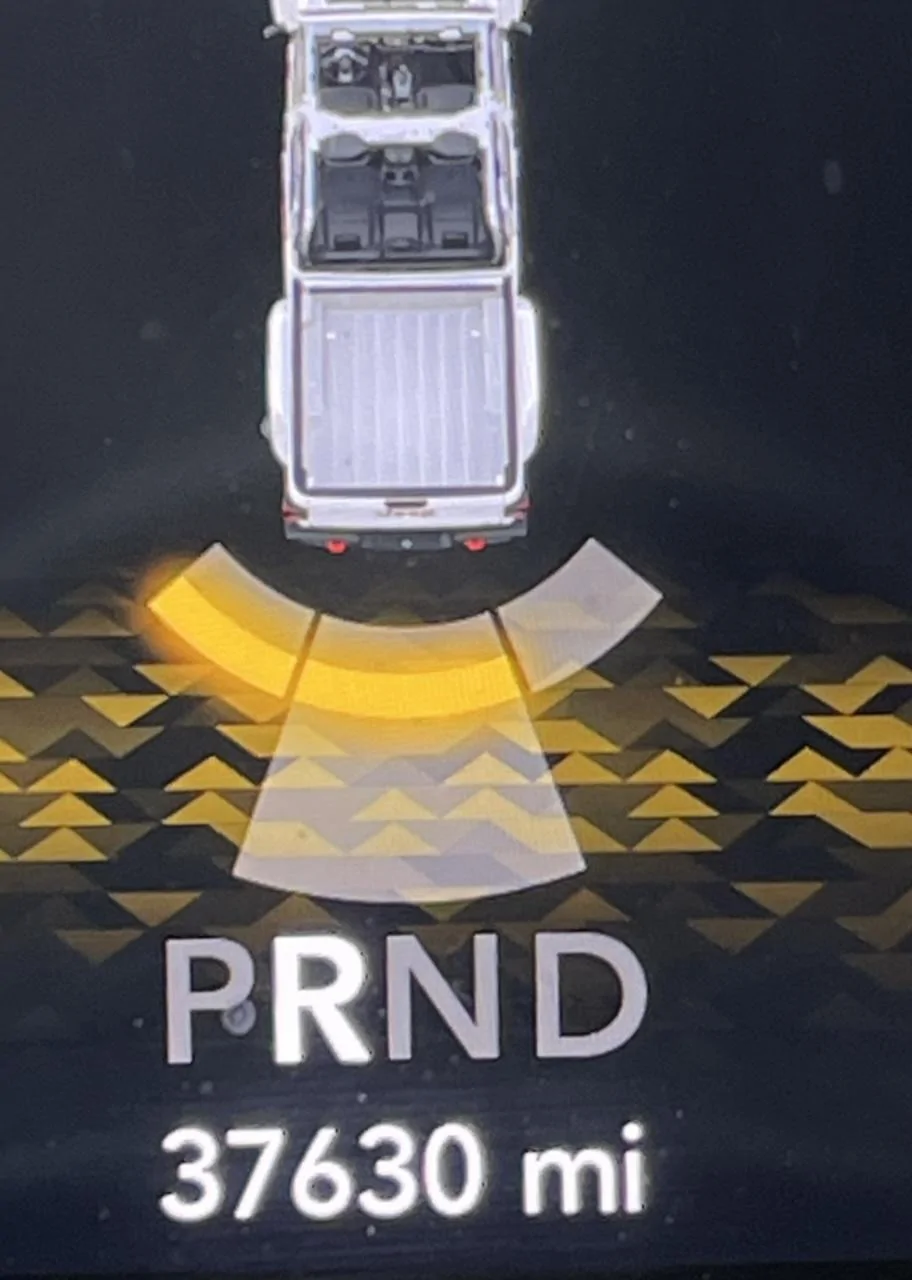

Replaced my damaged rear bumper and added a second tow hook. I used a non rear sensor bumper cover but I was able to cut the sensor holders off with a utility knife and a gasket scraper and attach them to the new (to me) bumper with JB weld. Everything works great and I’m pleased with the look. $50 for the bumper and $10 worth of spray paint. I have to touch up a few places I marred up when reassembling before the paint fully cured, but no worries, I’ll touch it up and put satin clear over it soon.

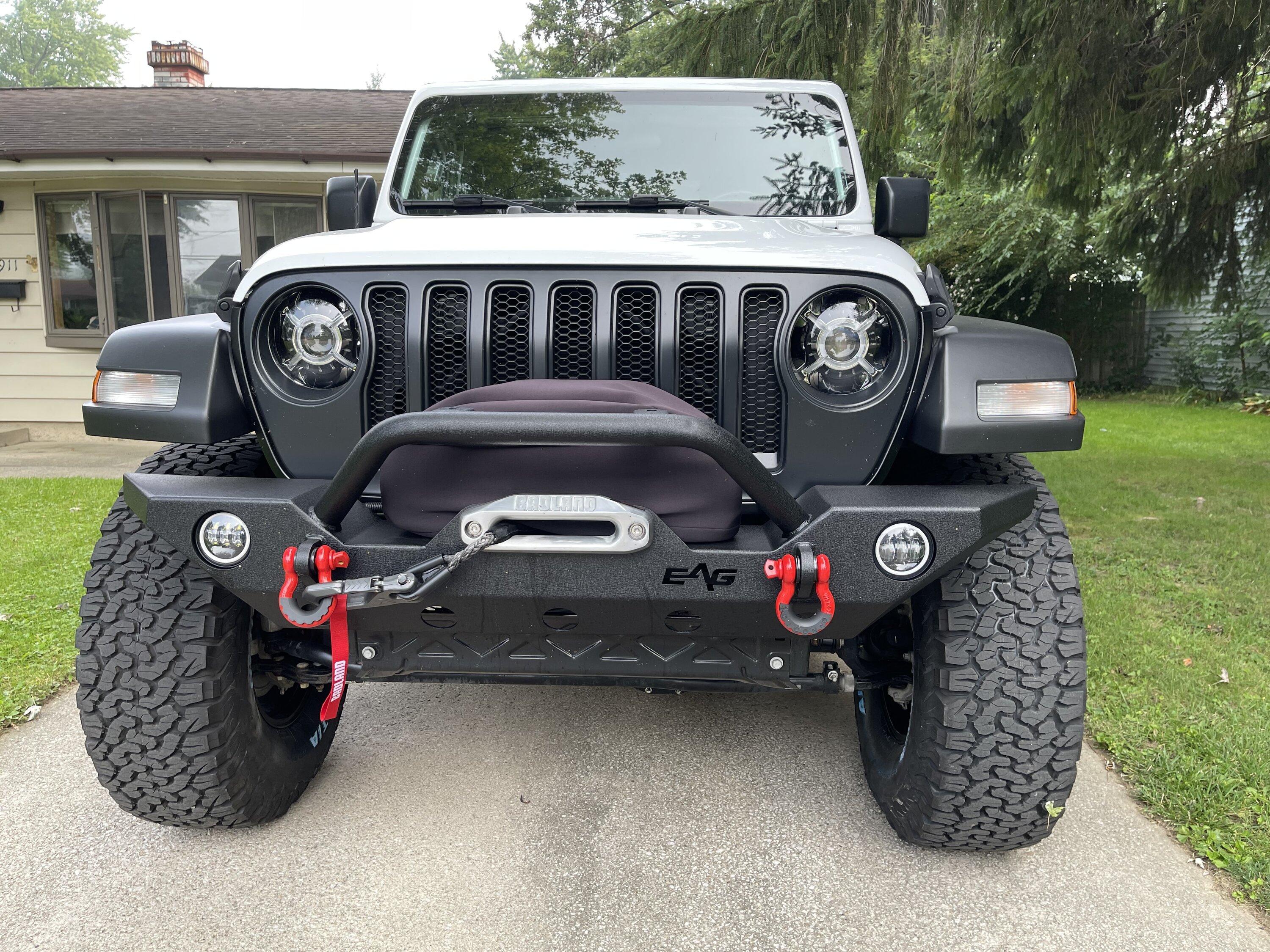

I ended up doing a color match on the front piece. I really like the look in satin gray. Not having the second row hook has been bothering me too. Symmetry is a thing in my brain. I like the look so much, I’m going to do some similar to my front bumper.
If you do this and have parking sensors, lay the sensors and holders out how you removed them and reattach the same way. It won’t work right otherwise. Take lots of pics too to aid in the reassembly. Especially, the wiring and where the clips go.

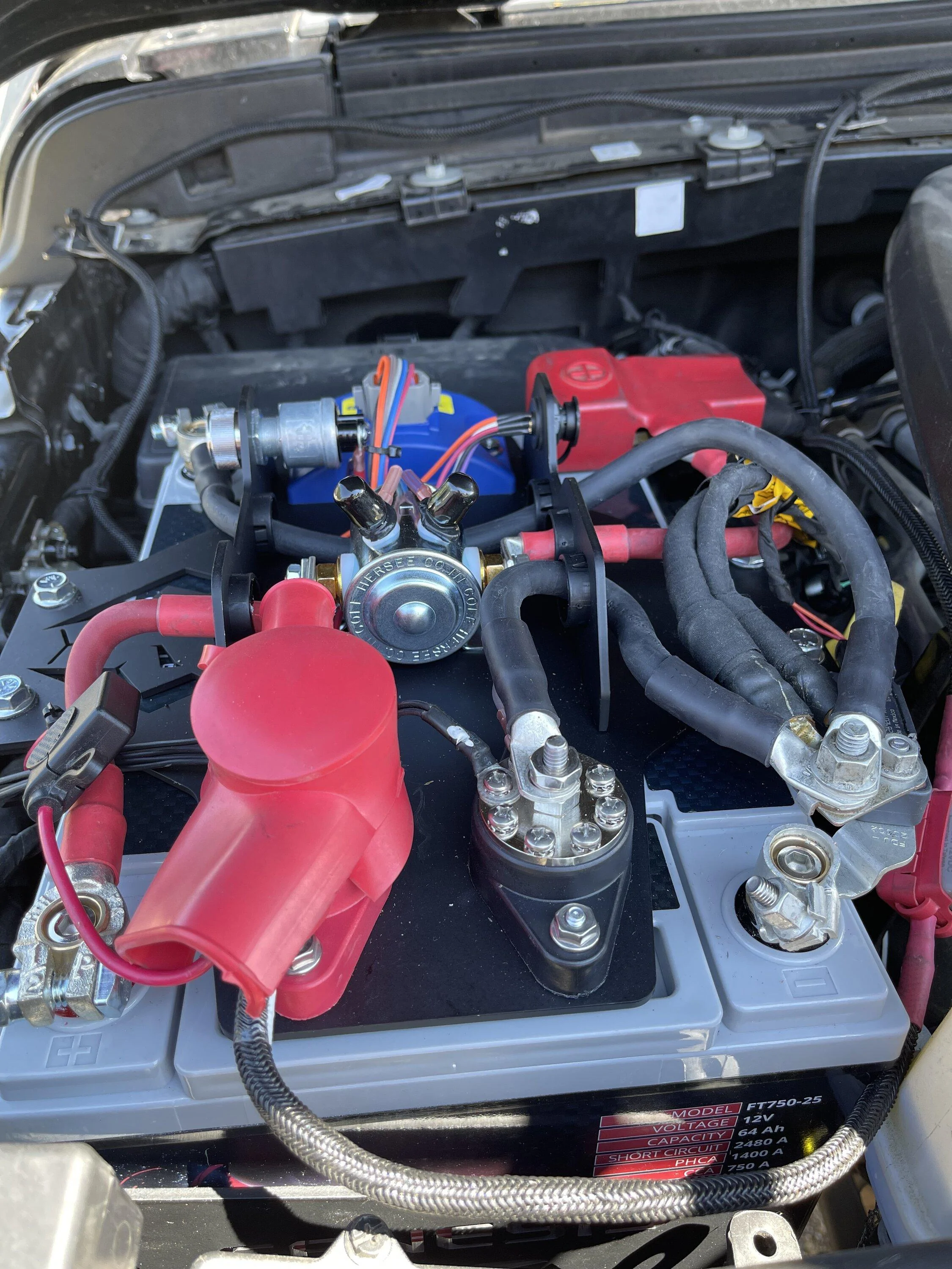

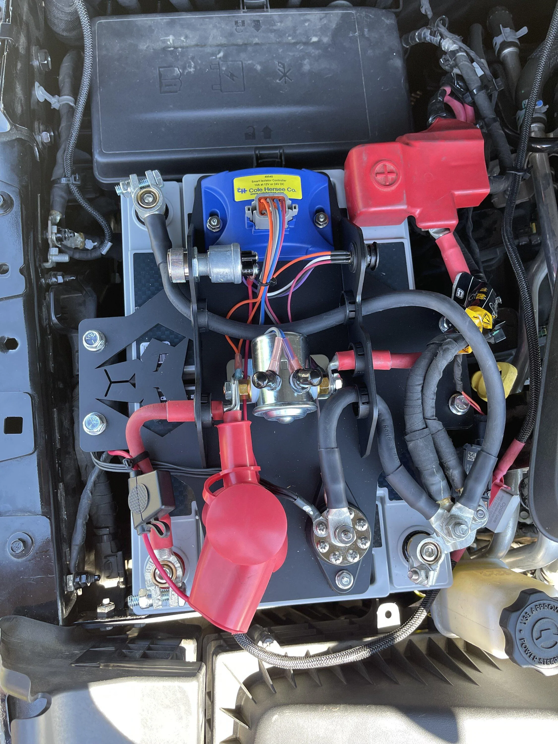

Installed a Genesis dual battery system.
This is what it does
It Isolates the batteries when the voltage on the main battery drops too low so that the cranking battery can still start the vehicle. You can also jump a dead battery with the secondary battery It ties them together electrically for a short time to jump it. It replaces the small start / stop battery under the fuse box. Great for people with heavy accessories like a fridge who would like to run them at the camp site on the battery or anyone experiencing battery issues who wants to get rid of that ESS battery that's under the fuse box. I opted for the Full Throttle AGM batteries when I ordered the system. Not an easy install but anyone can do it by following the step by step install video on youtube.

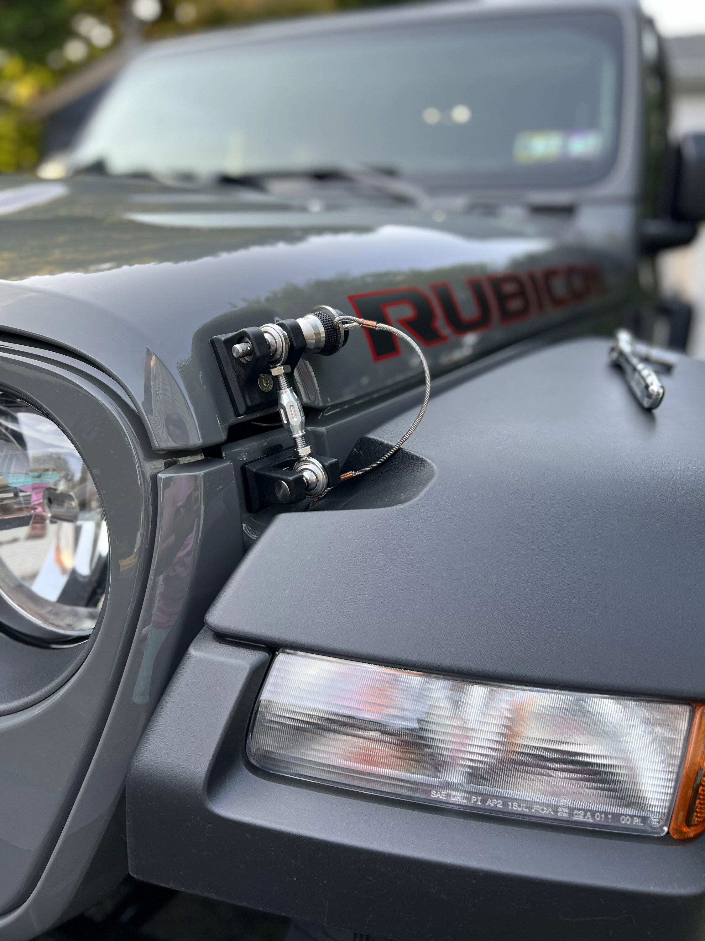

I ordered a locking hood latch for my 2021 JTR that's compatible with the front camera. You don't have to modify the front grill in any way and it will inhibit thieves from stealing your batteries and other parts in the engine bay. It will automatically open & lock with your Jeep Key fob
Lasfit Stealth Anti-Theft Automatic Hood Lock for 18-22 Jeep Wrangler JL/JLU and Gladiator JT
Jeep Stealth Hood Lock for Jeep Wrangler JL Gladiator JT Key FOB Control -Install Guide - YouTube

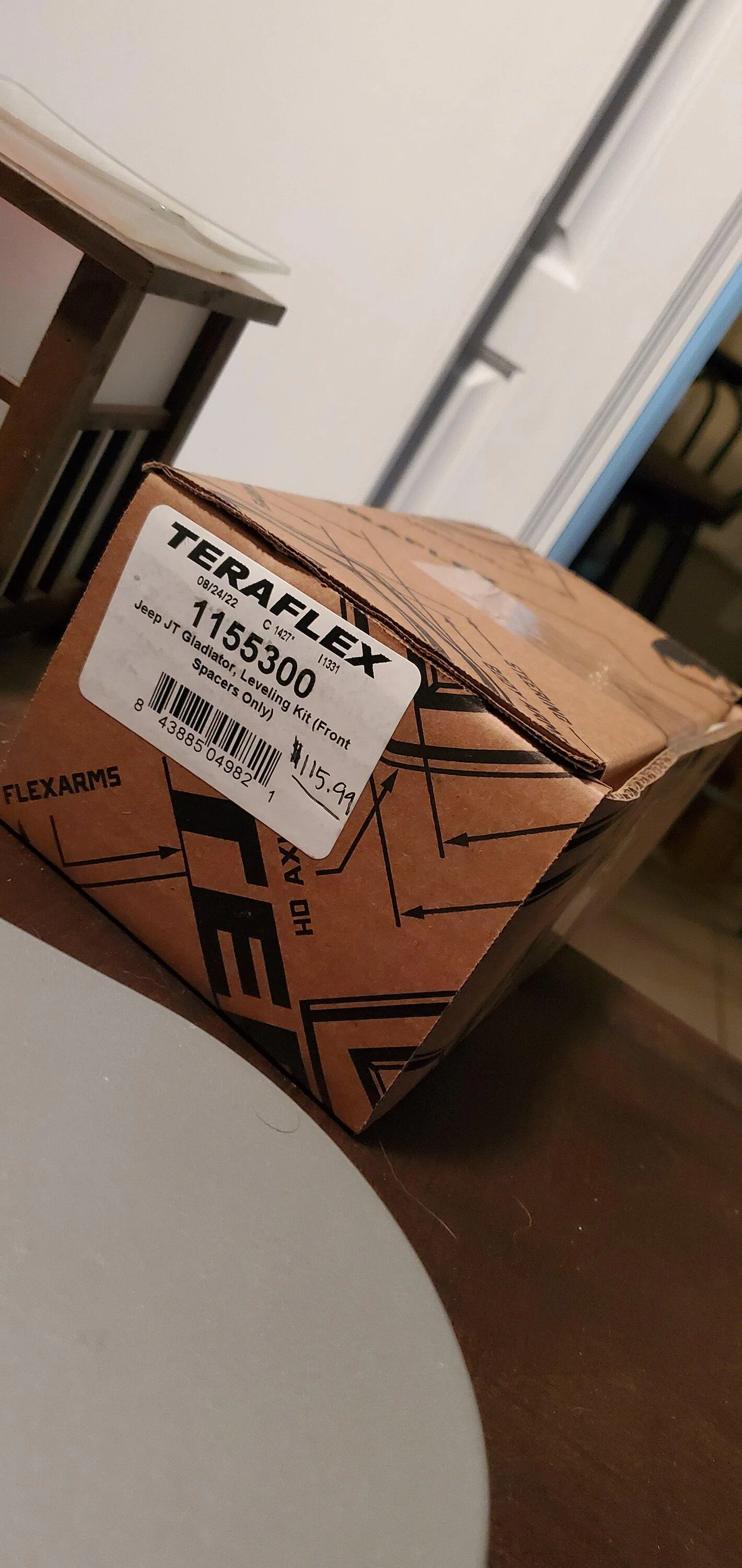

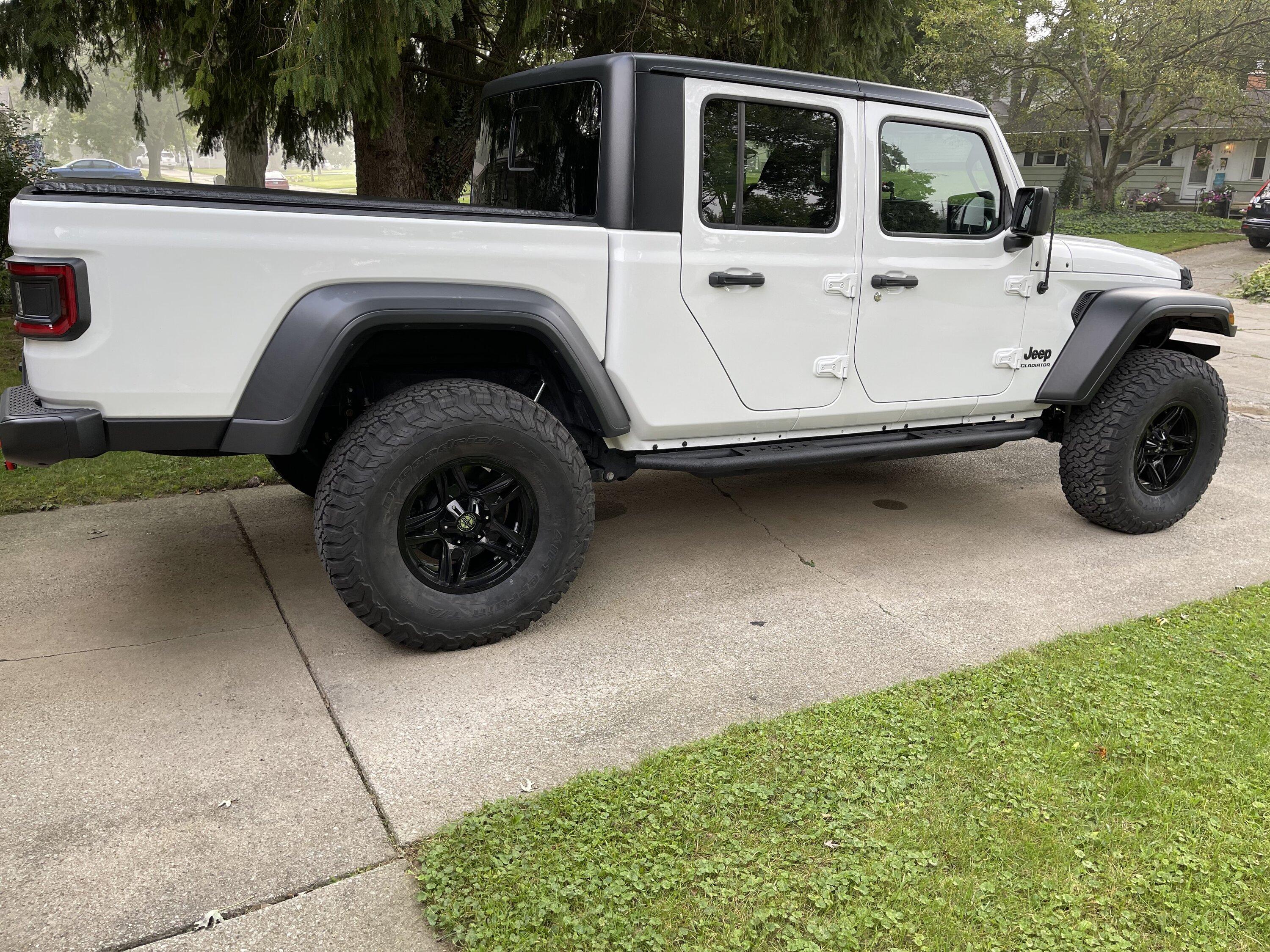

Stopped by the local 4x4 shop and picked up a Teraflex leveling kit.
