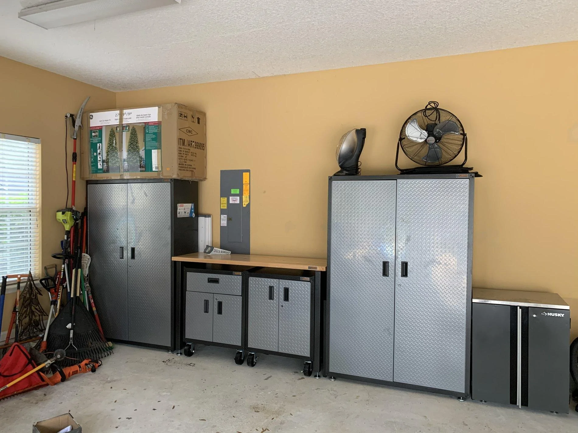

After hauling the Gladiator storage with my Gladiator I finally got around to finishing the cabinets and workbench. Next is paint. I know, I know. I should’ve painted first but I couldn’t wait to get the system put together.

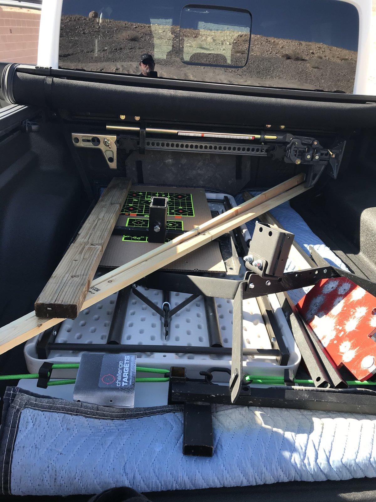

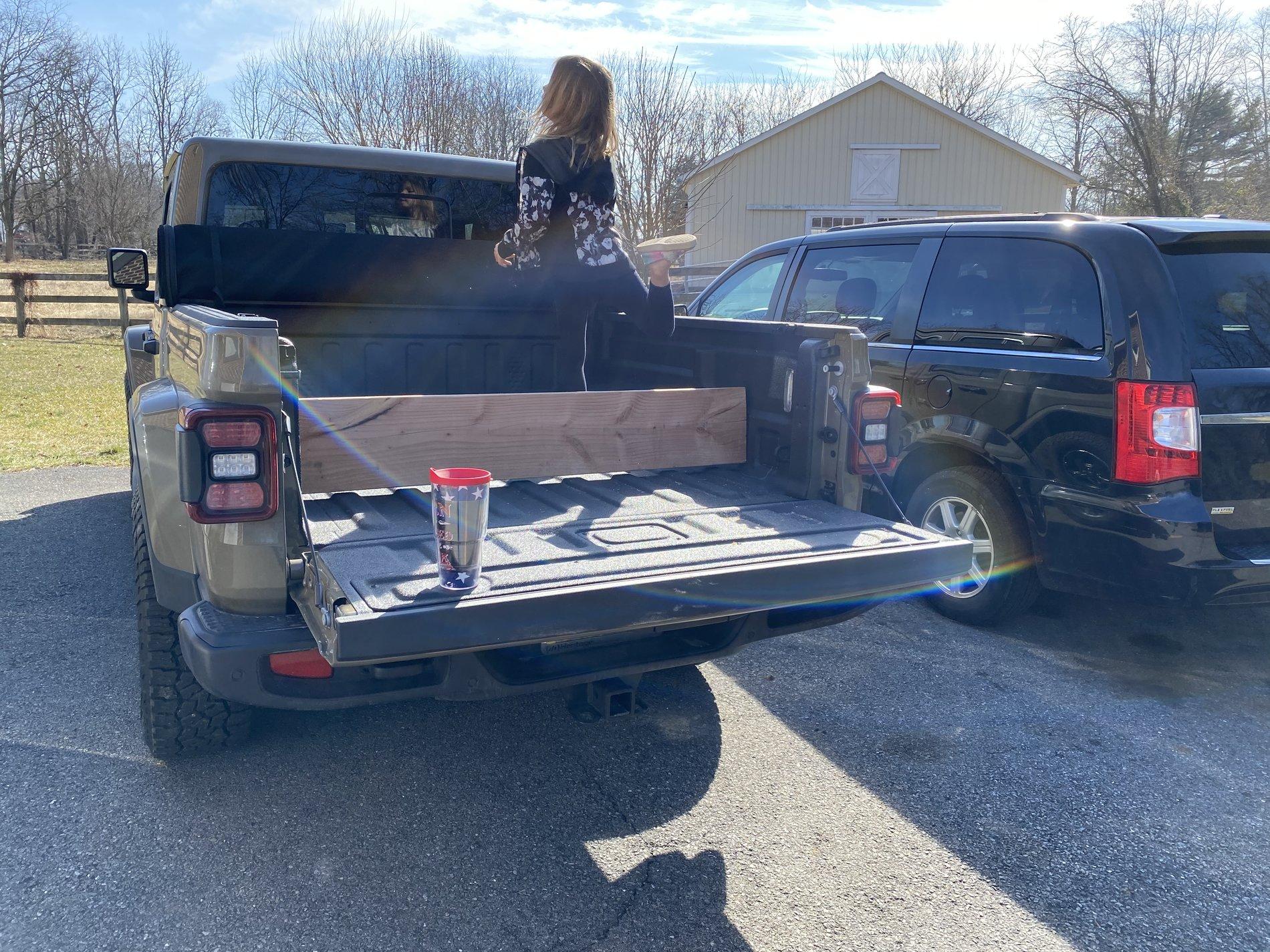

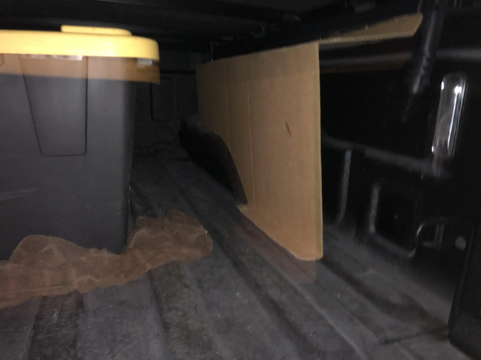

Added the grocery stopper... she got tired of being sent in under the cover for the escaped cans.. although she has improved her low craw skills..
Jeep Gladiator What did you do WITH your Gladiator today? 48A00144-5046-42F7-9736-F4CC252B4DA5
Gatorized
Sep 13, 2019
1,904
1,796
ME/NH
You need a 1” chamfer on the bottom corners so it sits flush.

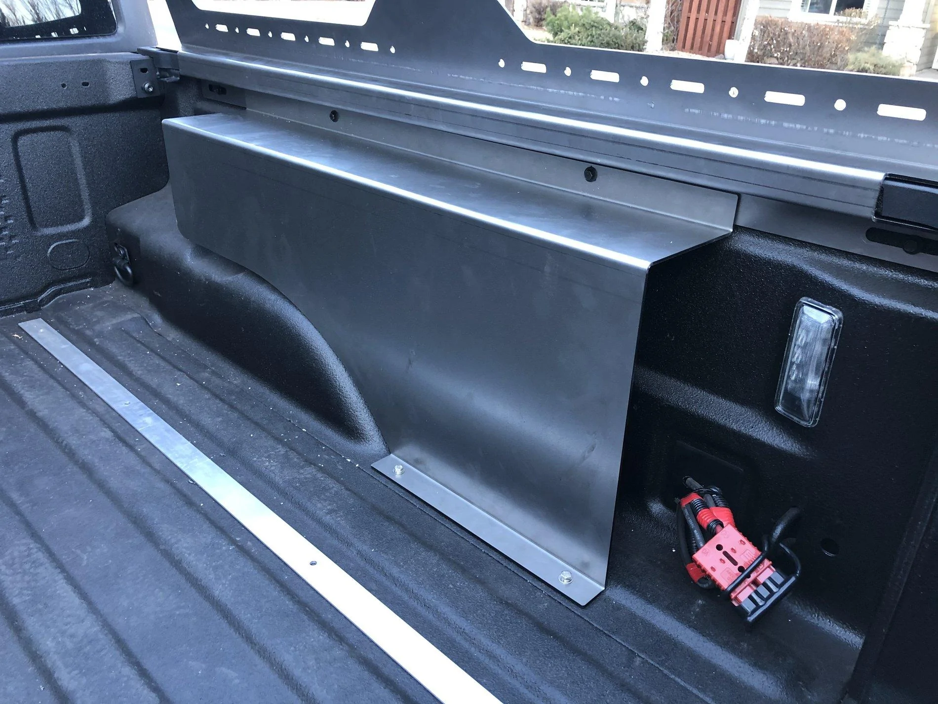

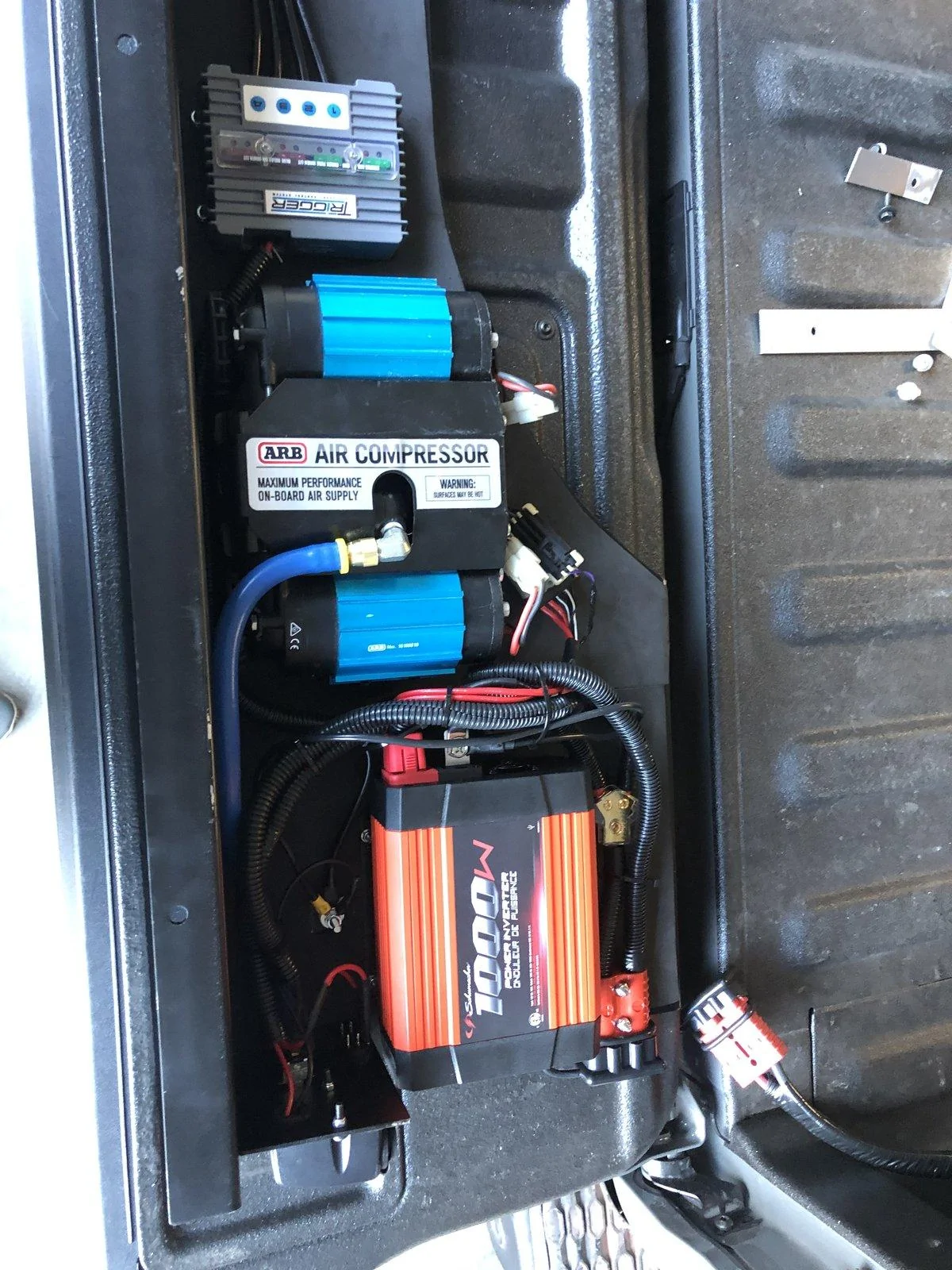

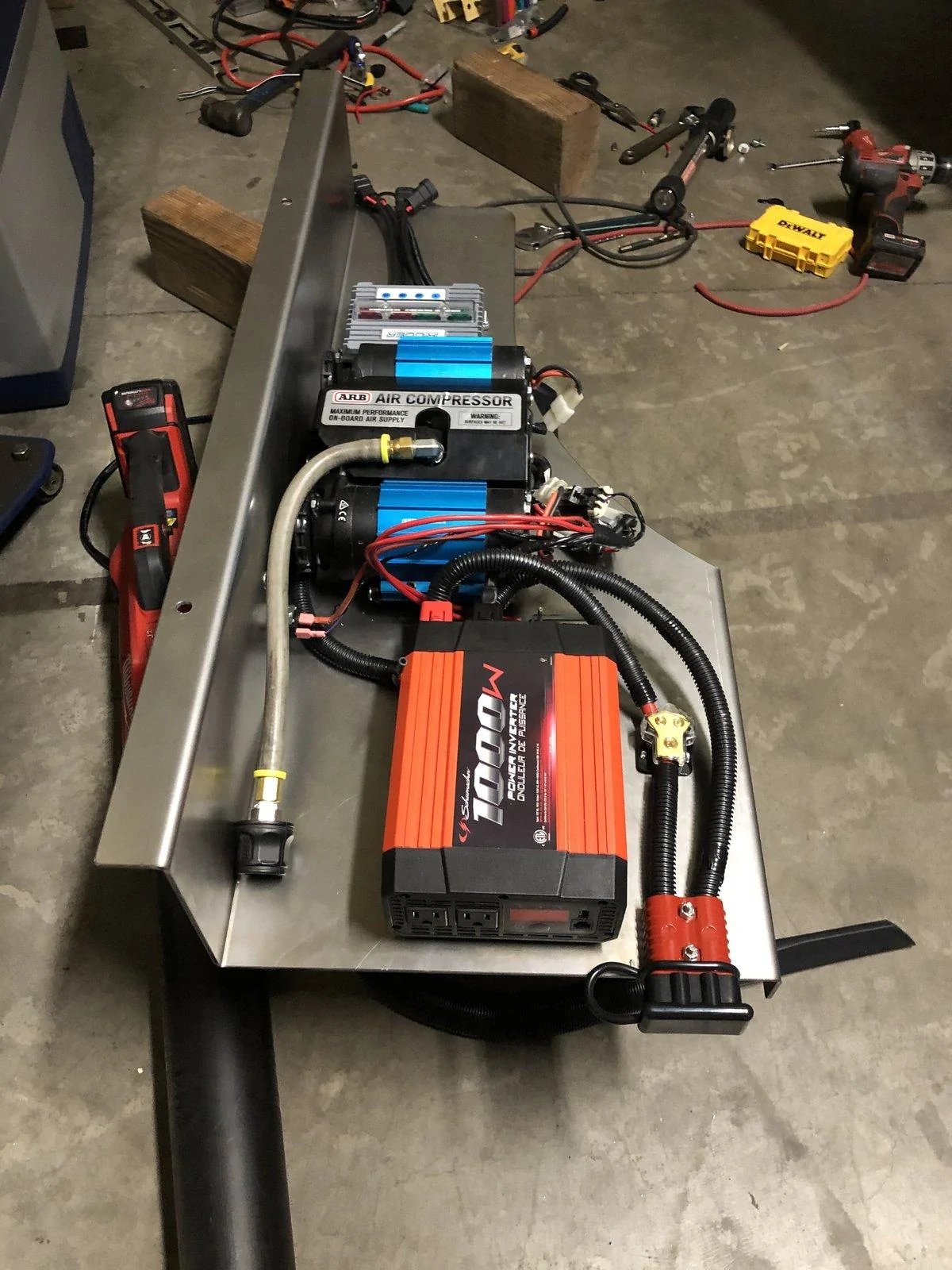

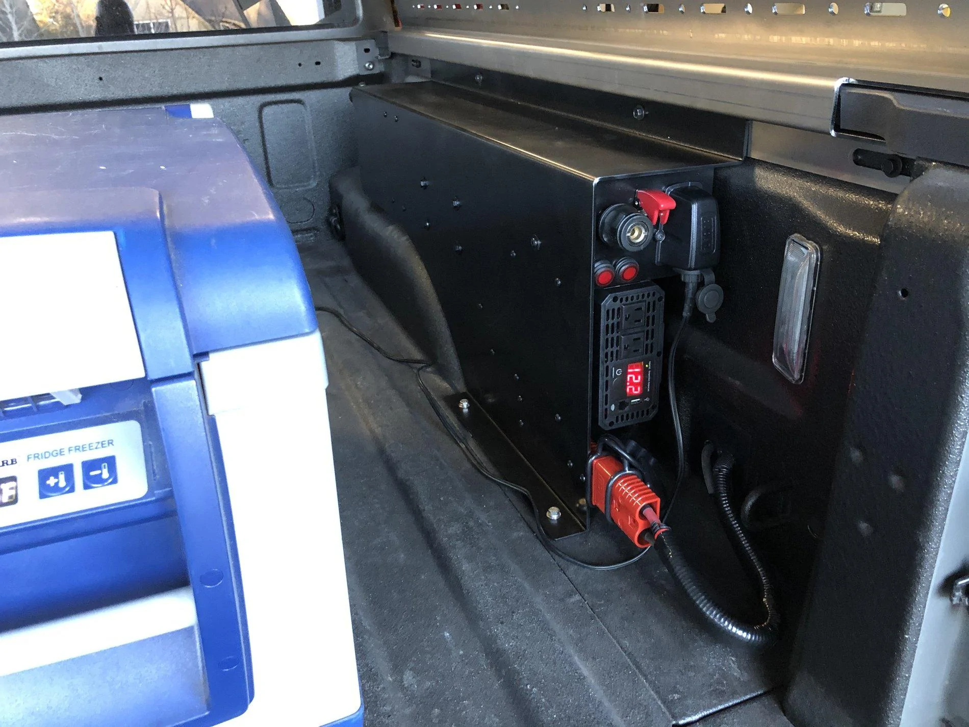

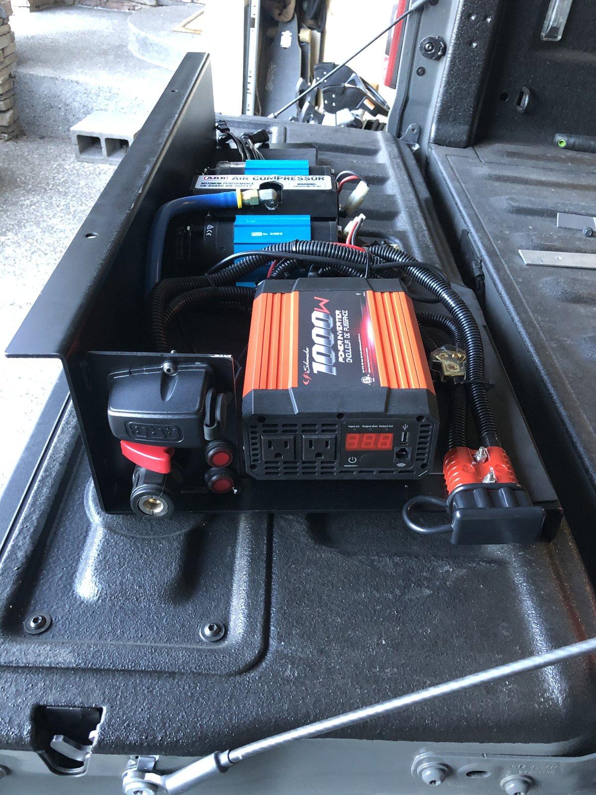

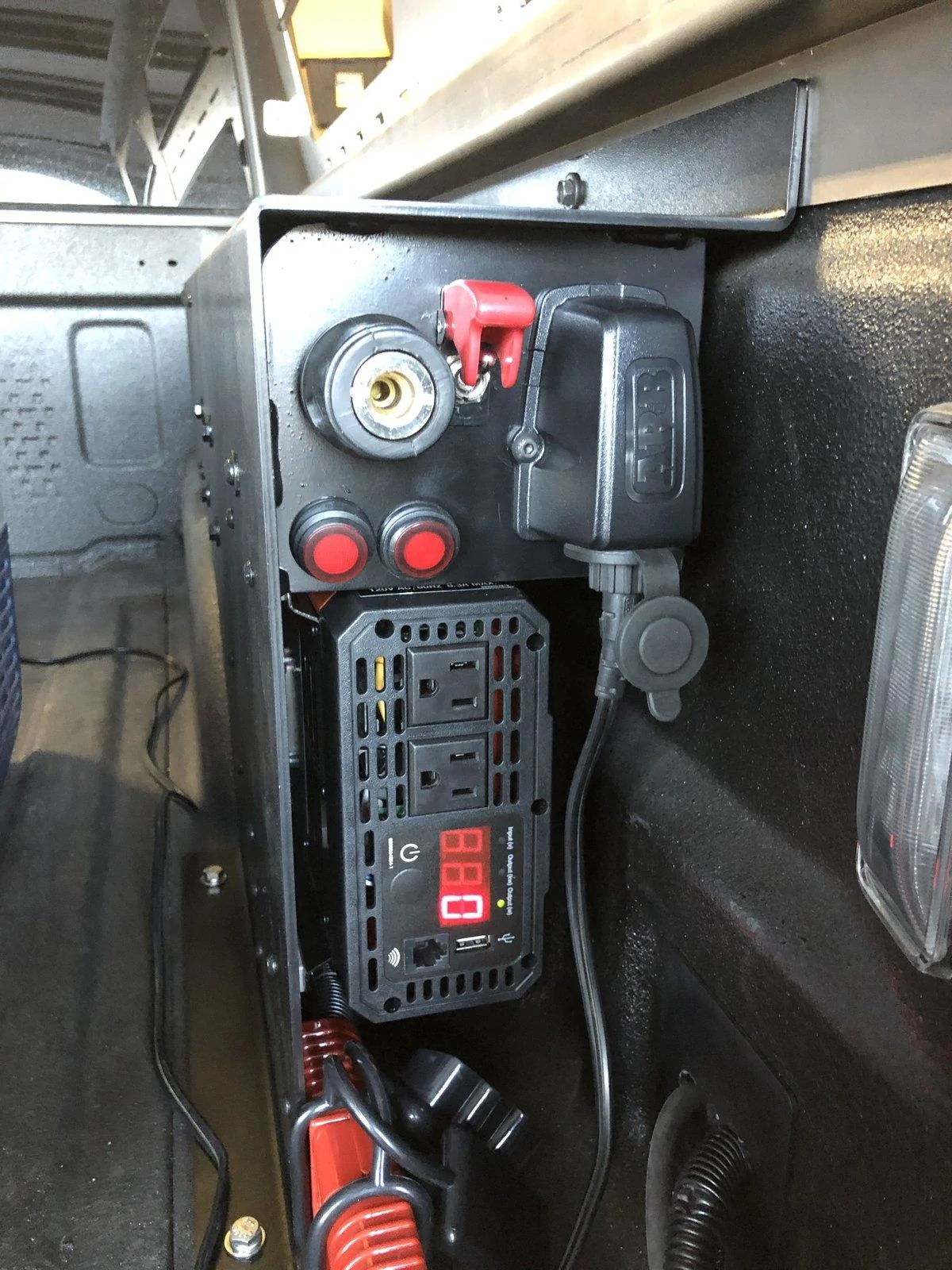

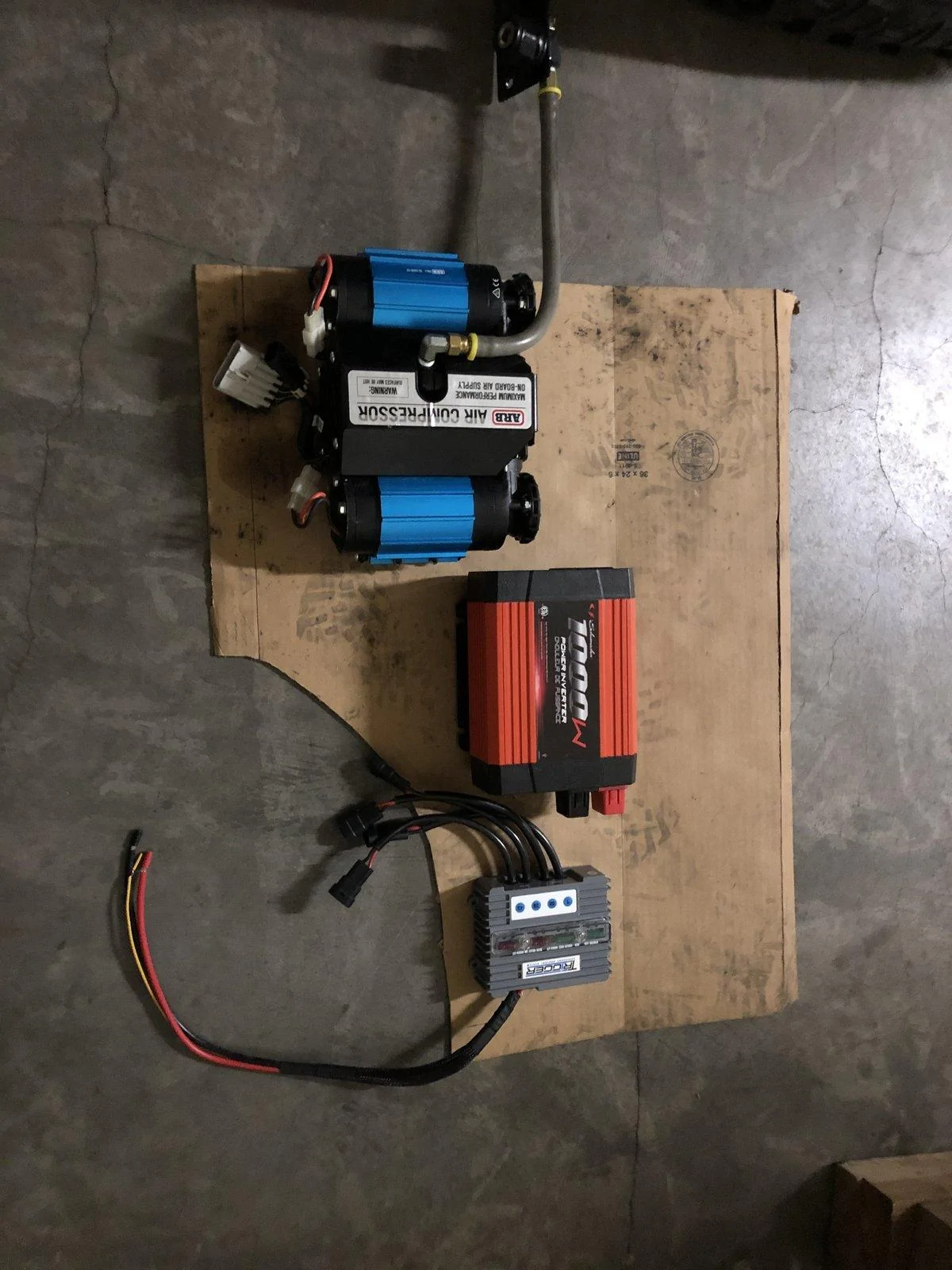

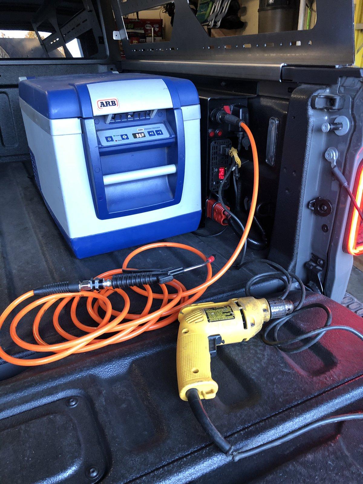

Finished up this little project, needed a place for my inverter, twin arb, fridge plug, aux switches, and switch pod. i think it turned out pretty sweet! I ran a 100amp fused 4ga quick disconnect plug to the bed and then fused each circuit from there. I’m now able to run a grinder, drill, and espresso marker on the trails :) best thing is it removes in a matter of 2-3 minutes.
Are you powering a 1000w inverter strictly off the production battery setup? Do you use or plan to use a battery monitor system to ensure you don’t dump the batteries to a level you can’t start?
Yes and it has a monitoring system built in. If I use the inverter it will be while the engine is running. Been using this setup for years without any issues. Also I have the larger alternator. I will probably install a second battery in the bed but no plans as of yet.
Looks awesome!
Really nice job. Having the ability to run power tools is awesome.
Well done!
