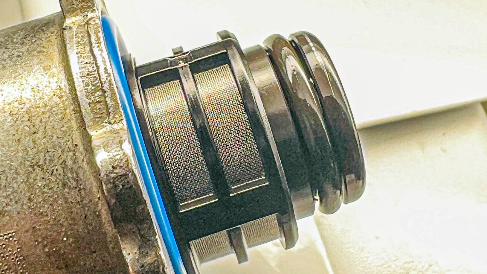

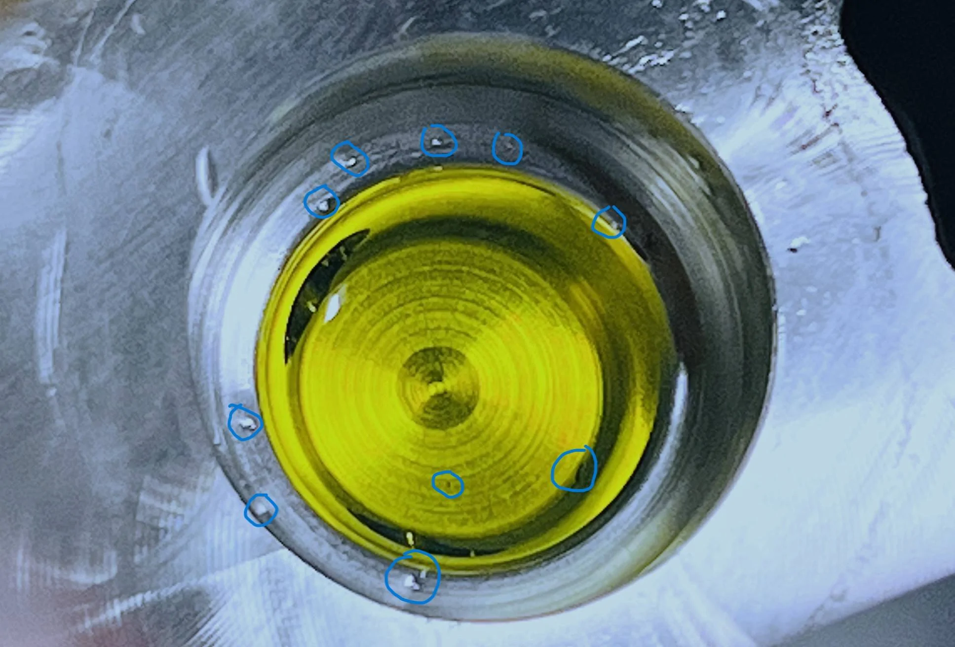

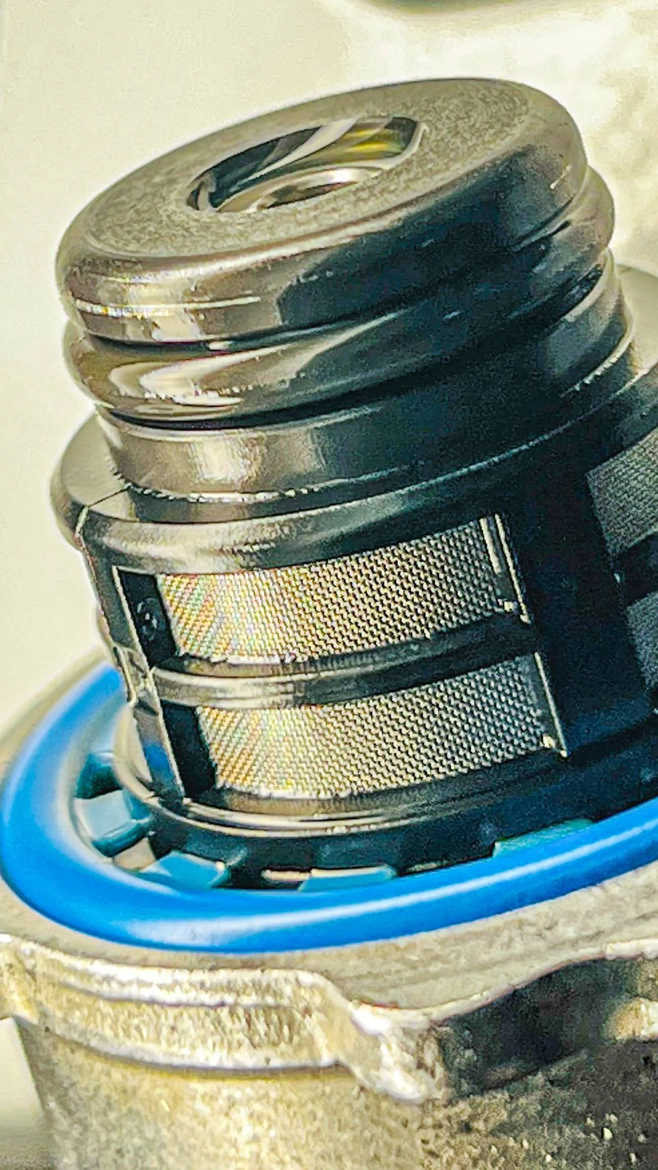

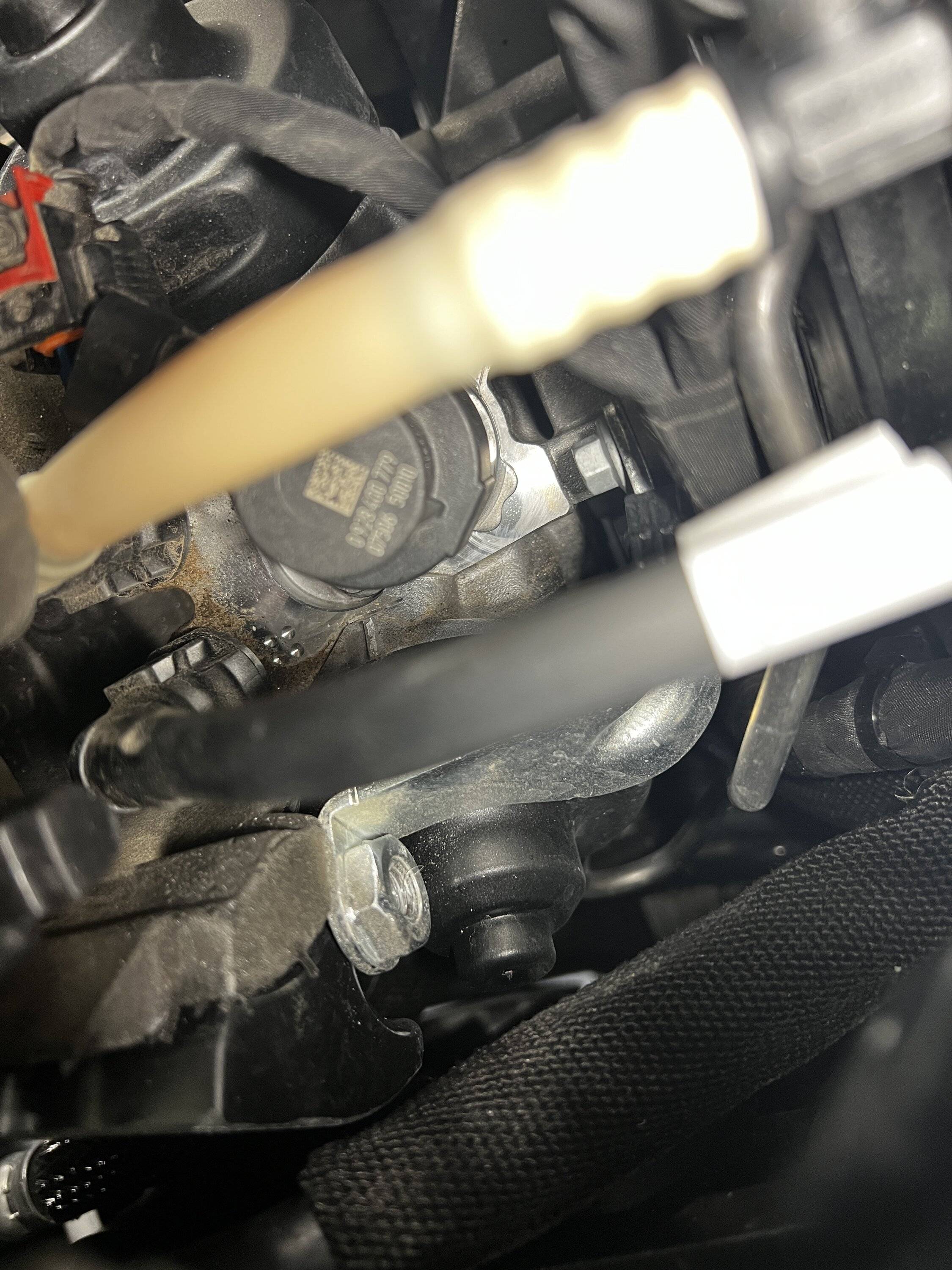

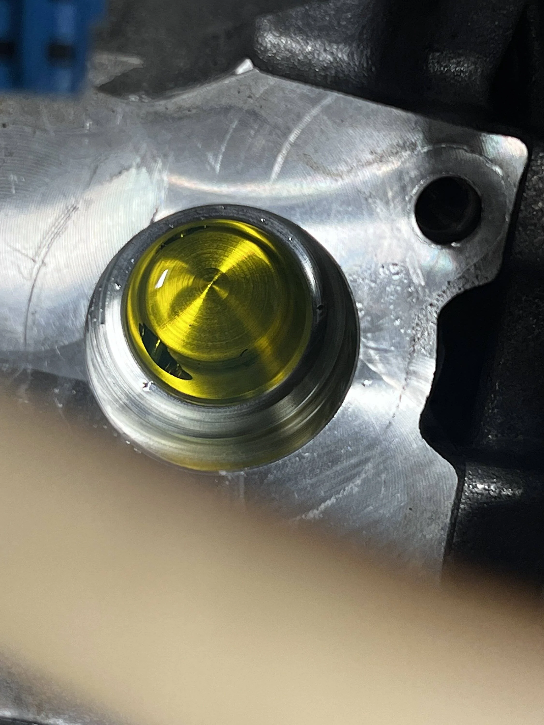

Well it is official that my CP4 HPFP is on the way out. At my last filter change of 34k miles, I change filters at every 10K, I found small metal shavings in the bottom of the filter housing. I cut the filter open but could not visibly see metal.
I spoke with the dealership and made an appointment to have the metering valve removed on the CP4 and look for metal. Here is what was found. My 2021 JTRD is scheduled to have a replacement CP4 installed on Friday. This is not a fix but a preemptive repair to avoid a catastrophic failure that would lead to all the HPF system to be replaced. They are going to flush the lines and install a new CP4 at this time. My JTRD is in the recall to be fixed. This is a warranty issue for now.
I caught this early and do not have any fault codes or issues with the way the engine performs. EDT has been used since I purchased it. I now run LX4 and EDT both from HotShot Secrets.
My CP4 is the old model as seen by all the dimples engraved on the top. The newer model only has one Large dimple engraved. Go to 7:13 in the YouTube clip.
EDIT: This is from the RAM recall to locate a newer model pump.
Cheers.
Cheers.

The metering valve images you posted, are those images from your jeep? If so I don’t see any metal in the images? Maybe it’s my phone screen?

Yes, it is from my CP4. There are only a few, but any is not good. Before I replaced the metering valve (FCA/MPROP), I used a magnet to extract any of the metal shavings. They were ferrous metal and not aluminum. A couple small shavings were on the screen and O-ring of the valve. I also noticed a small piece of the O-ring in the chamber. It must have been pulled off when removing the metering valve. It is a very tight fit putting it back in.
I will be happy to get this failing CP4 HPFP out of the Jeep so it quits sending metal into my HP fuel system.
Jeep Gladiator Z96 High Pressure Fuel Pump Recall!!!!!! CP4 Metering Chamber
Not a fix but I can sleep better and still drive it until the recall is figured out.
