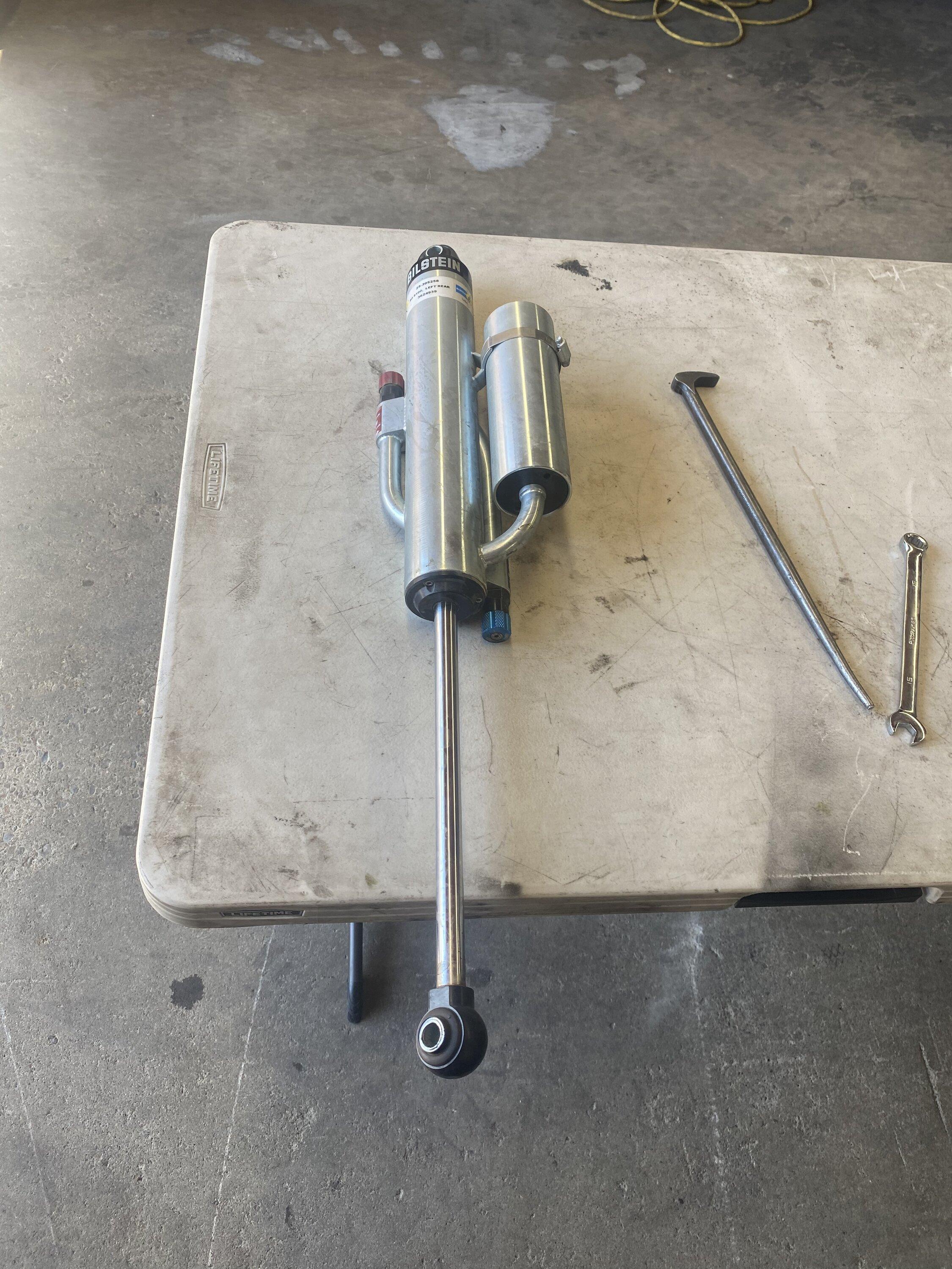

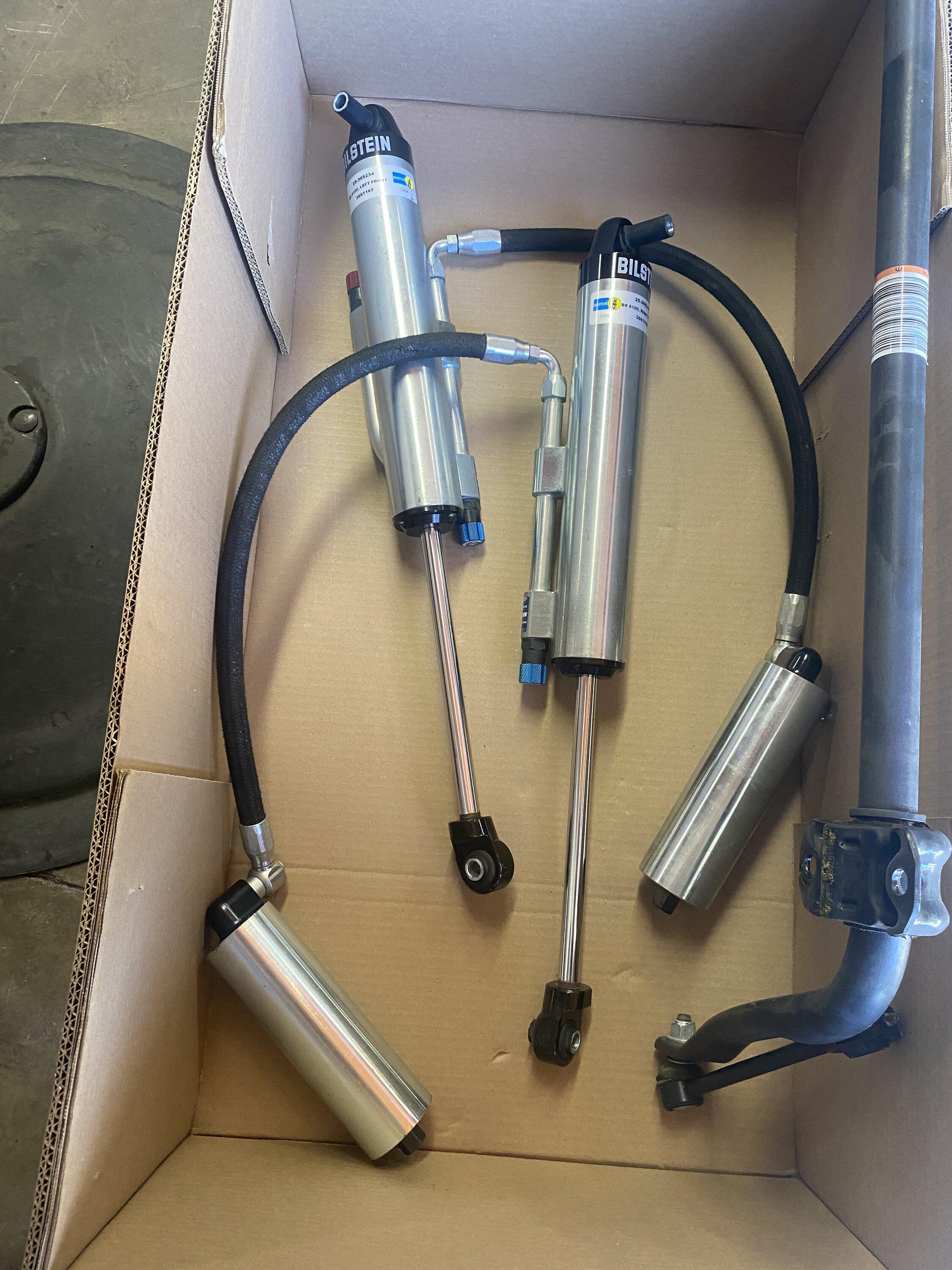

I was running the B8 8100’s before this.
