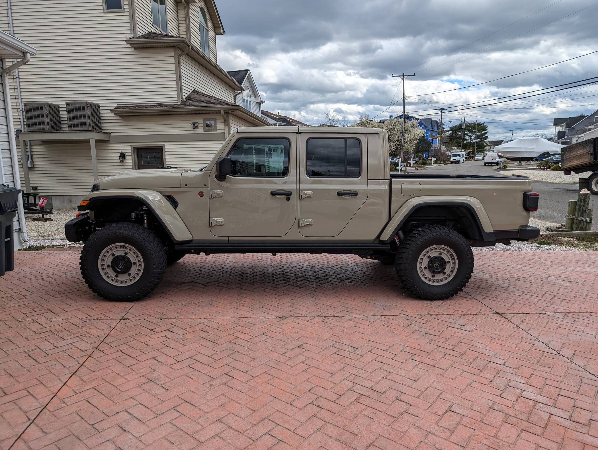

Here is a picture of what it looked like with all the Clayton springs in it...
My driveway is on a slight angle ...

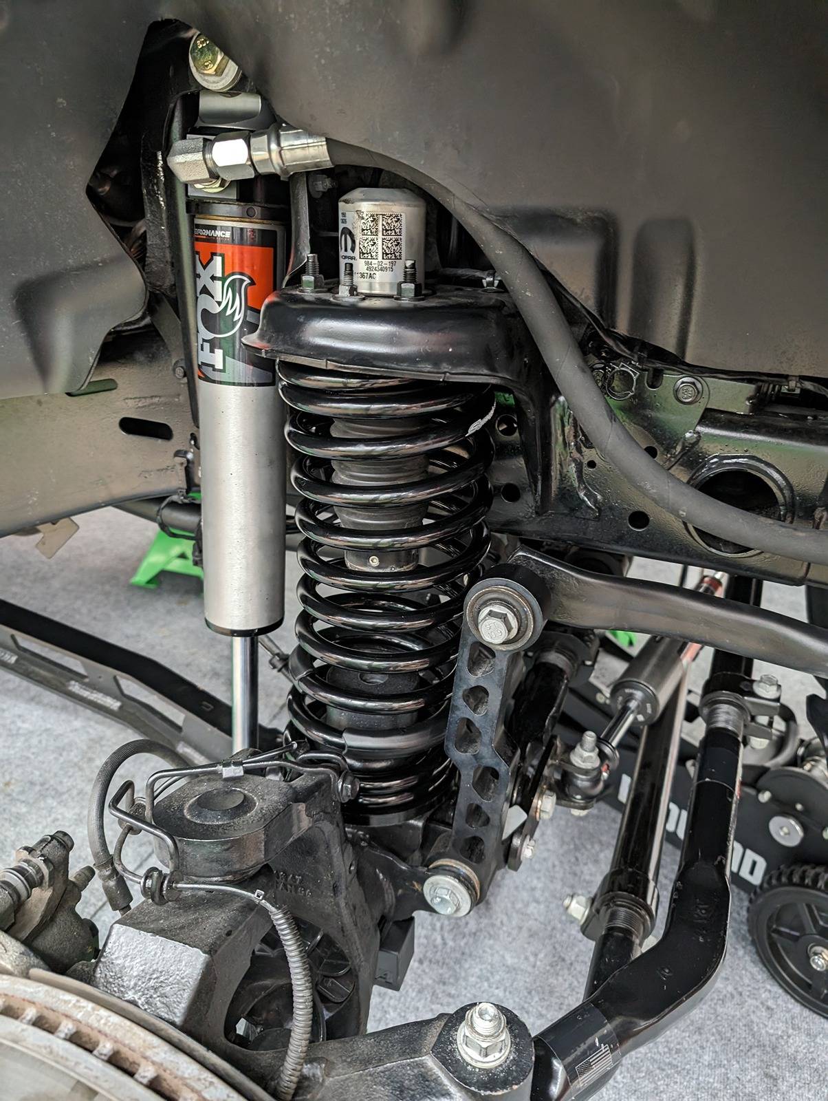

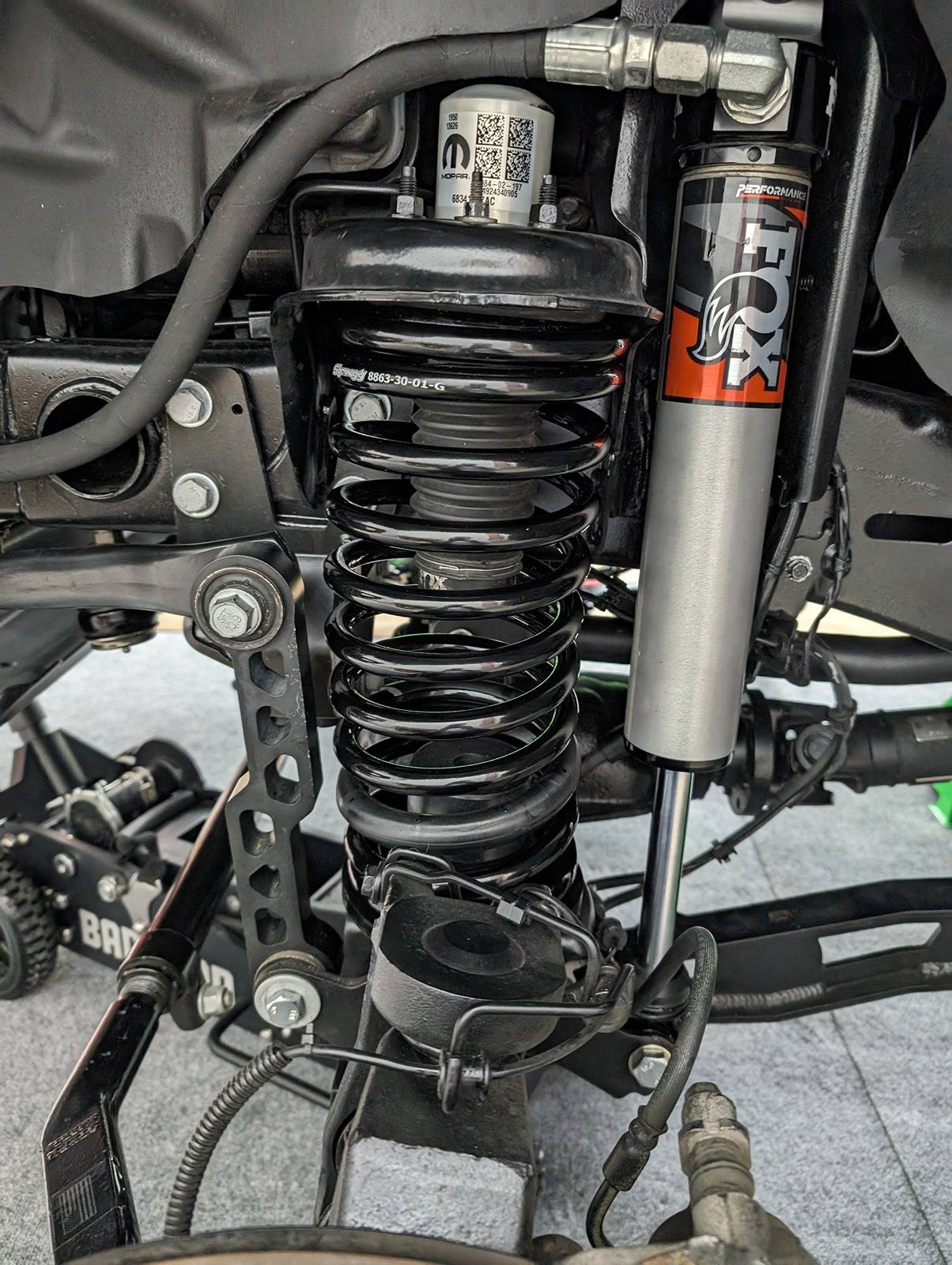

Picture of both sides bowing...
Jeep Gladiator Anyone switch from Clayton Springs to Synergy? PXL_20240411_133455072
They should bow out towards the wheels not forward or in. synergy springs and the iso's they come with should fix that. thats definitely bowed wrong.

I used the spring pads they came with..

So I spoke to Synergy today on the spring bow. They said there shouldn't be any. They said the only time they see spring bow is if the caster is wrong.
So I took the Clayton UCA off and measured them again. Then I checked Clayton's instructions, then it all went to hell...
In Clayton's instructions it shows how to measure them. So I measured and set them like that. Well of coarse I couldn't get all the bolt holes to line up, I struggled for 2 hours. Them I called Clayton back again. To clarify how to measure. They said just go from center to center of the bushings, so I did that. Again I couldn't get all the holes to line up, so I took them off again.
That is when I realized that center yo center of the bushings holes are different on each side because of the bend.... So I called Clayton back again to clarify. When I asked again about measuring point, they said as long as it is with .5 to .75 of what is on their chart it is fine...
They also said just set the driver's side length and adjust the passenger side control are so the holes line up, does that sound right?
So I set everything, springs still bow... I had no bow with the Clayton springs. Today kicked my ass!

Just to make sure I am thinking correctly because my brain is scrambled today after talking to Clayton...
To Increase Caster I need to shorten the upper control arm or lengthen the lowers correct?
I have 24.25 lowers in (non adjustable) , with 3" of lift I should have stock length or shorter uppers. Is that correct?
Clayton's chart has me making the uppers longer than stock, I think that might be causing the spring bow...

Have you taken a pinion angle measurement?
I would use synergy’s control arm lengths for their springs…. The manufacturer of the control arm is a moot point- you are looking for control arm length based on the spring height…. And then fine tuning for caster angle/pinion angle.
To me- if your springs are bowed (mid point of the spring bowing outward to the front) the axle center is off and it can be off because the uppers are too long, or the lowers or too short, or a combination of both.
Get the lengths from synergy for the springs you have… that will put you in the ball park, then fine tune to caster/pinion angle.
control arms can be a pita….. have two floor jacks can be helpful- one under the diff/yolk to help roll the axle helps…. Beer also helps- but can also make this problem worse….
