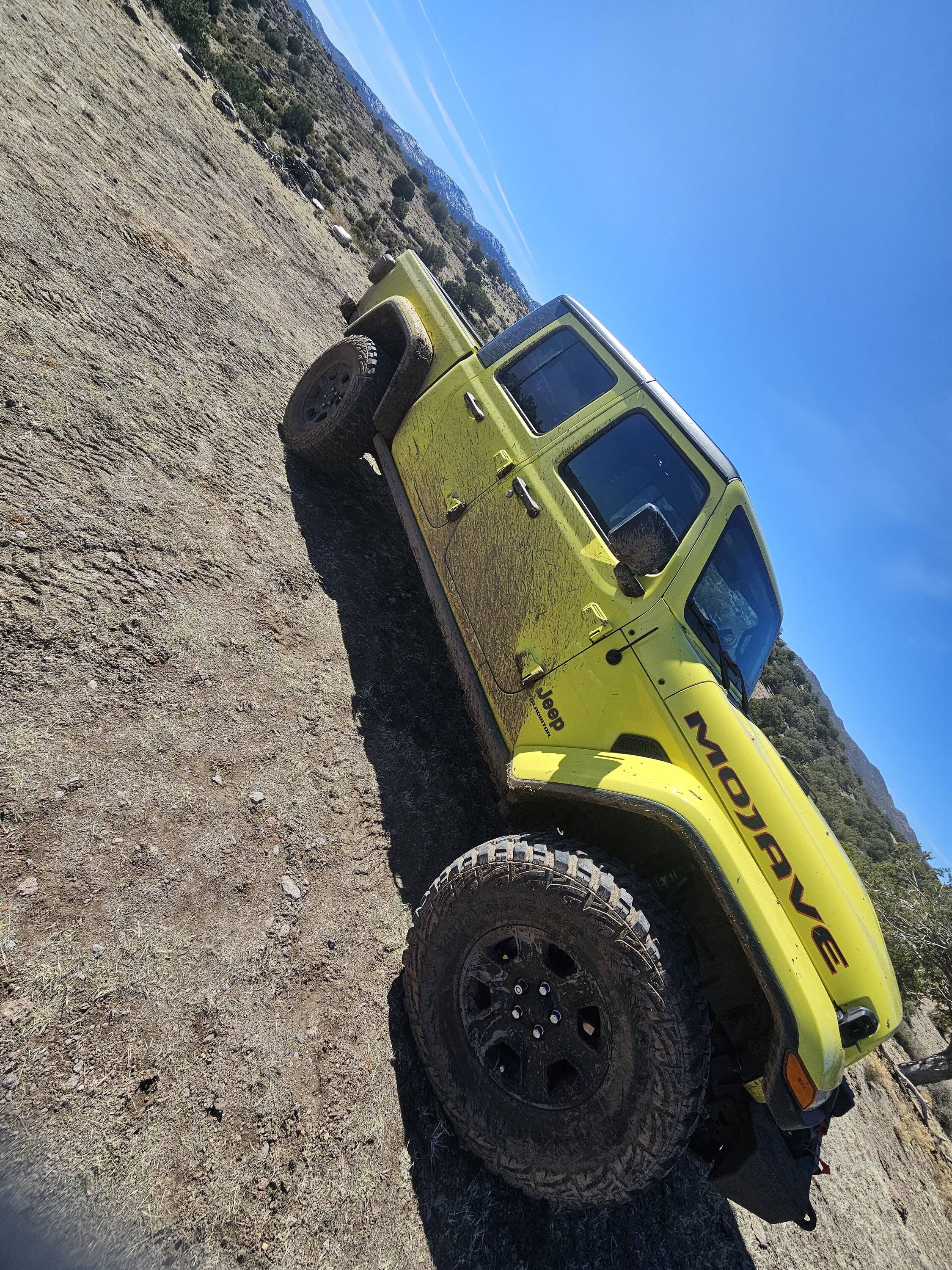

The extra welds might not make the difference, but the hydraulic bump stops and much higher shock dampening ability of the 2.5" shocks likely will. Not saying the mojave is indestructible or a trophy truck by any means, but if you do tend to smash whoops at "much too high of a speed" or go airborne the mojave is much better for that. Sure you can upgrade the shocks, add hydraulic bumps, etc to the rubicon and make it even better in the whoops than a mojave for thousands of dollars. You'll still have a low range that's too low for the scenarios like deep sand and snow where you need extra torque and wheel speed. You'll still have the massive jt wheelbase and poor breakover and departure angles. I personally went for the ultimate mojavicon set up in my opinion. JTM with 2" of lift and 37s for all of its advantages in the desert and JLUR with 3.5" lift and 39s for all its advantages in the rocks. You'd need at least 42s on a JT to match the JLUR in the rocks. Building 1 rig for all types of terrain leads to compromises no matter which way you lean.
Jeep Gladiator Building a Mojavicon: Adding Lockers and Swaybar to a Mojave 20240216_131821
Jeep Gladiator Building a Mojavicon: Adding Lockers and Swaybar to a Mojave 20230925_162818
