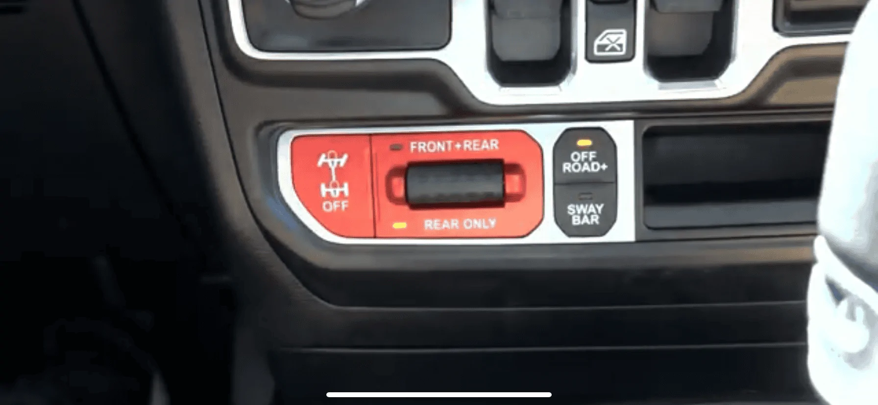

that button you had must be the old jl switch,
JT RUBICON has offroad button
i wonder what the part number is for it though
here is the pic

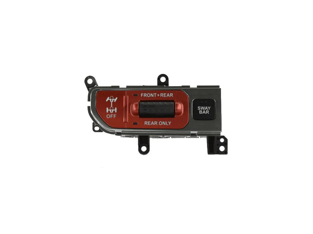

here is the pic
The part # for the below switch is 56046716AD
