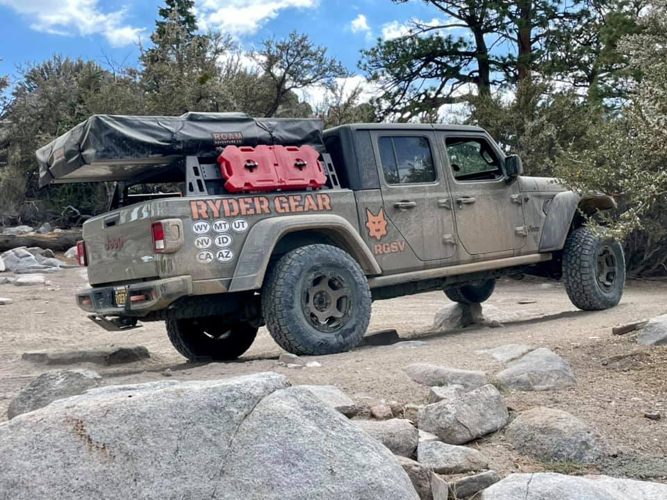

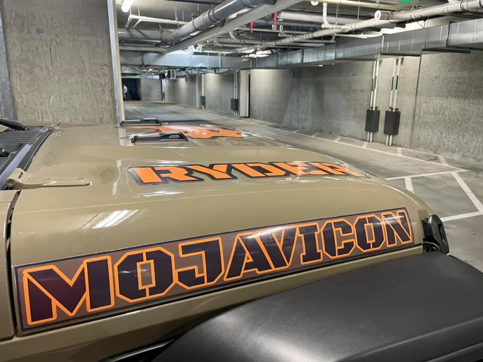

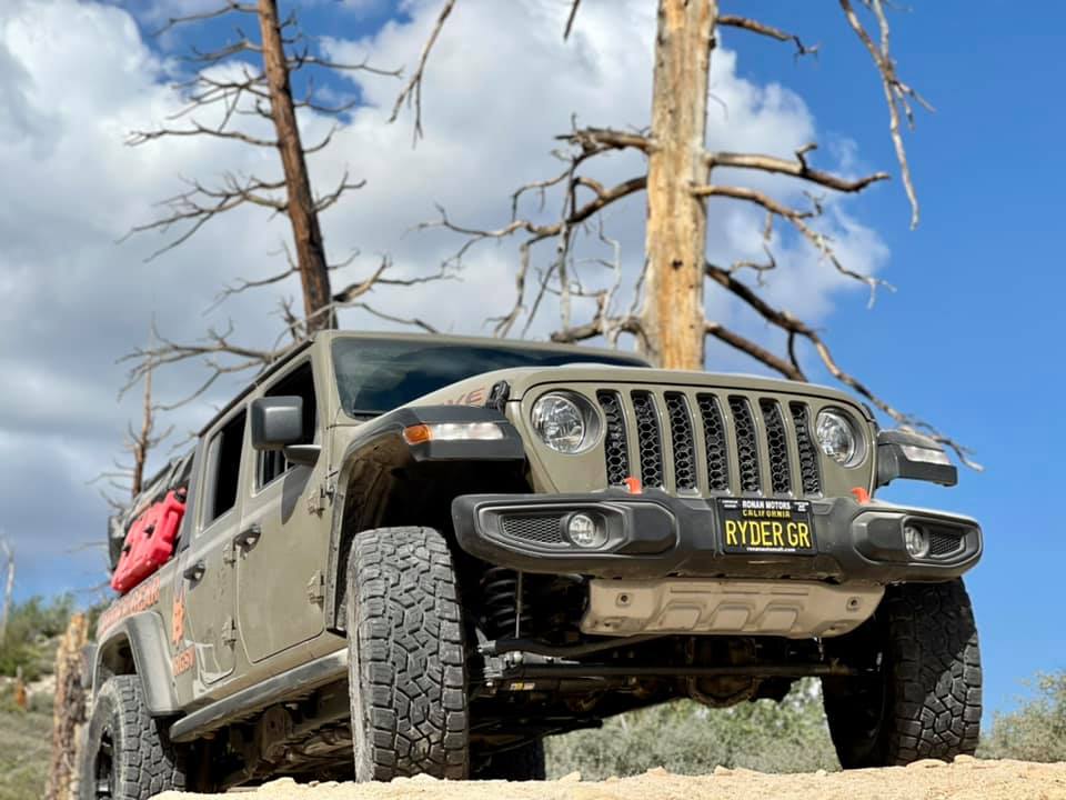

I Built it! and its AMAZING!!!
2020 JT Mojave Edition
+ ARB Dual Compressor
+ ARB Front Locker (Rear Locker part of Mojave)
+ APEX AutoLYNX Detachable Sway Bars
+ AEV Mojave 2” Spacer Lift
+ 35” Toyo Open Country A/T Tires
+ Terraflex Nomad Deluxe Wheels
+ Bed-mounted Pro-Eagle BEAST 2.0T Jack
+ JCR Half Rack & Various Molle Panels
+ JCR Overhead Center Molle Panel
+ ROAM Vagabond XL RTT
+ Mounted CB Radio
