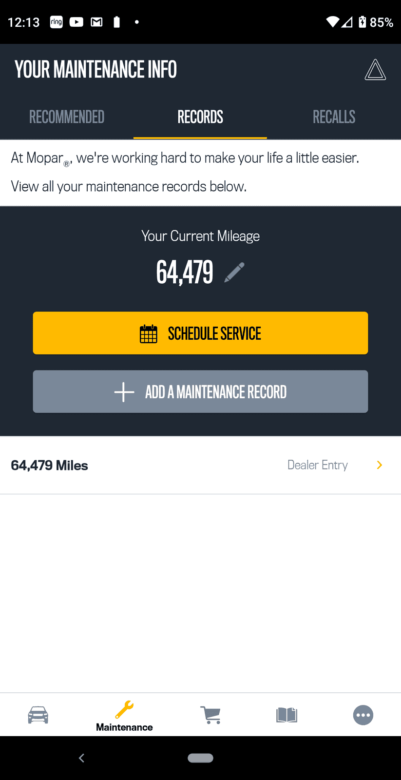

Mine is in today for the recall. They just wanted to call me an Uber to get home? Yeah no. Driving a Compass while they diagnose and do the retrofit and bleed the system. Oh and to fix the reported mileage issue they created last time with their pot smelling service advisor. I'm pretty sure I'd have the highest mileage JT if it were right, but I'm at 9703 total miles. I have 2 dealerships in the area. Johnson Auto Plaza, who do crazy sales business, but everything is so rushed, work quality is questionable. Second is Larry H Miller, possibly better repair service, but they really suck on everything else.
Jeep Gladiator Clutch Recall (FCA W12 | 20V-124) For Gladiator Manual Transmiss [overheating clutch pressure plate] Screenshot_20200604-121319
