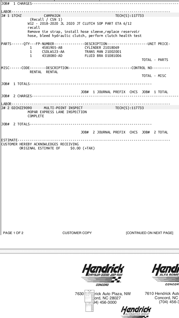

brought mine in last week they said hose had small leak and took a picture for jeep to decide on repair or not. Came back today and in a couple hours it was done....heres the invoice:
Jeep Gladiator Clutch Recall (FCA W12 | 20V-124) For Gladiator Manual Transmiss [overheating clutch pressure plate] 70E7A304-5B46-4CAC-B831-D710C6BDE572
