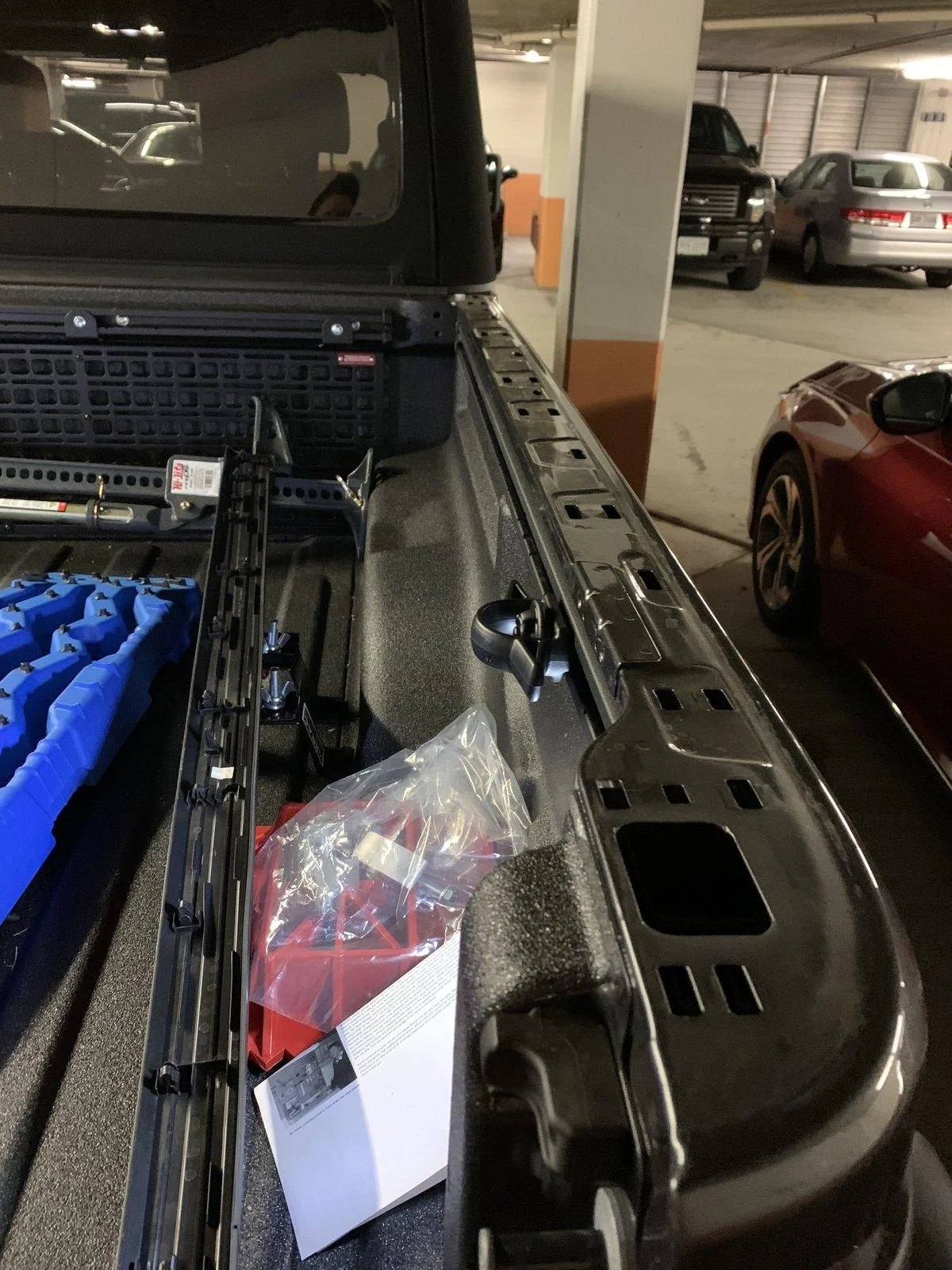

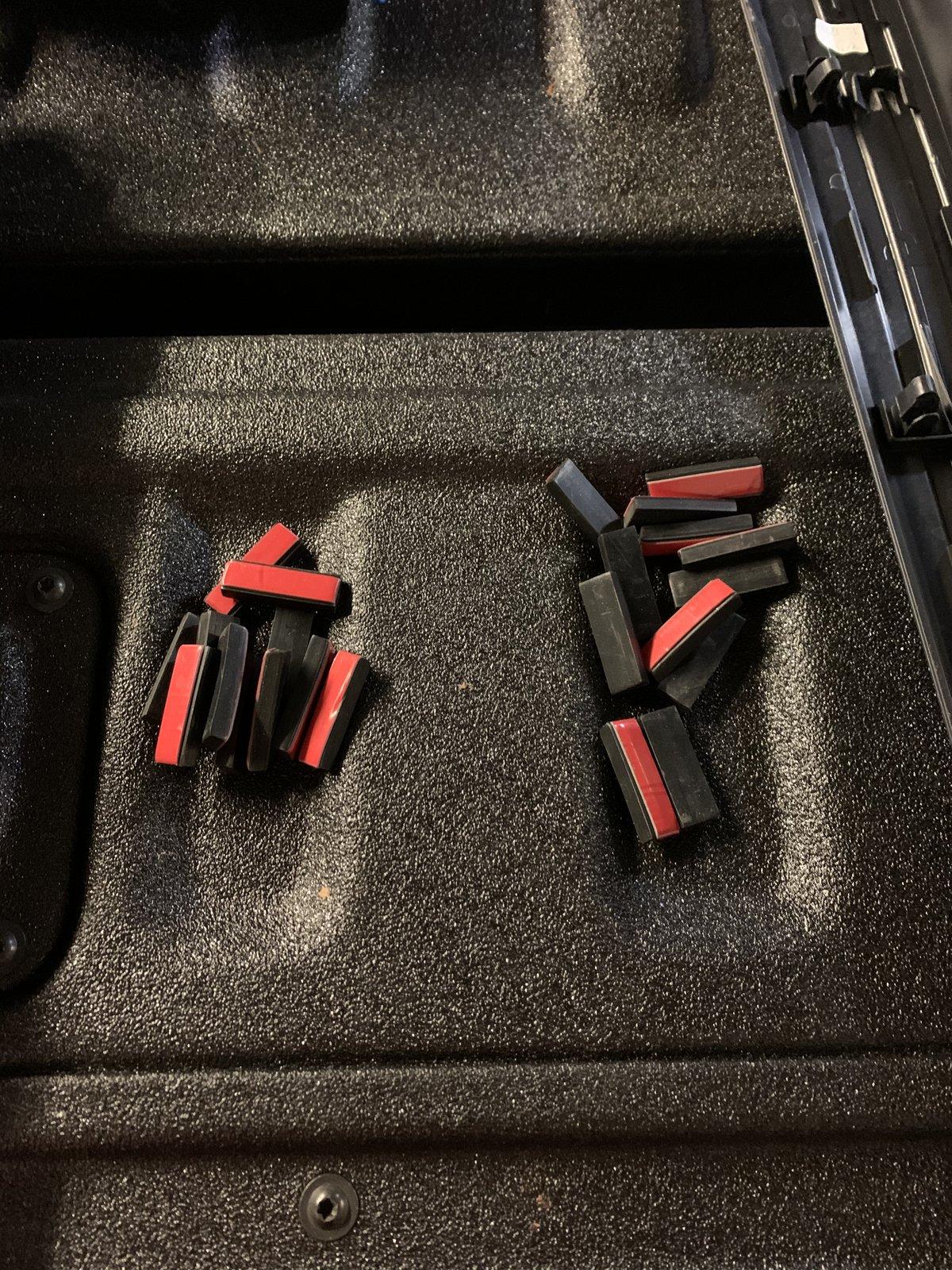

It’s a standard package they have for Tundra’s I believe. This is what the spacers look like.
THANK YOU for those pics. i could not picture it in my head. it did that with my last truck
