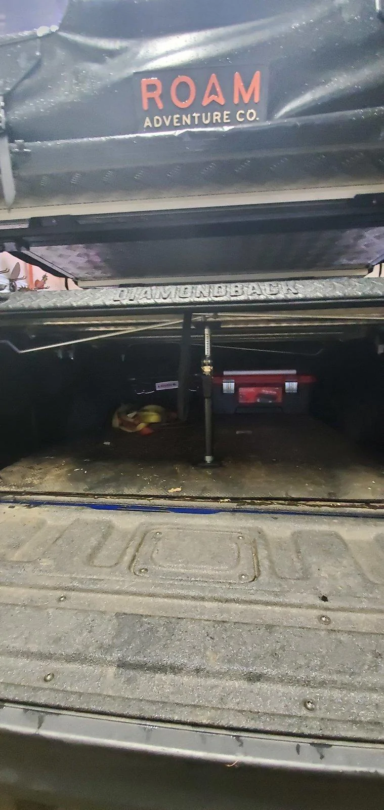

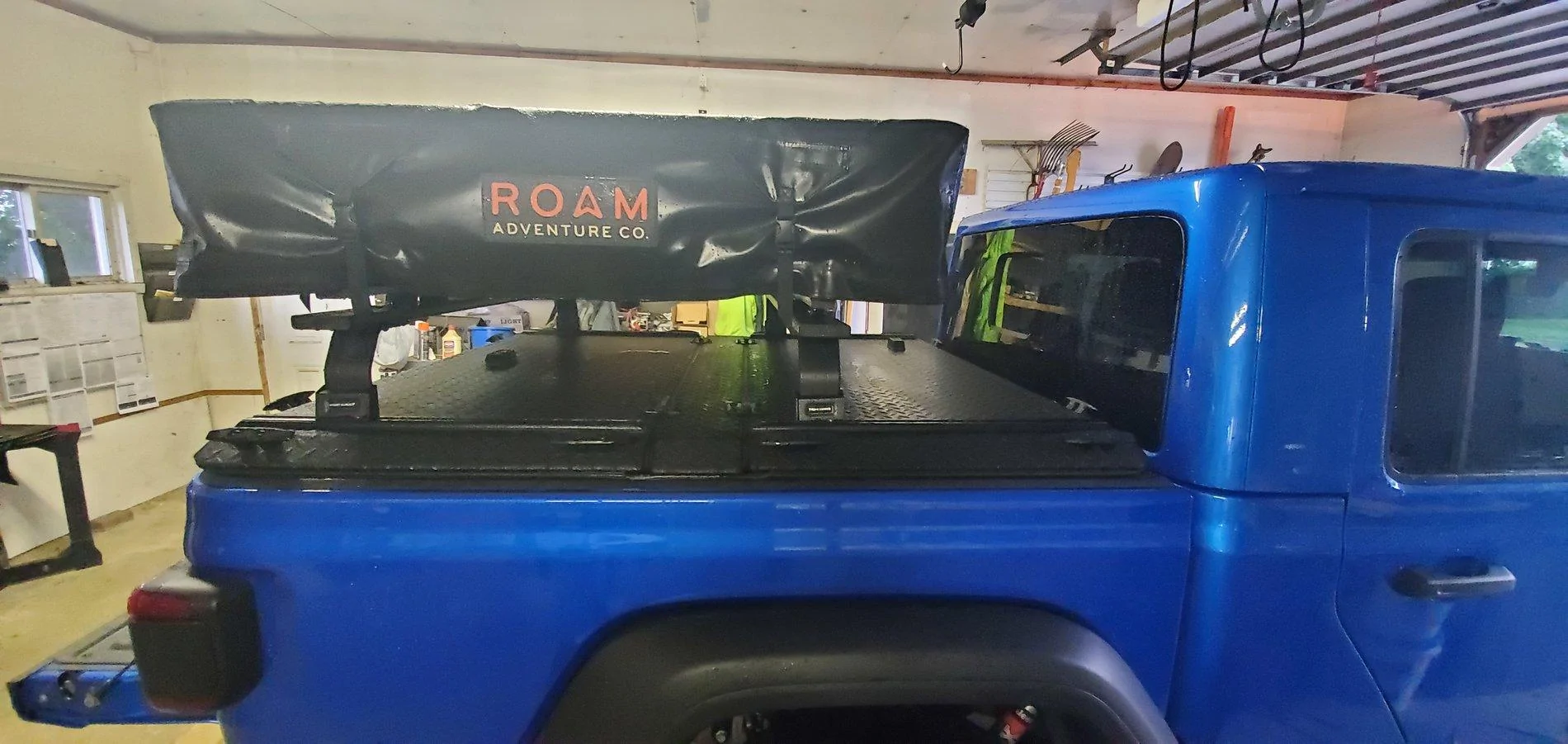

With my diamondback I have had some issues with it being tight on the tailgate, due to the the tailgate trim being slightly taller than the bedsides. This is more of an issue when I have my RTT installed (especially since I install it farther to the rear).
Jeep Gladiator Diamondback HD 20200804_103117
To open/shut the tailgate I would have to slightly push up on the tent, to take some of the weight off. This was made even worse when I have the RTT deployed (off the rear).
Jeep Gladiator Diamondback HD 20200802_063607

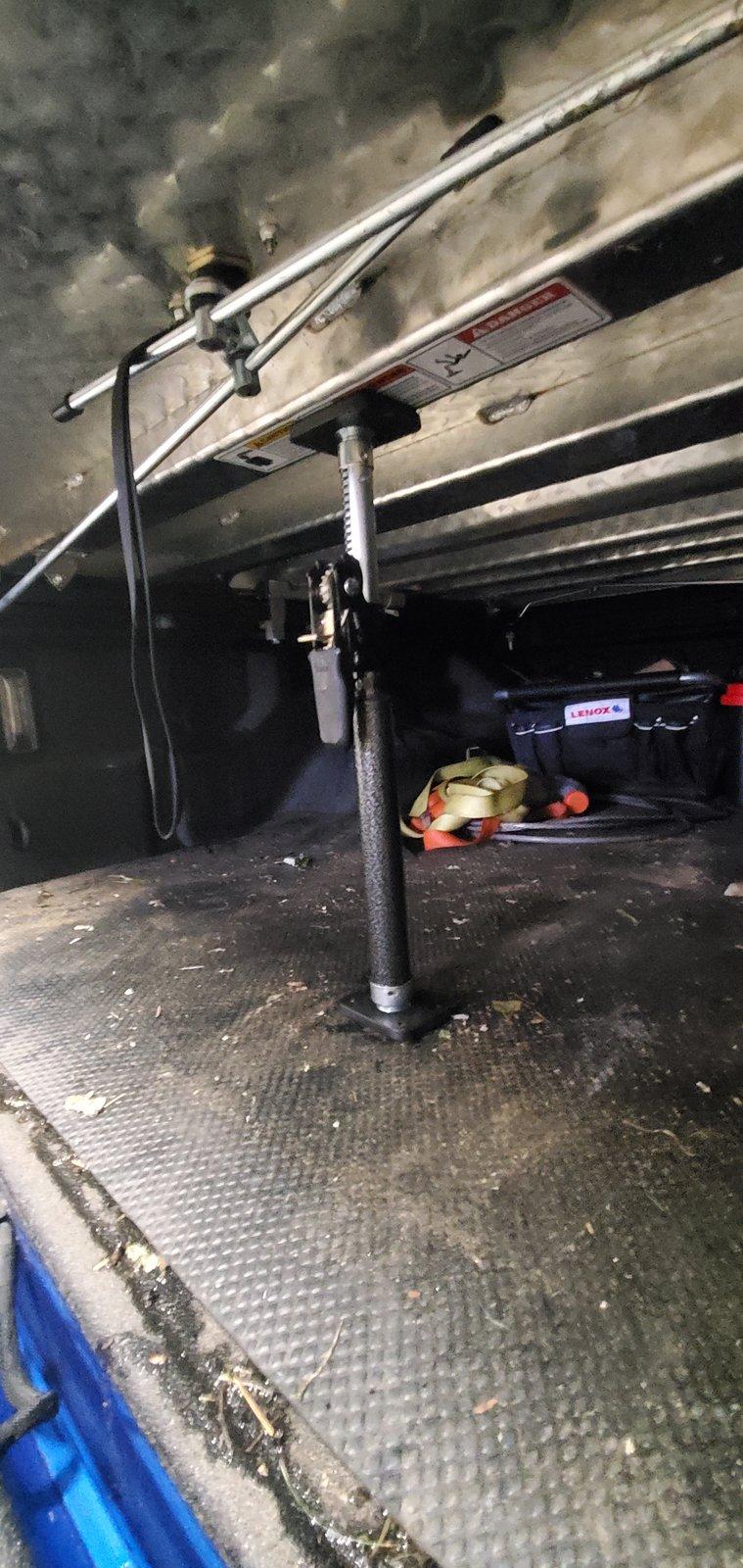

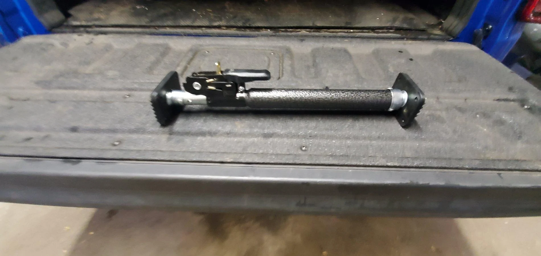

So I decided to add a support between the bed and cover. Right now I just did one in the center, but may decide to put one on each rear corner. Basically just took a load bar, and cut it down in size
Jeep Gladiator Diamondback HD 20200804_101100
Jeep Gladiator Diamondback HD 20200804_101108
Jeep Gladiator Diamondback HD 20200804_102623
