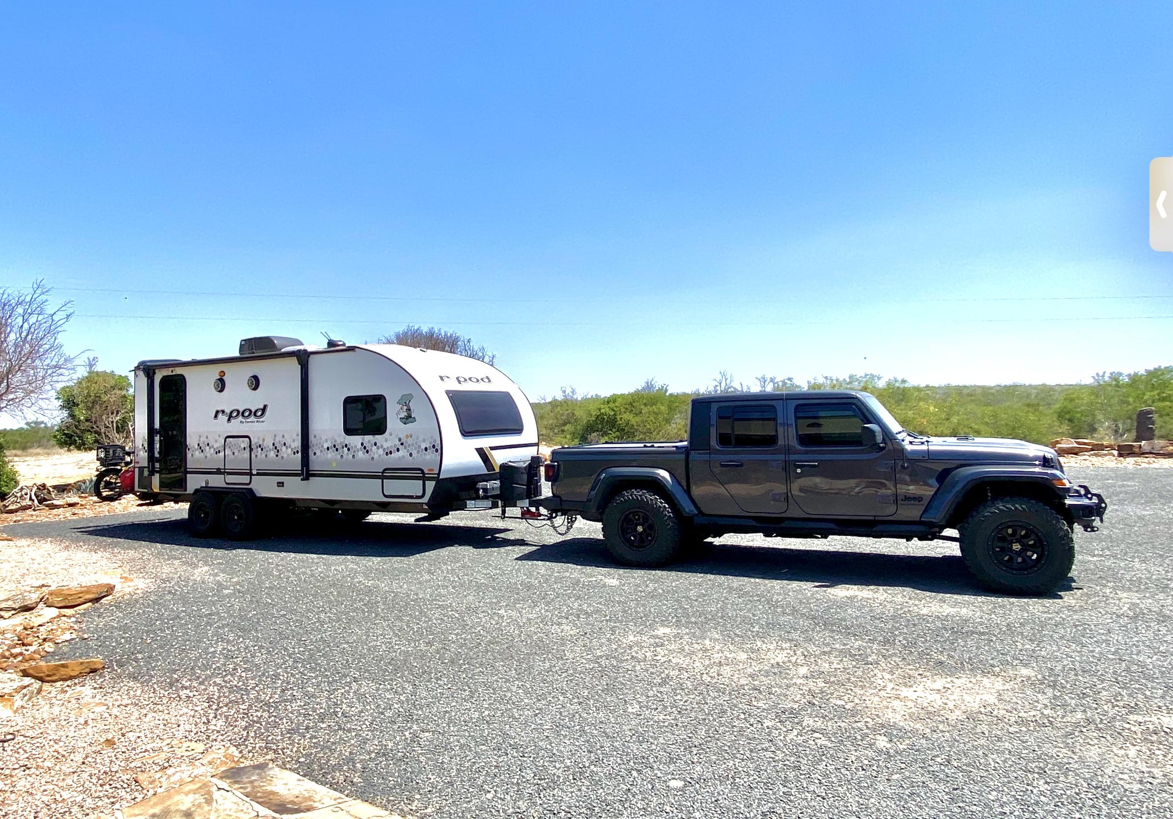

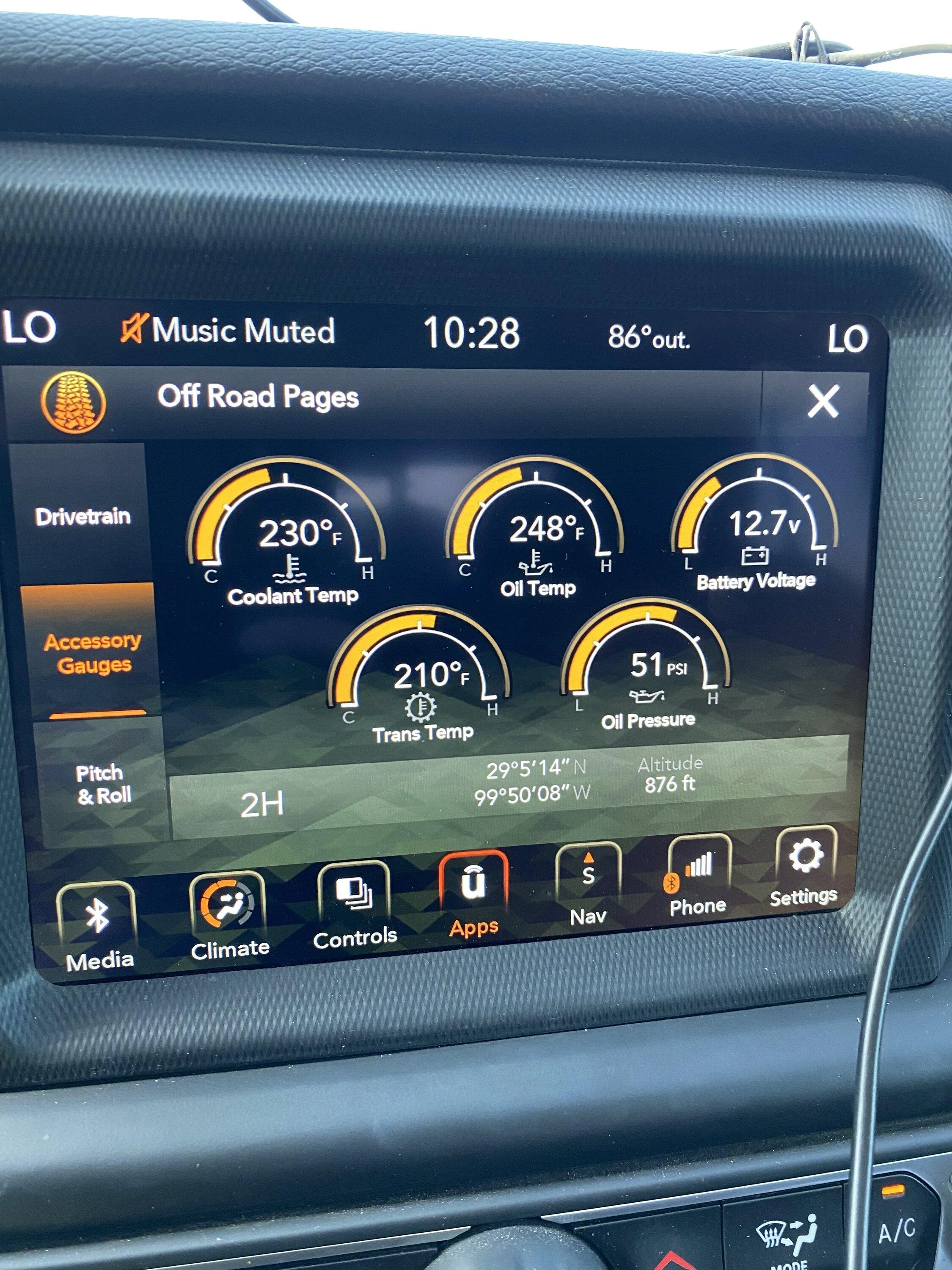

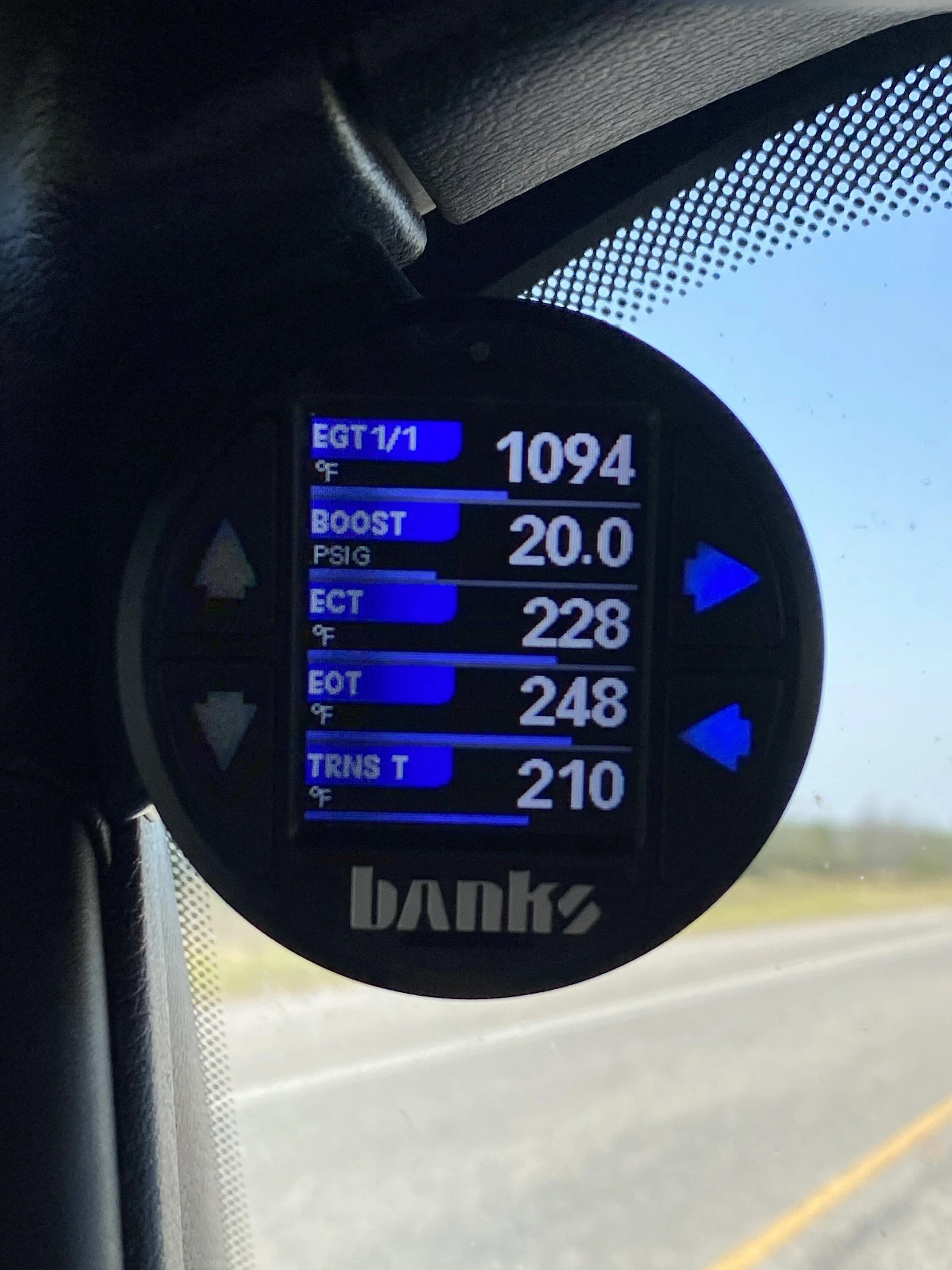

Made a few observations after having 4.56 gears installed. Previously rig had stock 3.73’s on same 35” tires and would pull just fine but did have more of a tendency for EGT and engine oil temps to creep up. I feel the lower ring and pinions help tremendously there being that now I have a bit more mechanical advantage. This is the first real towing trip I’ve made that was about 130 miles round trip from south of Uvalde to the Leakey TX area. Hill country, with plenty of decent ups and downs on the trek. Was running an average speed of 65 mph and my R-Pod 202 I’m guessing weighed in around 5800 lbs with full water tanks, camping gear, E bike, generator and extra fuel. Jeep also had a bed full of gear. Highest oil temp I saw was 252. Prior to the ring and pinion change I’d never pulled it with gear loaded and tanks full and could get oil temps over 260 without pushing it that hard. Not too scientific but what I observed. A lot of folks on here claimed they thought I went way too deep on gears for my tire size but I stand by the decision wholeheartedly especially after some towing time.
Sound like the gear change put it back to its "normal" efficiency range
Judging by the Squat, you have surpassed the maximum tongue weight, perhaps towing rate. In any case driving with the weight squatting the back like that is not safe by any means.
