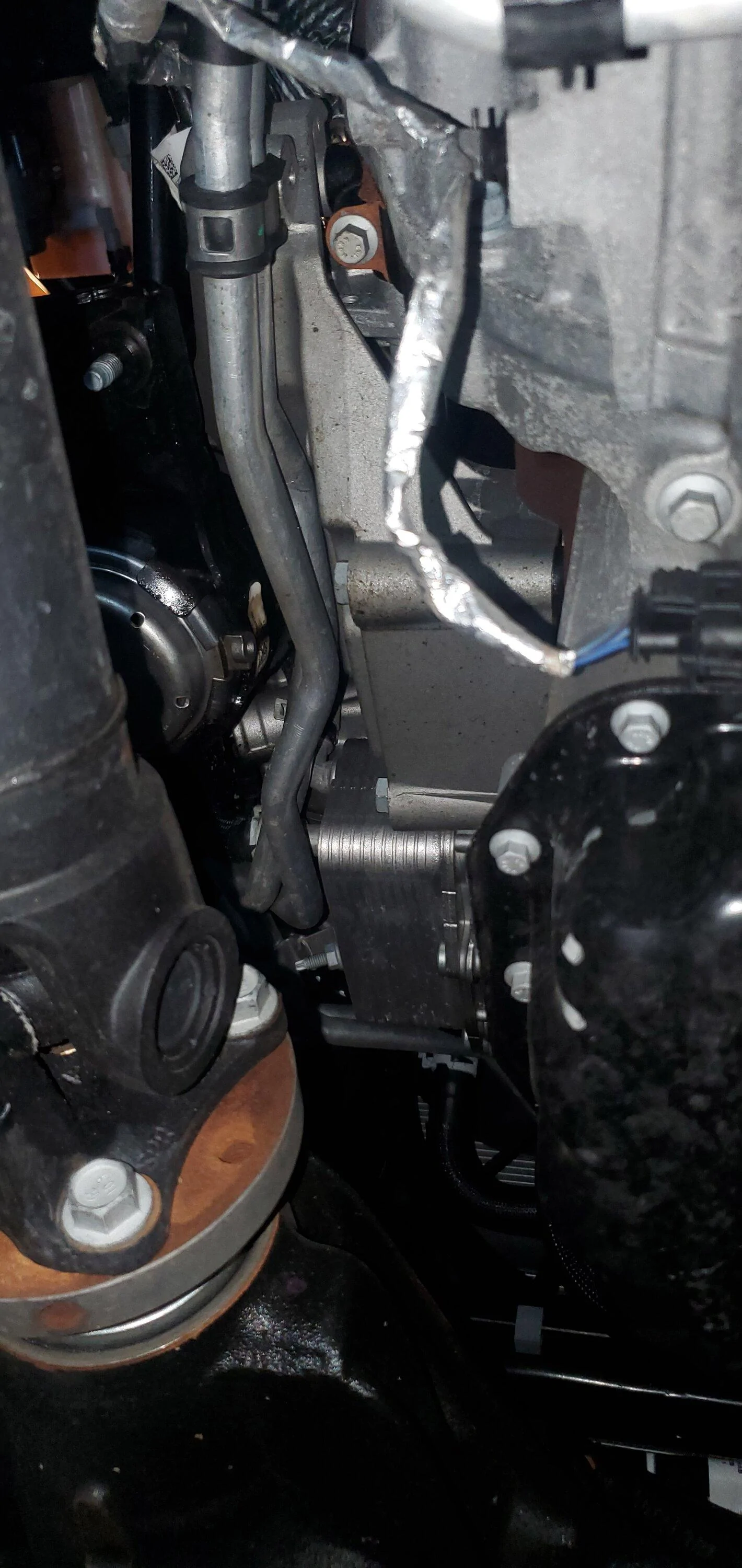

jeepin48
jeepin48
Jake
Sep 10, 2020
418
437
Michigan
JT Overland 3.0L
Engineer
Yall let me know when someone touches that thing. Lol looks tight in thete. Good idea though.

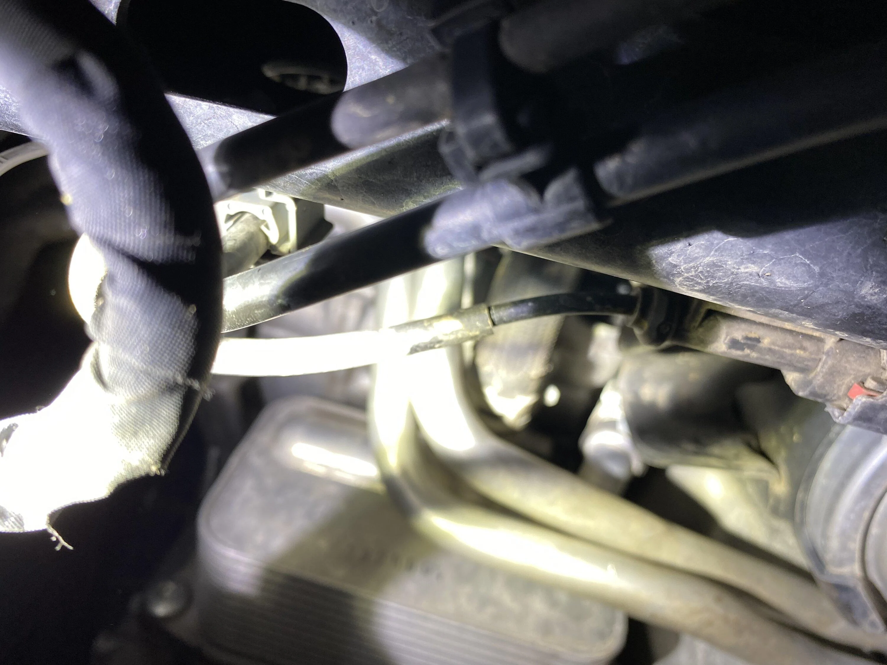

I have good line of sight to mine, sorry for the blurry pic.
Jeep Gladiator Diesel cooling options and ideas 021AEC03-CAB0-41BB-B234-C62EAB994FD6
Hondo1
Jul 18, 2021
63
59
2021 Gladiator Rubicon Ecodiesel
Oil and gas
It appears that the inlet is the nozzle is the one with the 90* turn, it’s comes directly from the block. The outlet goes around the back of the engine to what I’m guessing is the egr cooler (key word is guessing, I can’t actually see where the line terminates). Outside diameter of the hose is .930 so just a hair under an inch. This was measured on the hose over the barb of the outlet. I.D. Is probably 3/4”
