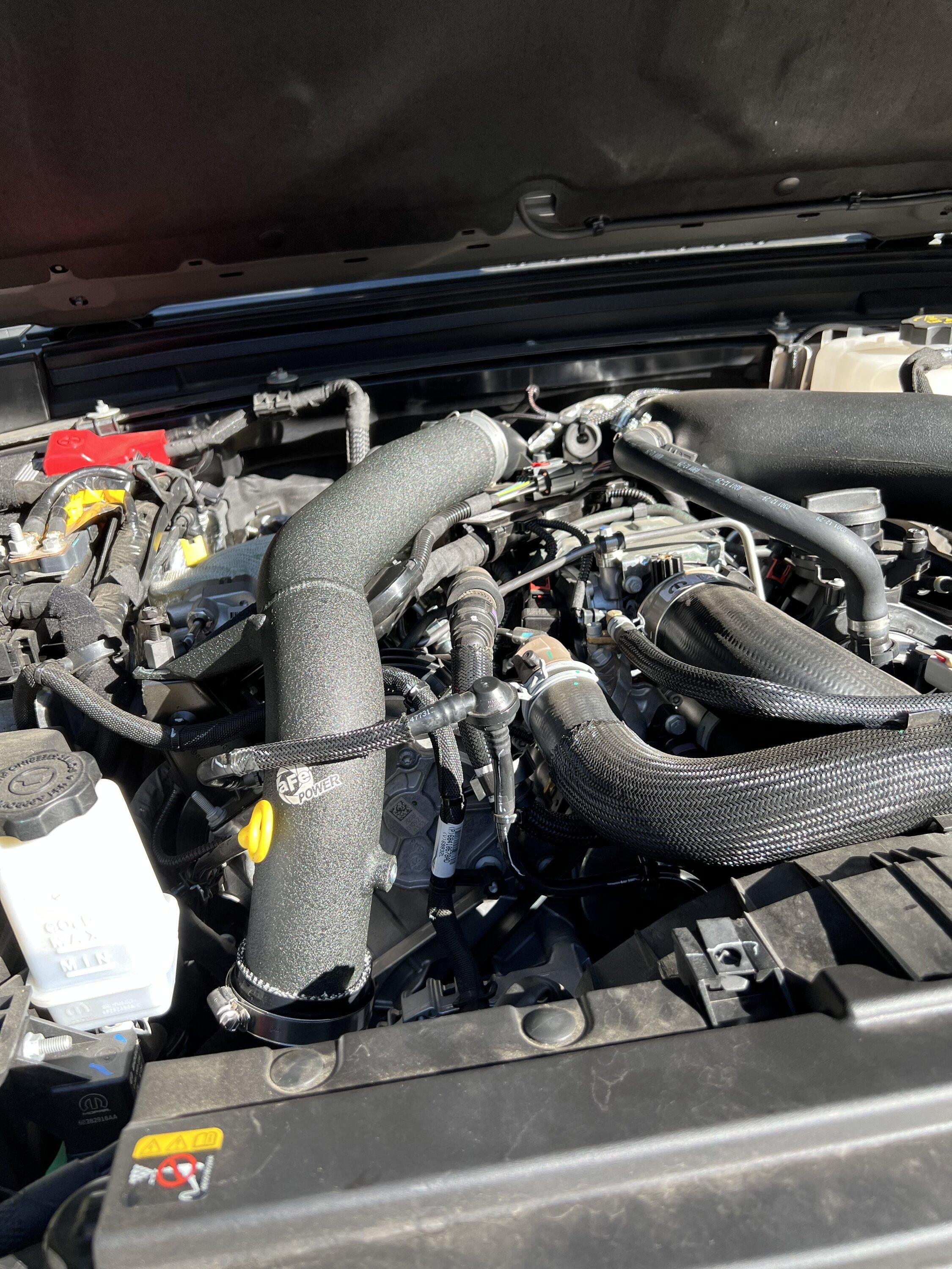

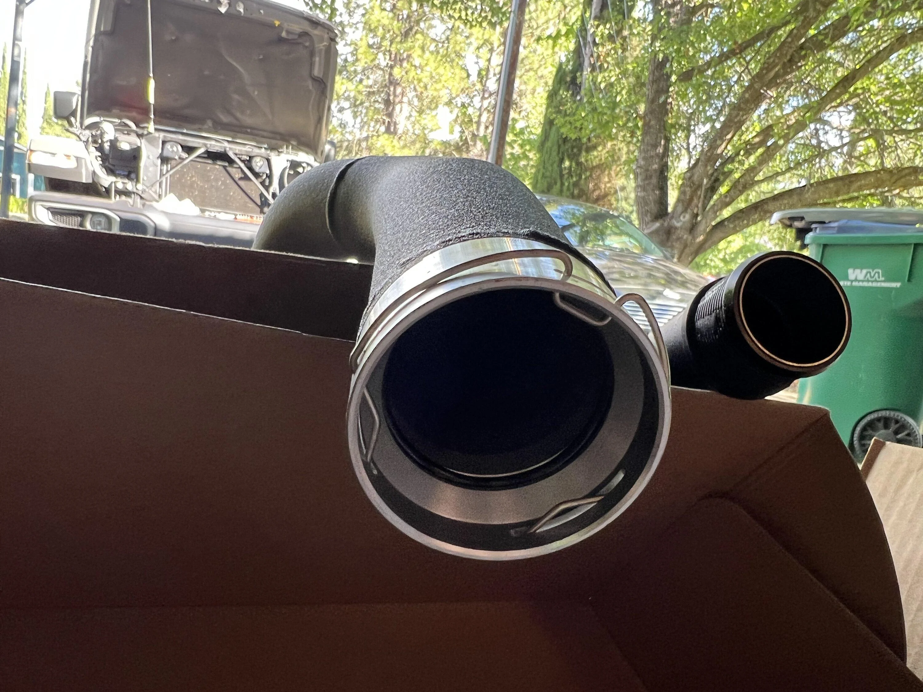

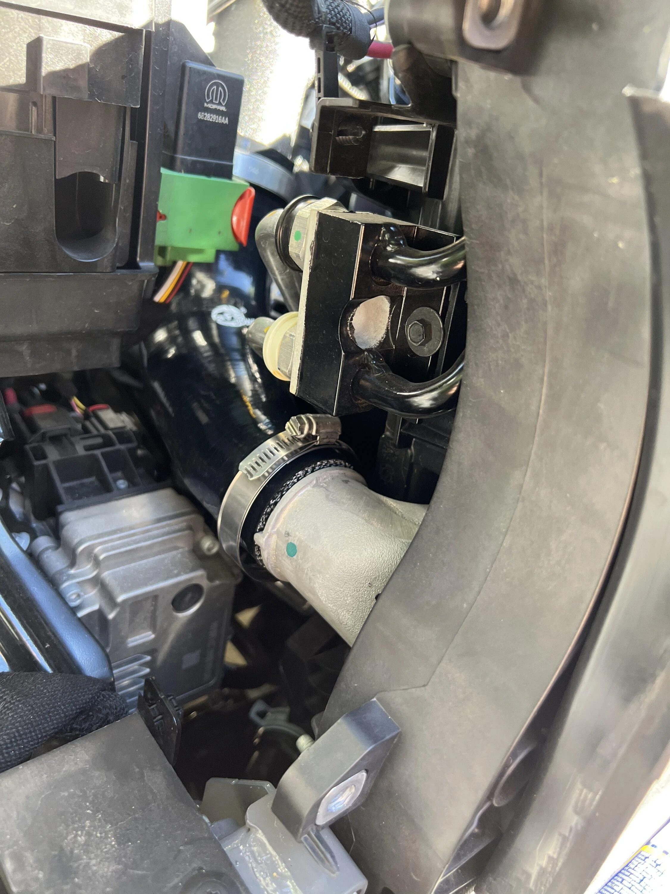

I have ordered the AFE Air intake tubes.
Why?
The NPT port. I will be testing water methanol injection using the NPT port as my injection point.
For testing ill probably use a digitally controlled SNOW kit and use the factory washer fluid resevoir. If there are any gains/temp changes I might use a larger resevoir.
Honestly I think I would set it to only spray over 27PSI which is basically 100% throttle so for passing or large hills.
