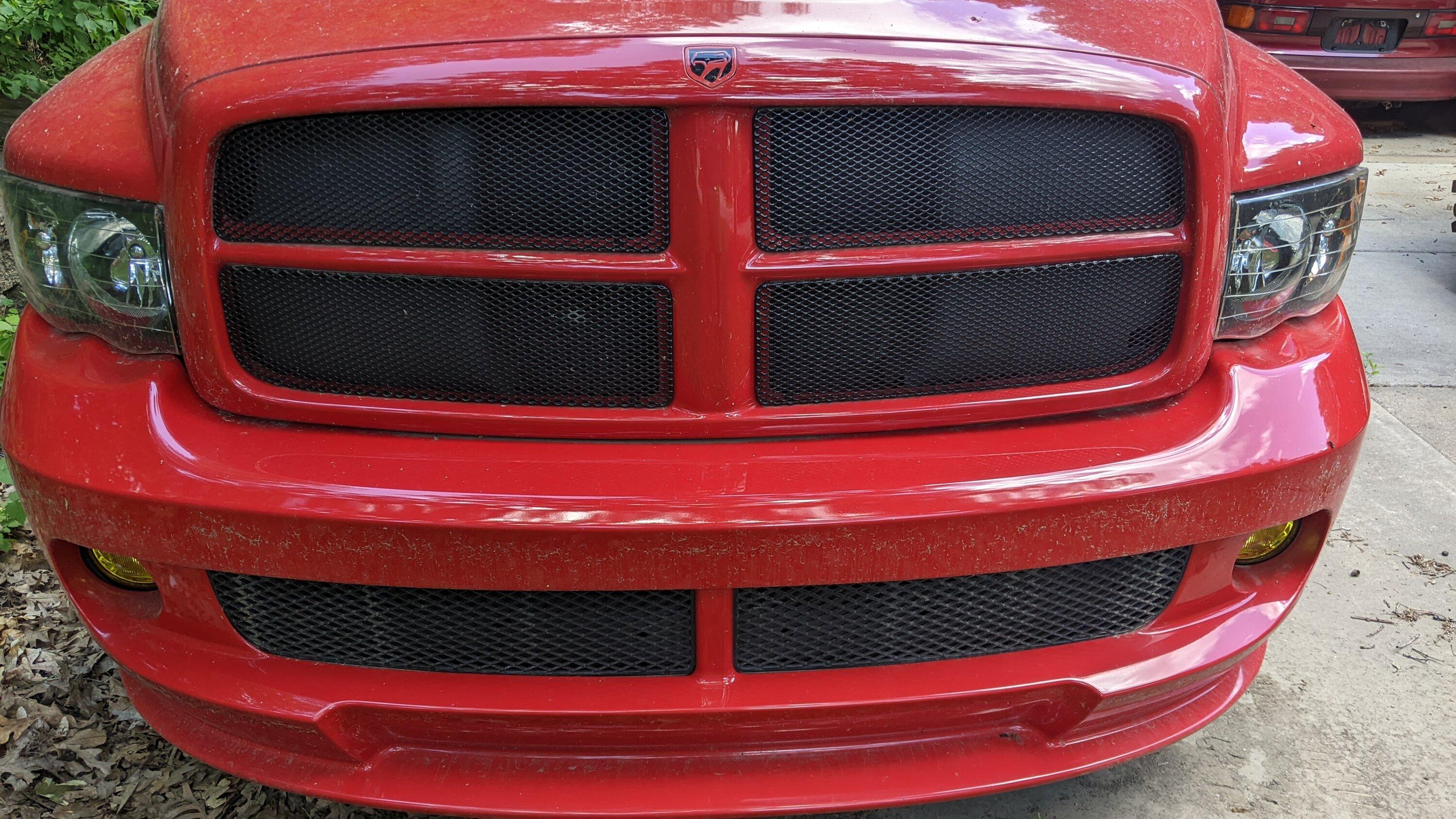

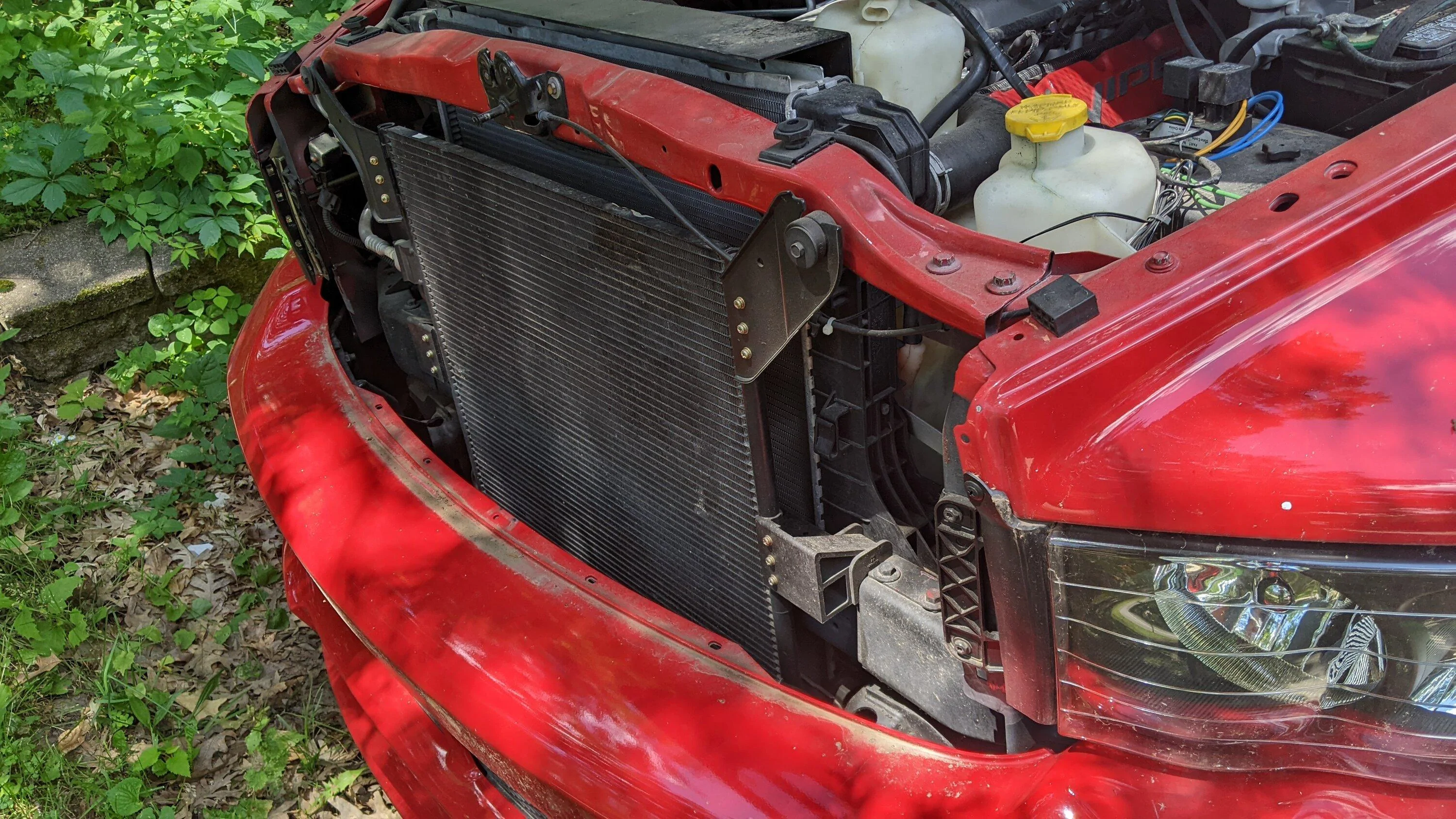

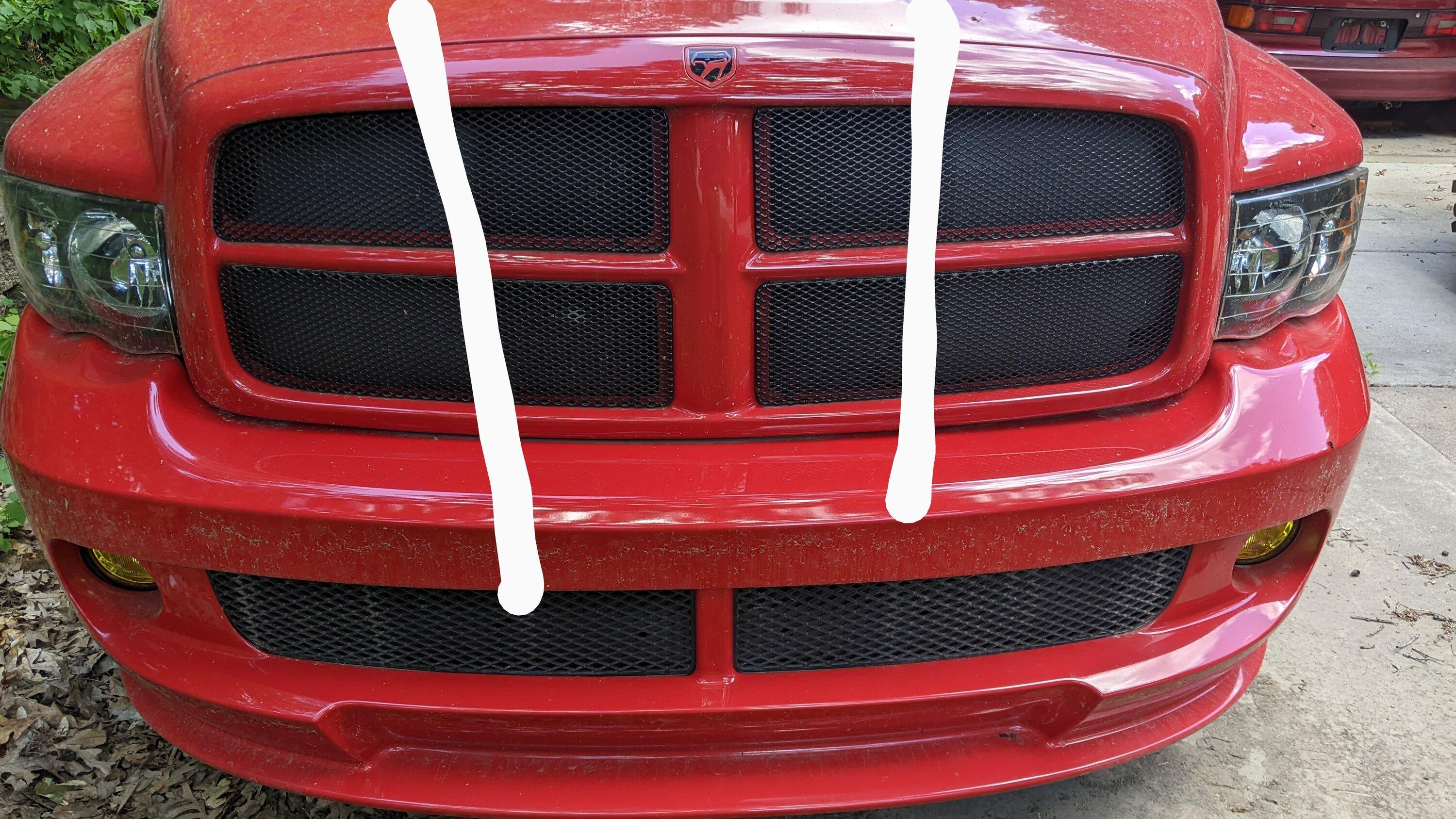

I know it's apples and oranges, gas vs diesel, but I've always been kind of surprised by how tight the ducting is at the front of my truck. Now I've never done extended track sessions but I've done autocross and repeated back to back runs at the drag strip, and even towing my wagoneer in 90°+ and high humidity, and it never gets above 215ish. Which is toasty, but controlled.
Just saying, despite my photoshopping, I agree frontal surface area isn't the primary issue in stock form.
The engineers involved in designing the JT have said that frontal area (“packaging”) was the biggest problem. Look how much taller the radiator on that Ram is, and it goes below the grille, getting air from the openings in the bumper, whereas the JT doesn’t have any openings in the bumper.
Sure, with their radiator limitations as being a factor as well. Everything is a factor in production. Kind of goes back to what I was saying two posts ago
