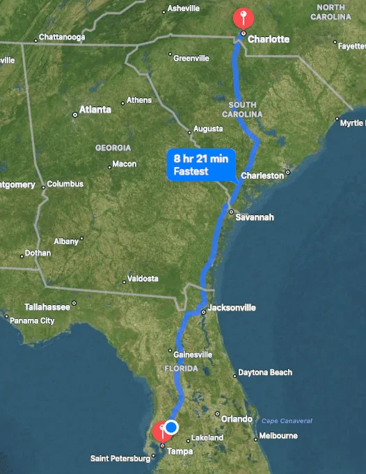

Forgot to post my recent towing experience. Recently moved due to wife's job offering her a promo to move to FL. Thankfully they did all the hard work, but wouldn't move any of my "toys". I have a 3000lb 20'x8.5" split axle enclosed cargo trailer, so I loaded up the safe and some other misc goodies like the toolbox they wouldn't take. Total weight was maybe 4500. MAYBE. Wind load is obviously high with the enclosed trailer, so I'm sure that made a difference as well. The trailer was not loaded heavy, it was basically empty to be completely honest. Though it was a little tongue heavy due to loading the gun safe a little too far forward.
Total drive from SC to FL was about 500 miles. Gladiator is on 35x12.5 Faulken MTs, but otherwise unmodified except for the SB hood scoops I bought after hearing about the diesel heat issues. Rubicon bumper, no lights or winch blocking air intake.
Route had some rolling hills early on in parts of SC, but was flat interstate driving after that. Route pictured below for reference.

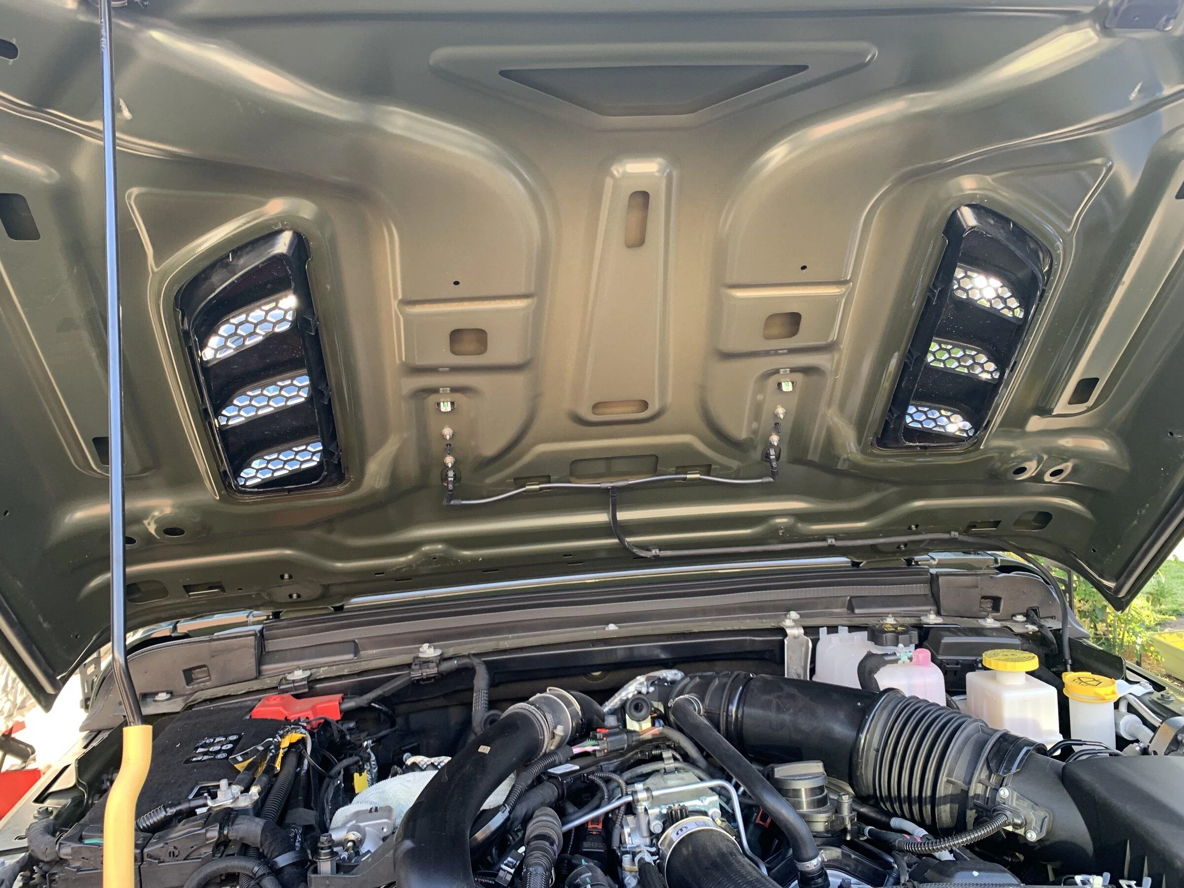

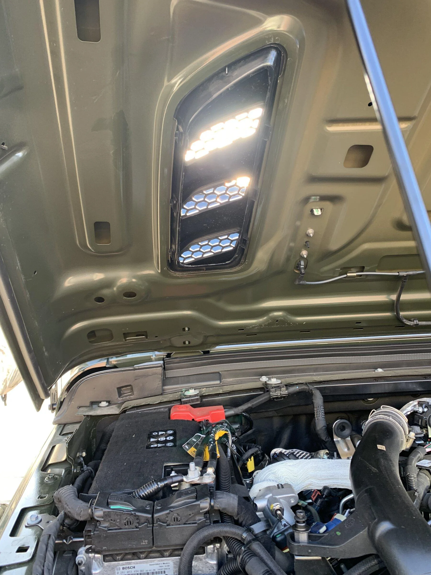

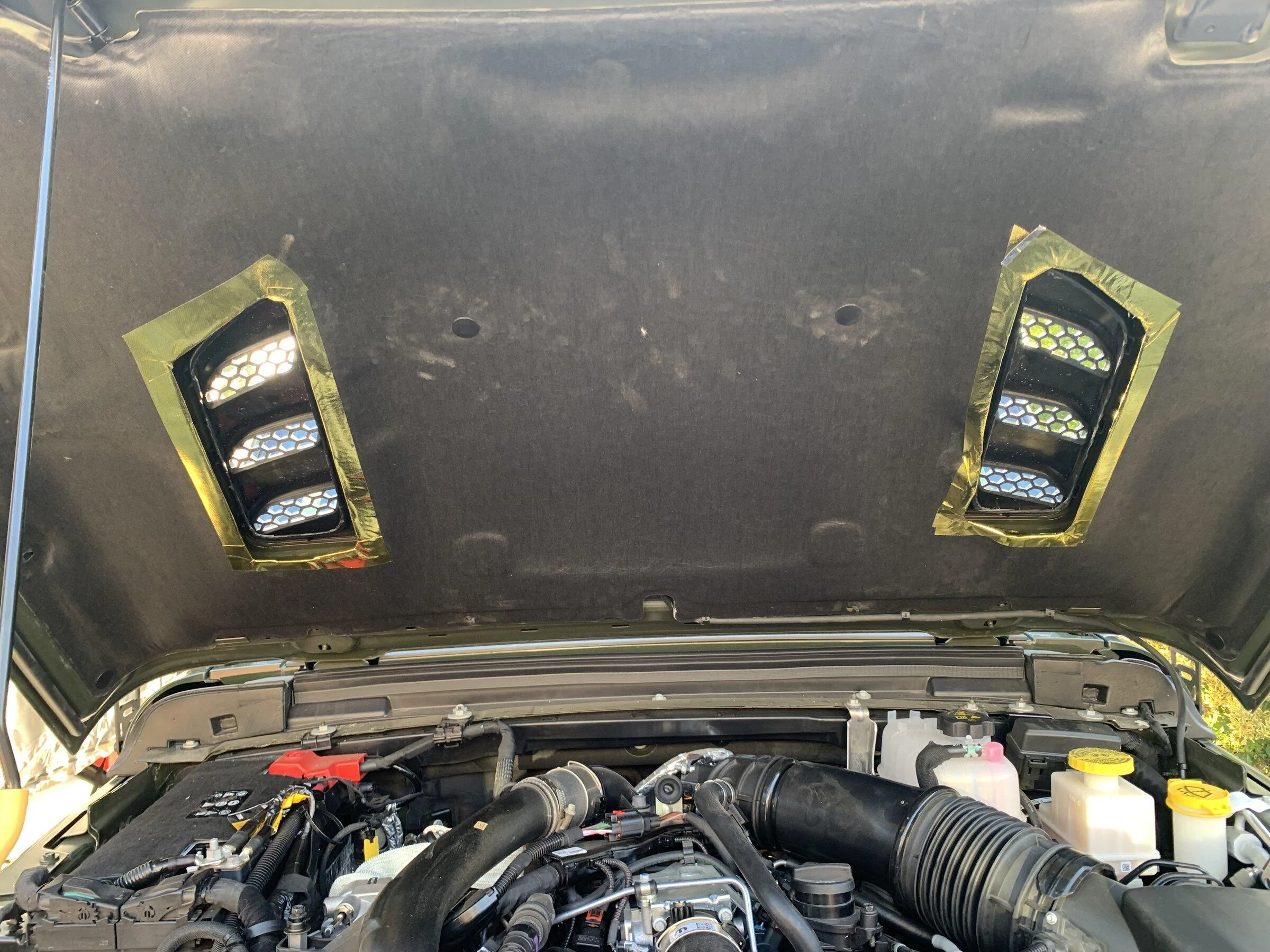

@rubicon4wheeler followed your lead and did the hood vents after work tonight. Very easy other than breaking a few clips. I already ordered a few before starting as I assumed my ham fisted approach would have that result. Had some gold tape left over from another project to keep the edges from fraying. As you said easy and free and should create a nice negative pressure flow.
Jeep Gladiator Diesel cooling options and ideas IMG_5219
Jeep Gladiator Diesel cooling options and ideas IMG_5221
Jeep Gladiator Diesel cooling options and ideas IMG_5222
