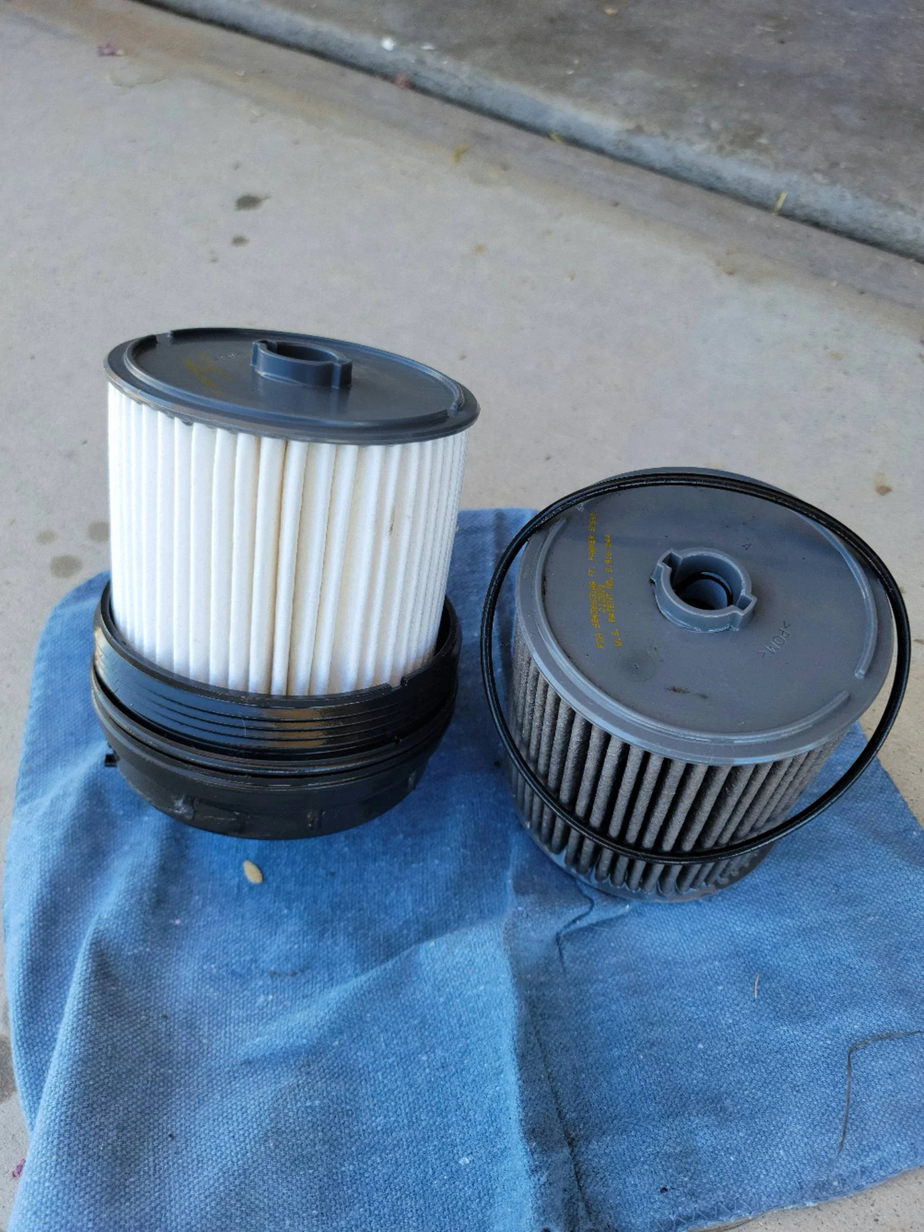

12234 miles and no issues so far. Started using Hot Shots EDT around the 8k mark. Changed fuel filter at 10k.
Wife 21 JLURD has 33k and didn't change fuel filter until 30k. lol
How did it look? I changed mine out a tad before 15K and it was fine and will be going to 20K next. It seems Mopar was pretty conservative with interval which is a good thing.
It was grey (and wet), but reasonable honestly.... depends on the fuel more than anything i suppose, otherwise it's hard to get dirt in to tank.... I wouldn't have an issue going to 20
