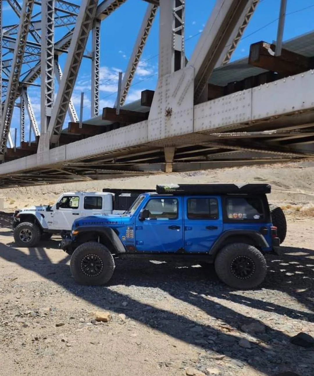

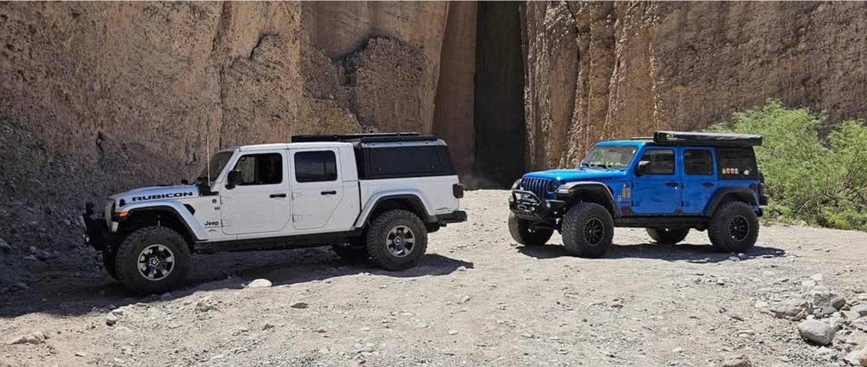

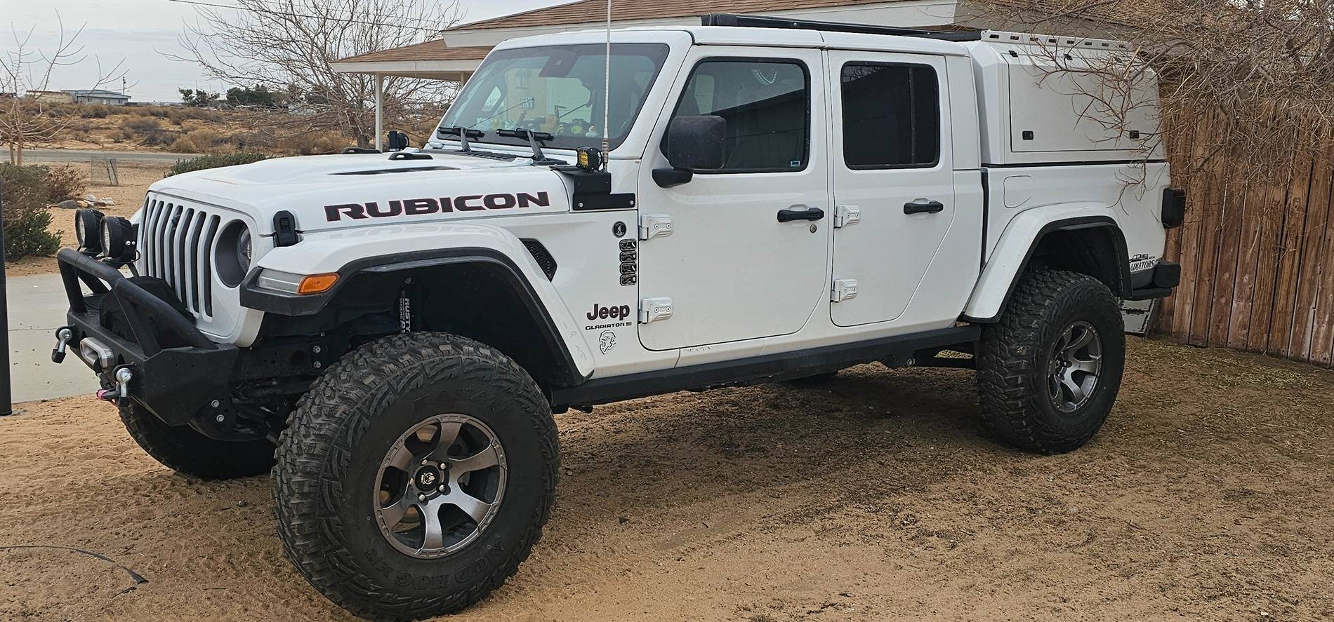

We have 2, hers is a 21 JLURD with like 76k No issues.... mine is 23 JTRD with 26k and no issues....
My 22 JTRD was bought back by jeep for the HPFP issue
All 3 were ordered new and been all over, she has 14 BOH's to include doing the Rubicon and MOAB
What brand/size lift and tires do you have on the JT? Looks good!
I used a full RUSTY's 4" and I love it, super quality and value for the money....
That said if I had to do it again, I would not use the Rustys shocks and put that money towards form Falcons for something
