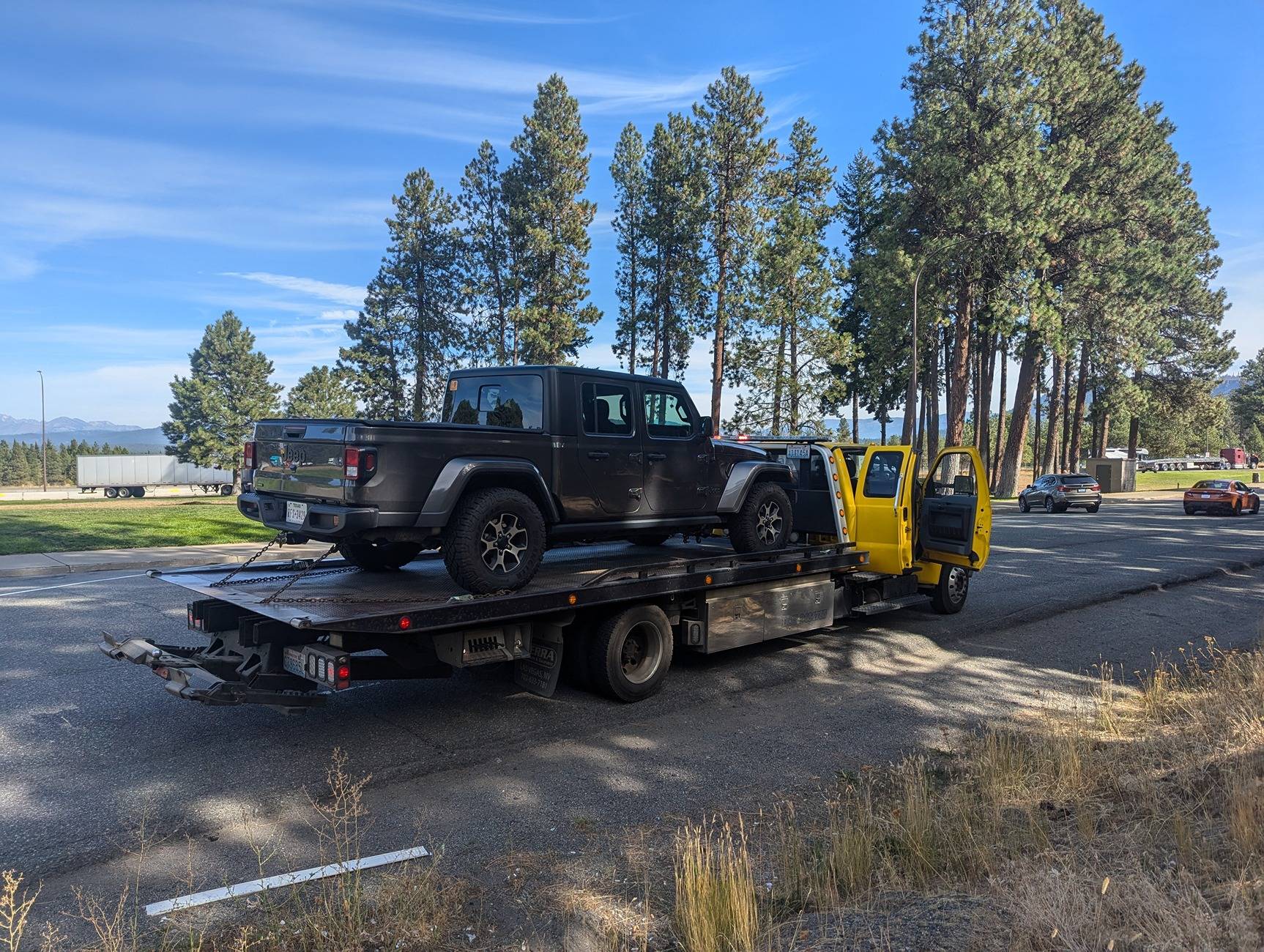

45k miles on my 22 JTD and no issues...wait what's that sound?
Oil pump failure led to camshaft bearing failure supposedly. Currently at the dealership saying full engine replacement required. Also saying I'll have it back in a week, cross your fingers boys.
