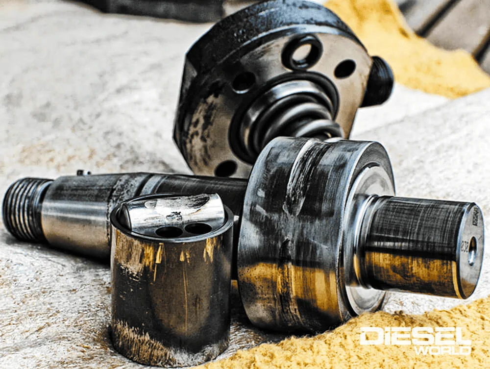

https://www.dieselworldmag.com/diesel-technology/cp4-2-fuel-pump/
This is likely the best article out there I have seen that shows the breakdown, parts, failure mode. This image tells the full story.
Jeep Gladiator DIESEL ONLY: How long has your fuel pump lasted? 1670001240510
Having anything that helps the piston / roller always stay in contact with the cam is important. Fuel Lube + no air in the fuel is key.
The thing that drives me crazy is the design of this diesel pump is to puke metal savings directly to the pressure rails.
It's obviously not a life long part.... Ensure that a failure doesn't result in additional component damage! I really wish we had a bypass kit available.
I'd much rather drop and clean the tank vs replacing injectors, lines, etc.
