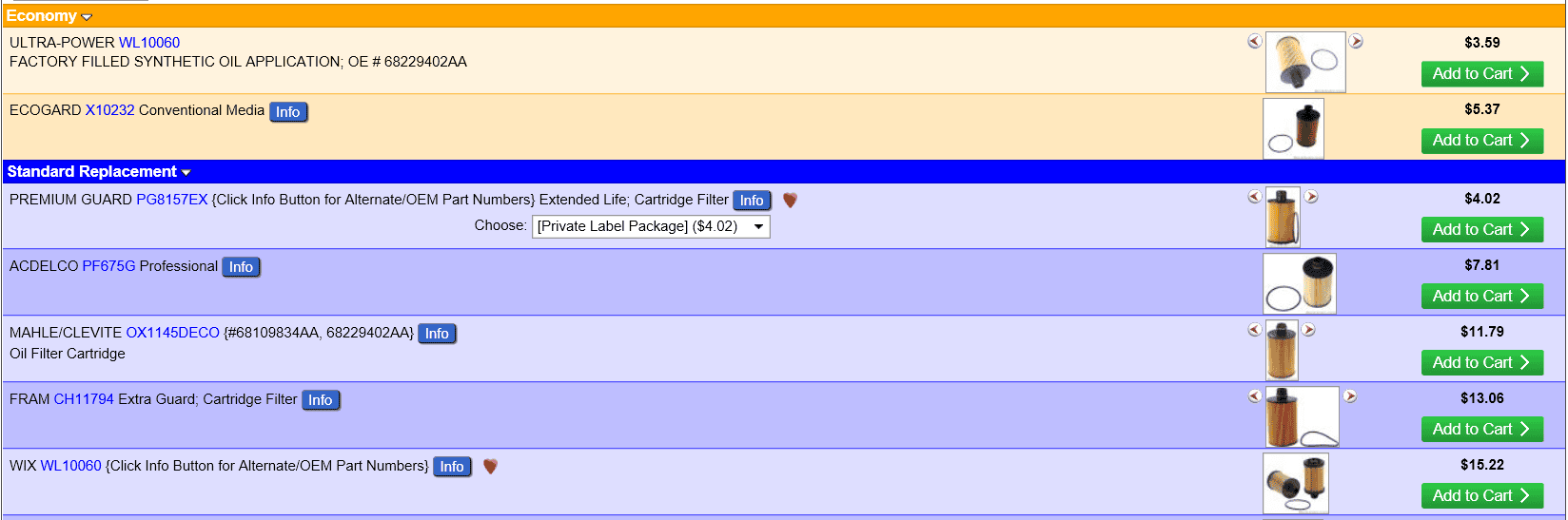

1. Oil changes - Mopar coupons don’t apply and they charge a premium for the filter
If you do your own maint. this is a non-issue. My 3.0 uses 2 gallons of oil. Not sure what you mean about filter prices - see pic below directly off of RockAuto I usually get the AC Delco one.
