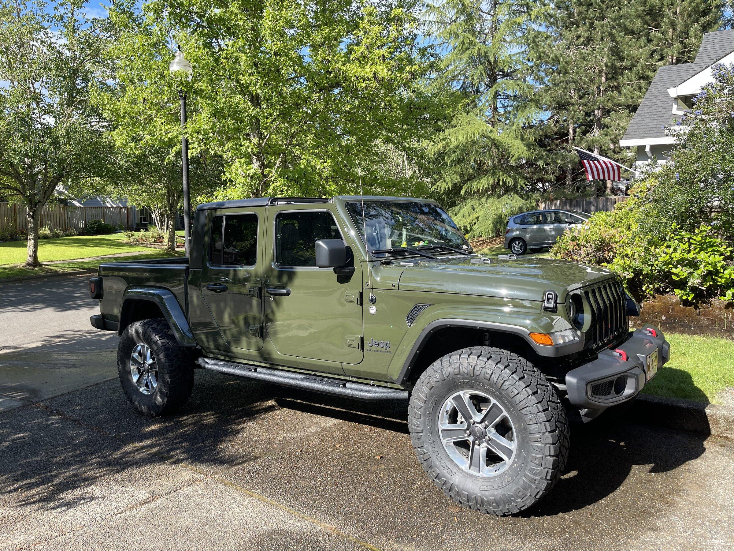

Traded my 2020 Max Tow for a 2022 diesel. I am thrilled with the diesel! Powerful, and gets great fuel economy. I’m running Mopar lift and 37s and getting 24mpg in town.
Jeep Gladiator Eco diesel or 3.6 gas?? B2579D87-3C2F-41C3-B481-005C9150D1DA
