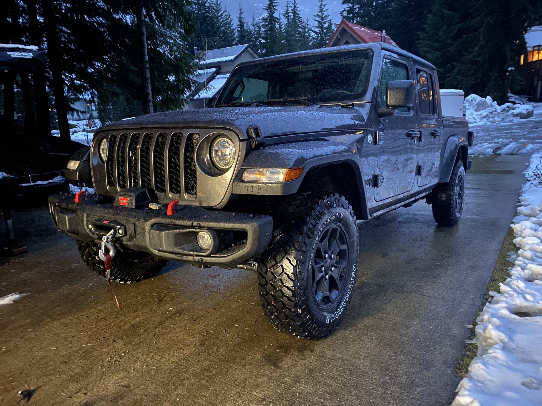

Running Willys 32ā€ stock with the 1.5ā€ front and Rubicon shocks. Might pull the 1ā€ strike pad as I dont want to go higher or 35ā€ tires again. Did that on my 20’ sport and it was way overkill for what I do.
yeah with the stock fox shocks you can do that... If you are running the fox 3.0 with the lift kit you can't pull the strike pad, even if you are running smaller tires. I measured and the fox shocks are longer and need that space to prevent the shocks from bottoming out.
Yeah ok, might do that today. I dont have shock extensions so I believe I should be OK as well. Might look into Falcon 3.1 so2 so I can stiffen up the shocks if needed.
frustrating as its a brand new jeep and I cant maintain any speed on an fSR without slamming into the bump stops. Crazy. Again zero issues on my 3.6 gasser previous. Come on Jeep!
